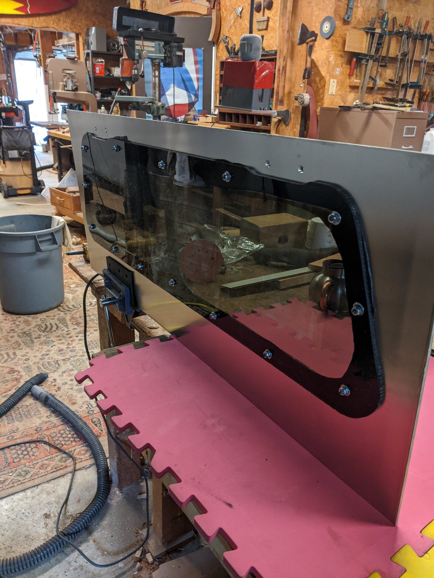

Hard top is finally close to done. Many annoying hours of drilling and tapping and rubber mallets.
Used plexi for the back window. It's not my favorite product but whatever.
If you're making something out of it, never never never never use a regular drill bit. Step drills work ok, or you can put a weird point on a regular one like this. Setting your drill clutch at it's weakest can save you some grief too.
