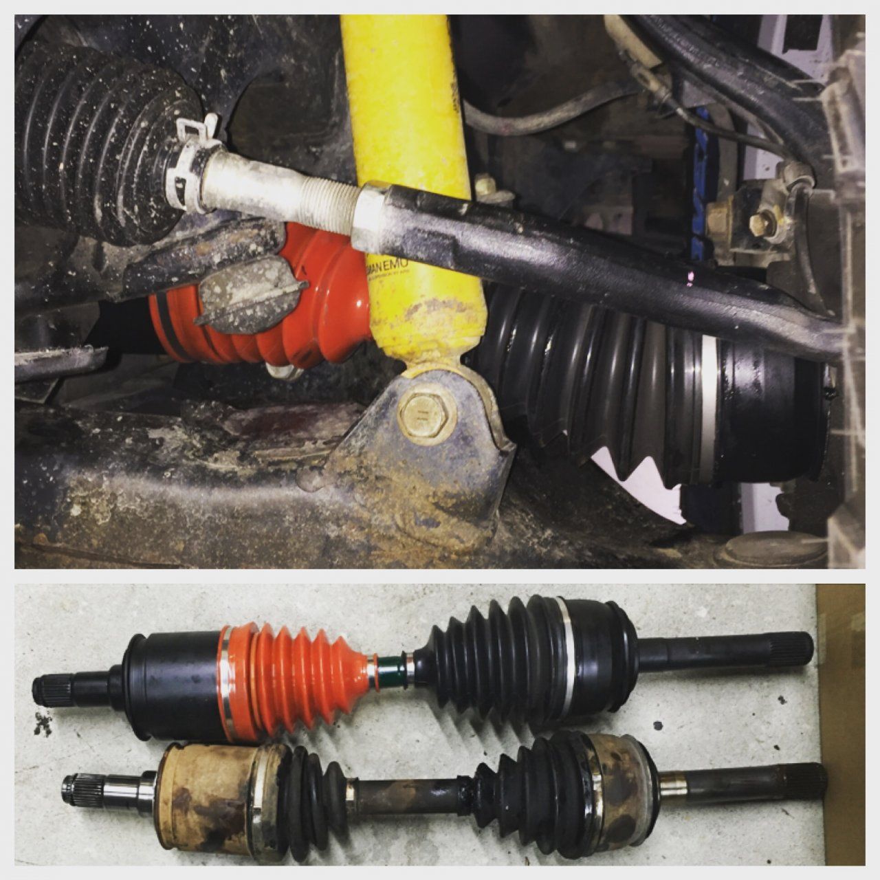

True, thats about the cost. I went through my mechanic/parts house (mark up) plus I got red "Porsche" boots (heavy duty/$50ea) on the the inners because of the 'extreme' angles... Even the standard boot in black on the outer looks longer than OEMView attachment 1269324
I'm curious what is the black on the axle?

Don't have part numbers. I only asked for a heavy duty inner boot (red), the outer (black) is just what they used when rebuilding.
@2001LC - Not sure I understand the question. It's some sort of coating, I guess.
The coating looks like paint in picture, which I'd not be wild about on axles. I can understand CVJ not wanting newly cleaned parts to rust, but paint on axle!

They look the same. Not if that is what CVJ used or not.
As for holding up, looks like there is a pin hole that is leaking at the bottom of boot...going to take it this week and see what the story is.

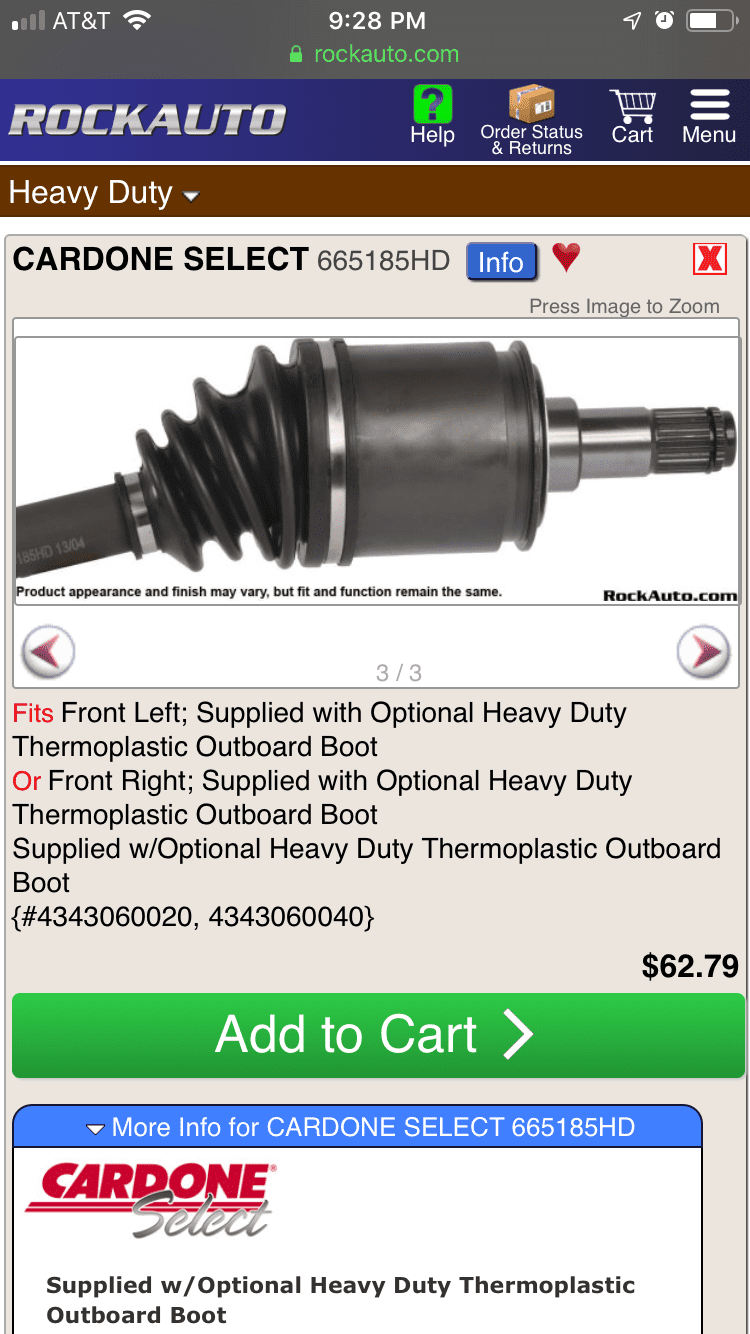

Anyone using these Cardone axels? Limited Lifetime warranty.
Last time I was at dealer they mentioned i needed new front axels and quoted me $1,100
RockAuto
Cardone Heavy Duty
The Cardone are new Chinese axles. I have tried several sets of the WorldPart ones, they are great for the first couple months, then they start knocking and vibrating and making all sorts of wonderful noises. This is one area that I would go new OEM if you can afford or just reboot used and hopefully you have decent splines.
Yeah I have no desire to replace OEM Japanese quality with Chinese quality.
