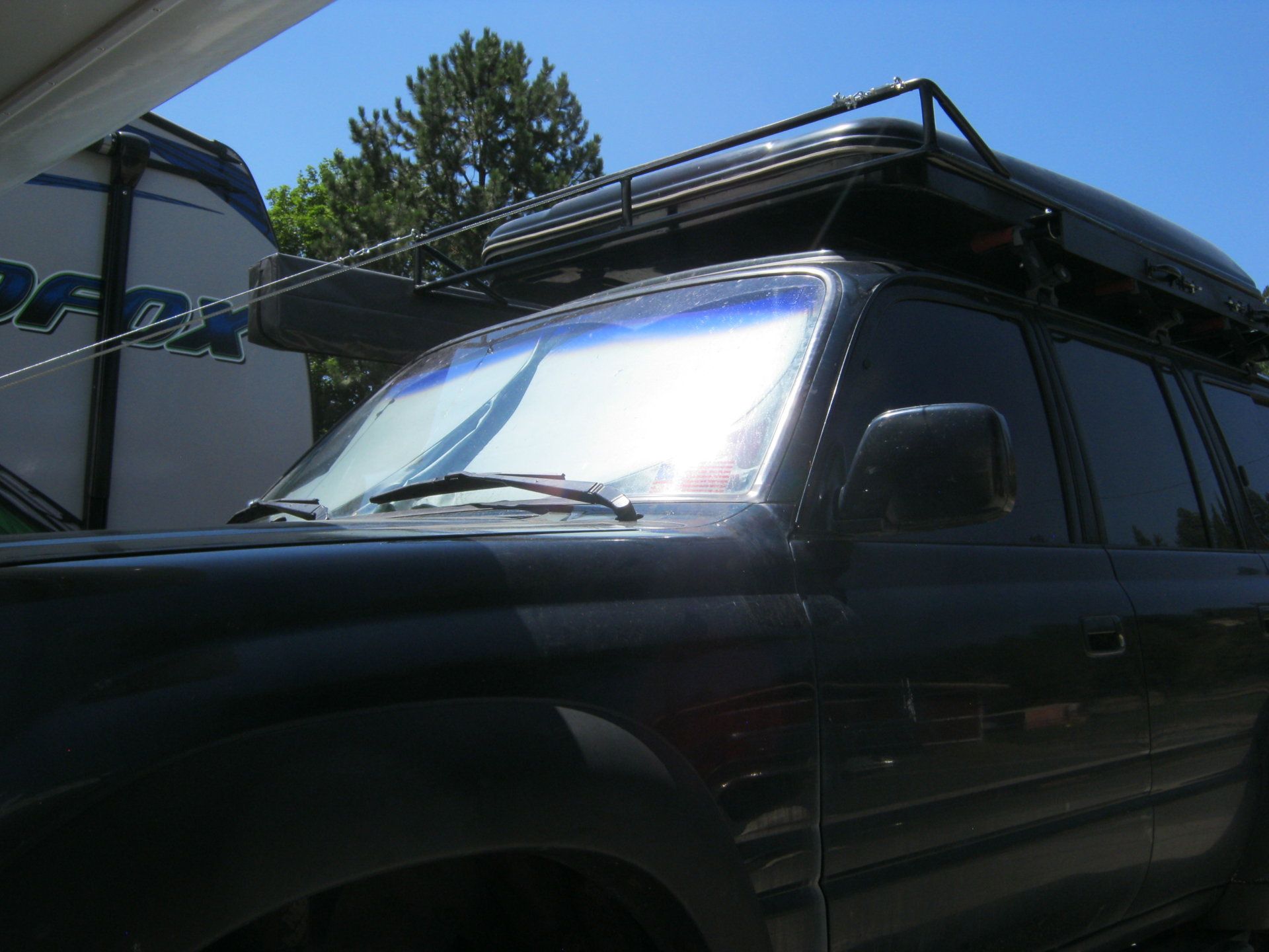

You may find that you have difficulty when attaching things to your custom low profile roof rack. You're not going to have much, if any access to hardware on the bottomside of the rack. I have done some serious mods to my Yakima rack system on my 80 series. Currently running a CVT RTT and a Alu-Cab Shadow Awn. Here's latest pic I have with all mods visable. Poor pic, but shows front extension, RTT & awning:
More detailed pics can be provided if you want.

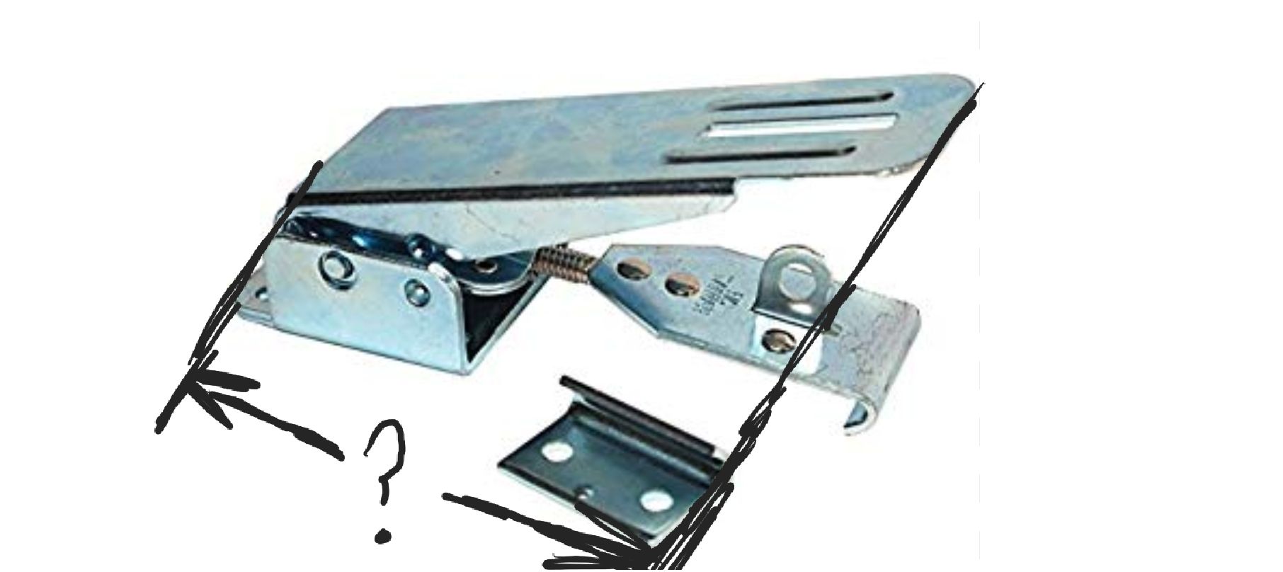

Did you ever resolve the latch handle to door contact?
I'm trying to find some type of budget latch myself. I can't pay $150 for traditional type latches.
My L bracket will be 4.25" tall looking to fit something in there.
Will you get a total height measurement for me?
Pictured is a E313 from RV Design
bent mine on the front 3 latches to clear the doors. May cut them later, but not that board yet. i'll get you the height when i get home tonight. the measurement you are looking for below is 4", but the mount on top of the latch adds length. it also depends on how far out you unscrew the clip that will go to the rain gutter. you have some level of adjustment on height within that screw. I would say total length is no more than 4.5". i'll get some pics too
