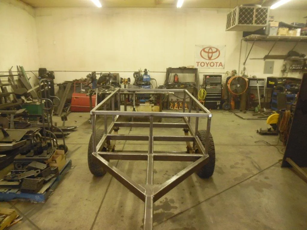

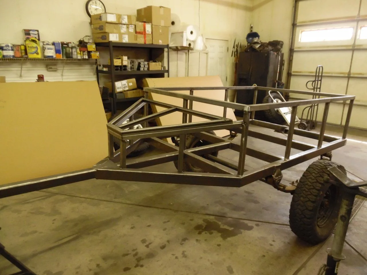

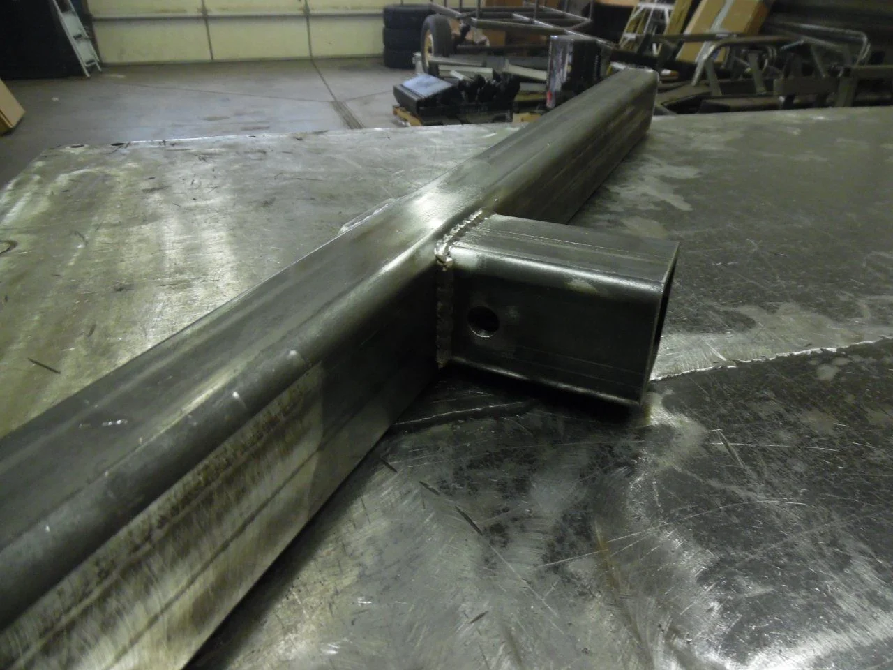

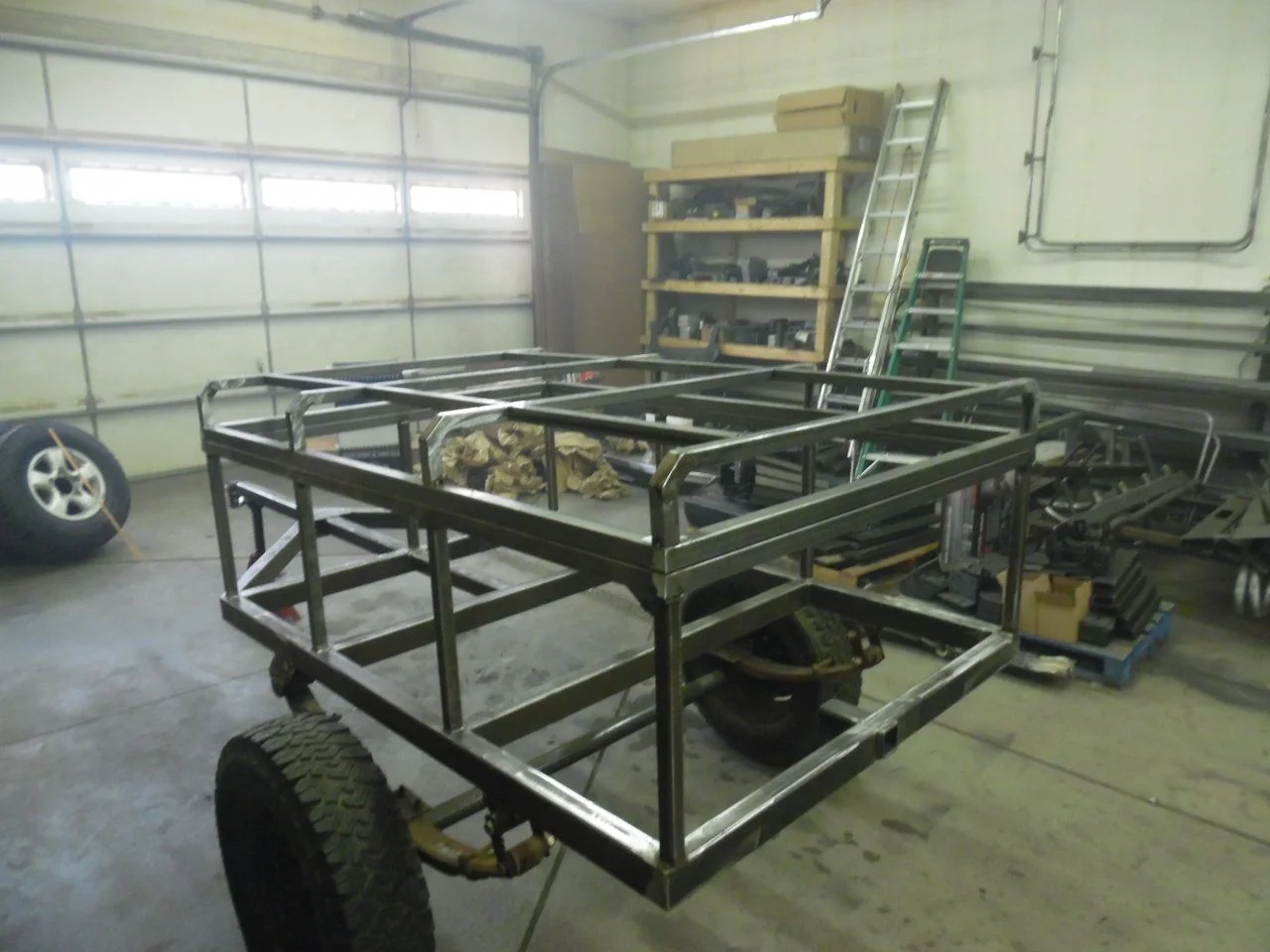

Had a little time this morning so I knocked out the new rear crossmember and leveled off the vertical runners.

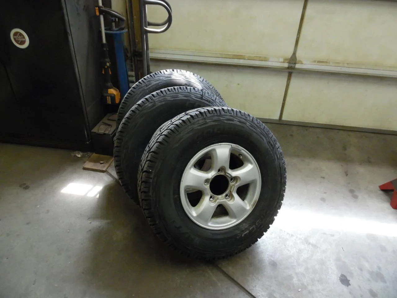

I found 5 x 150 hubs with and without brakes, but lead time is 2-3 MONTHS. I will stock these once I get moved. But for now... this was the best solution.
I recommend the 5 x 5 as that is what the new JK Jeep and a few others are. This way if you ever want to sell the trailer you can open it up to a whole other market of guys.

Also matching wheels and hubs, if really needed, you have extra spares to get you to shop, you can always go back for the trailer
