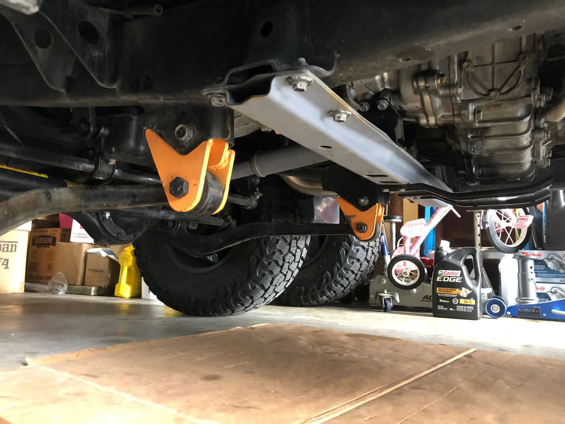

The person who selling that bracket is my Friend. That bracket is ok to use, as I’m from that region, I suggest using that bracket u have to be really aware of rock climbing as most of the areas in America has rock. As a Malaysian ex-competitor in 4wd challenge expierence . I highly suggest the custom made radius arm. But if ur not doing hardcore off-roading like mild route. The bracket will work.

I tried to email them last month, they are moving their shop to a bigger area. They will start making on this summer. Because of this reason, I bought a pair of drop brackets from malaysia . Drop brackets are cheaper for sure. With That application u just try not to use it for rock climbing. But if it is just regular overlanding and off-road. That bracket will suit the purpose need.

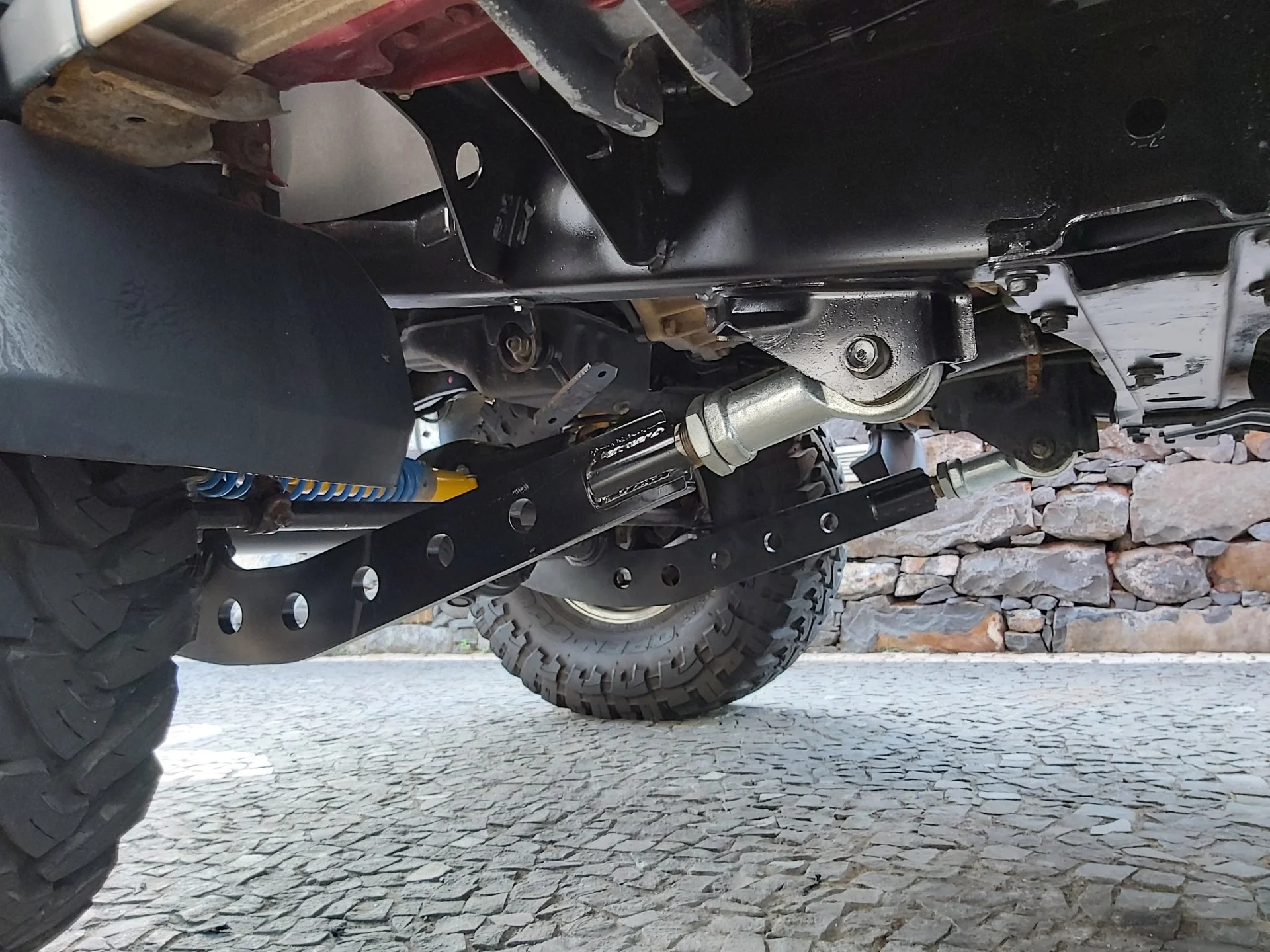

I mounted on my kzj70 some front arms that seem good to me, Recambios suspension-direccion 4x4 - Toyota landcruiser-(serie-70) kzj70-3.0td-diesel-1993->1996 - - suspension-y-direccion-mejora-rendimiento - suspension-tirante-de-puente-para-vehiculo-elevado - https://www.euro4x4parts.com/es/recambios/catalogo-especifico/toyota-landcruiser-serie-70-kzj70-3-0td-diesel-1993-1996/suspension-direccion/suspension-y-direccion-mejora-rendimiento/suspension-tirante-de-puente-para-vehiculo-elevado they seem the same ones that raptor4x4 sells, I improve the articulation and handling of the toyota,

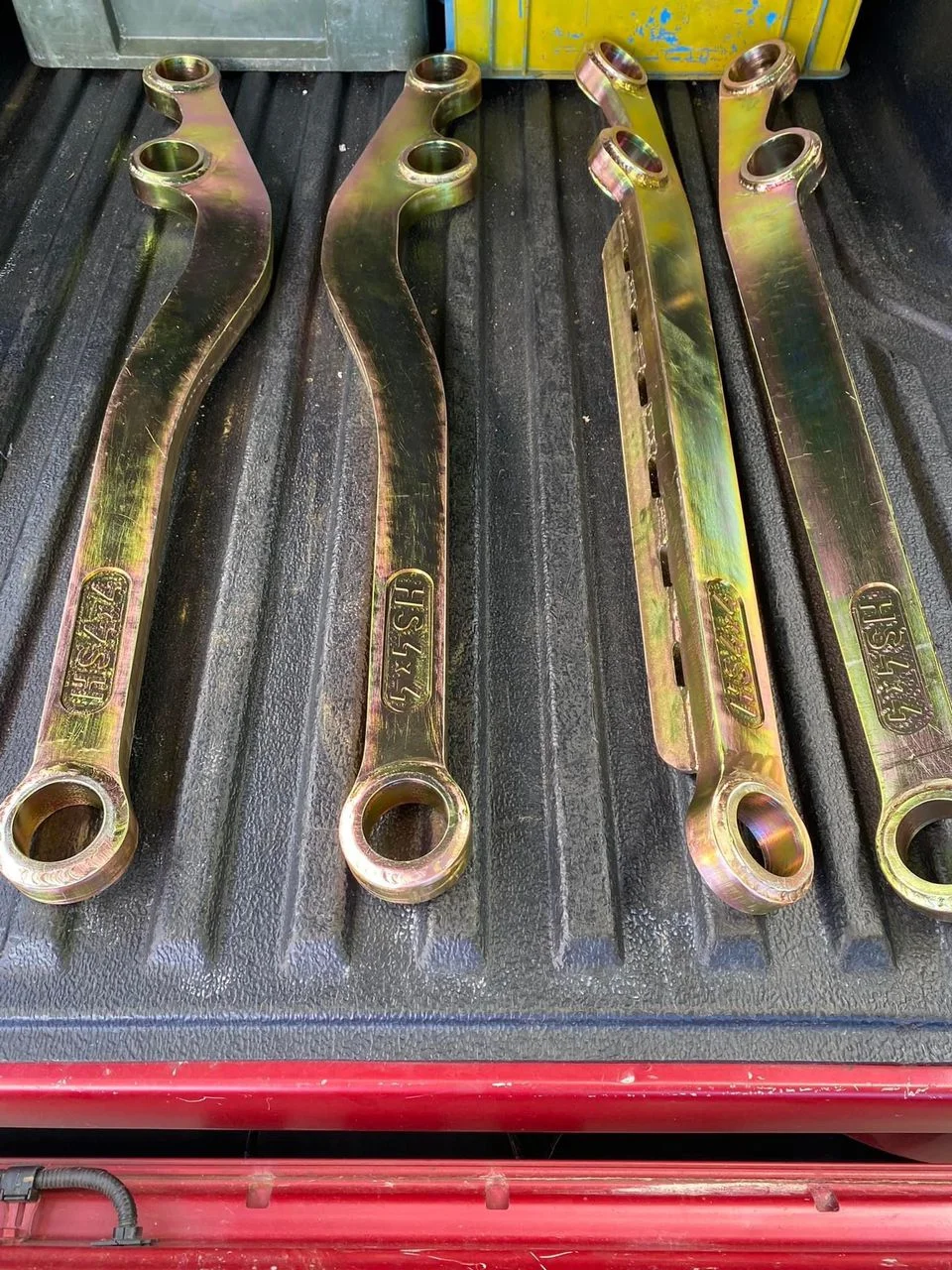

Thanks for the pictures @divemedic. Also, thanks for the offer of development @Delta VS . Not sure at this time there would be enough market to justify the product though....
OK, one thing I did find is a picture of an 80 series arm over a LJ78 arm. Looks to me like the 80 arm might be an upgrade for an LJ7x/KZJ7x (based on the angle). Length looks the same, but I'm not sure. I'm going to see if I can find a couple and try them out!

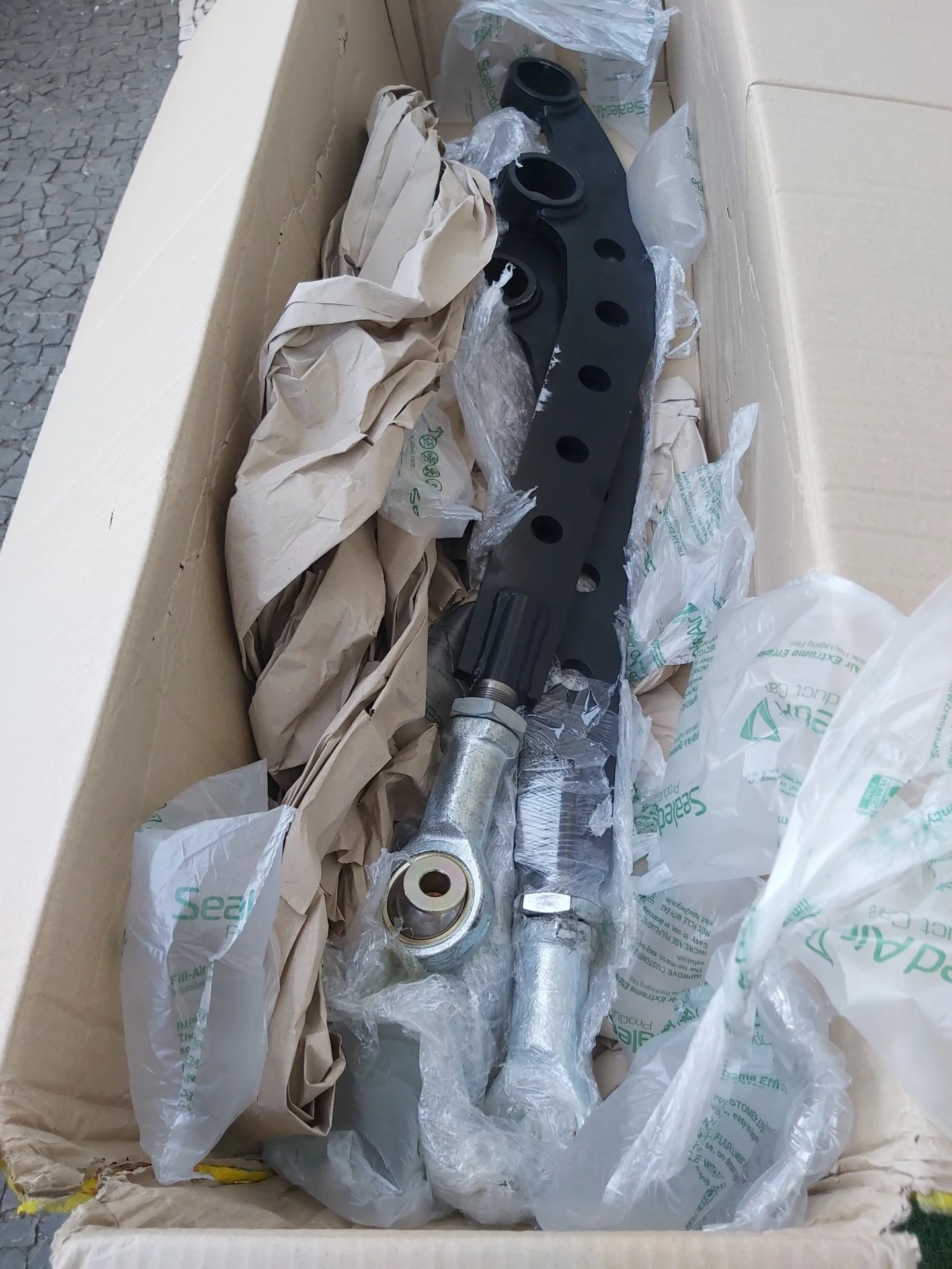

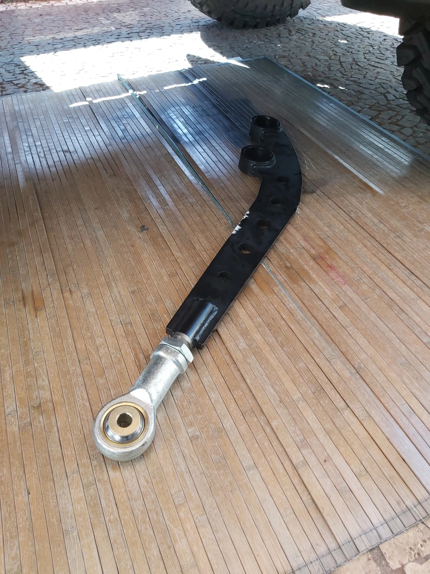

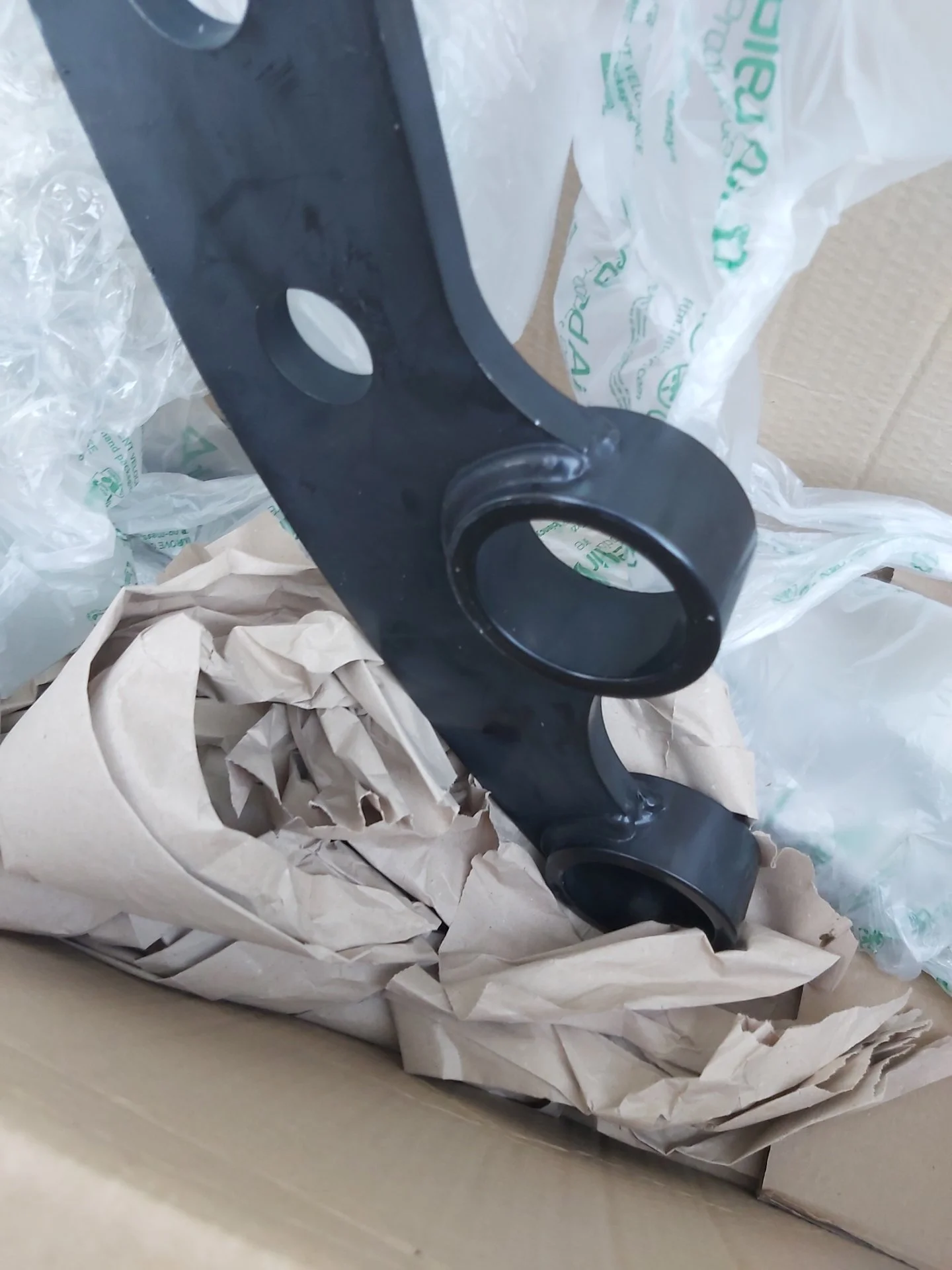

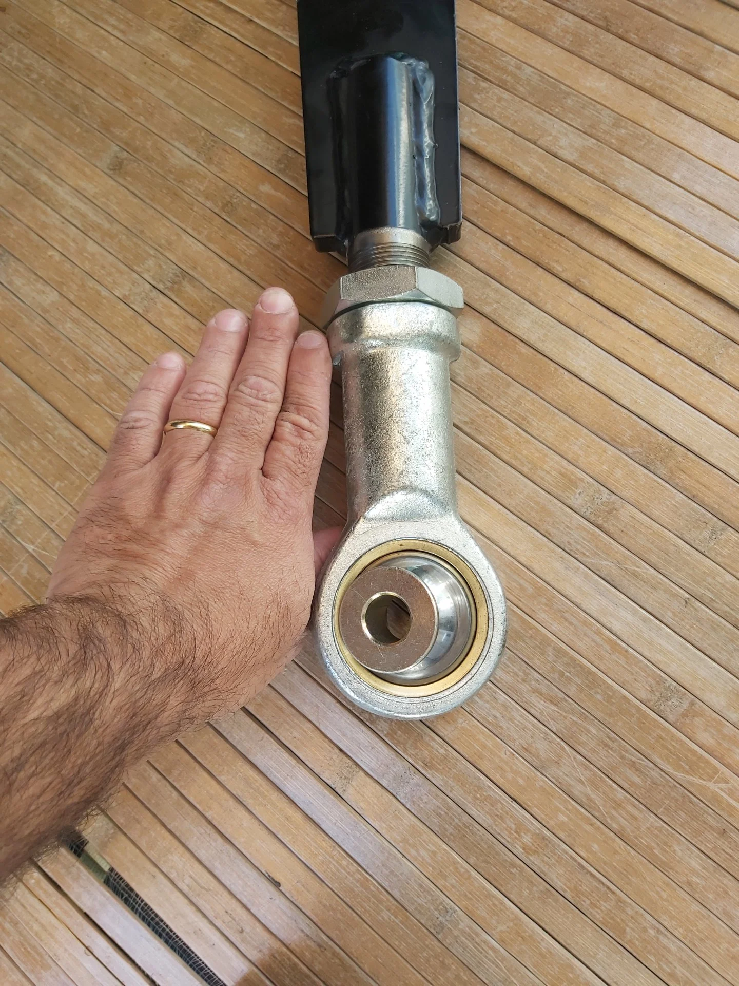

I think I’m going to order one pair, it cost about $1200 usd include shipping. In america it is hard to find some one to make one. And it is expensive as well.
Below is the picture of the custom radius arms , suit for 3-4 in lift for box prado.
Where can these be ordered from? Looks like front and rear can be purchased? I like them
