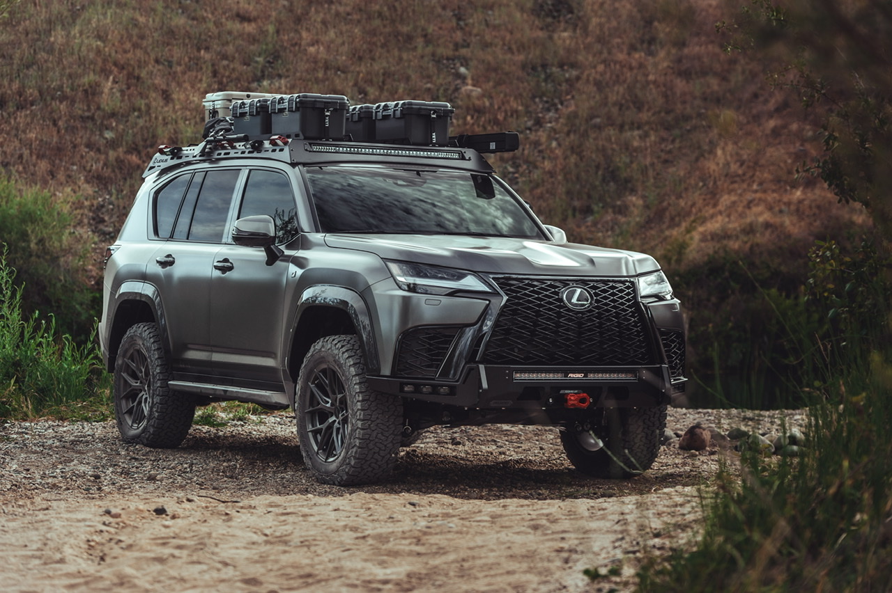

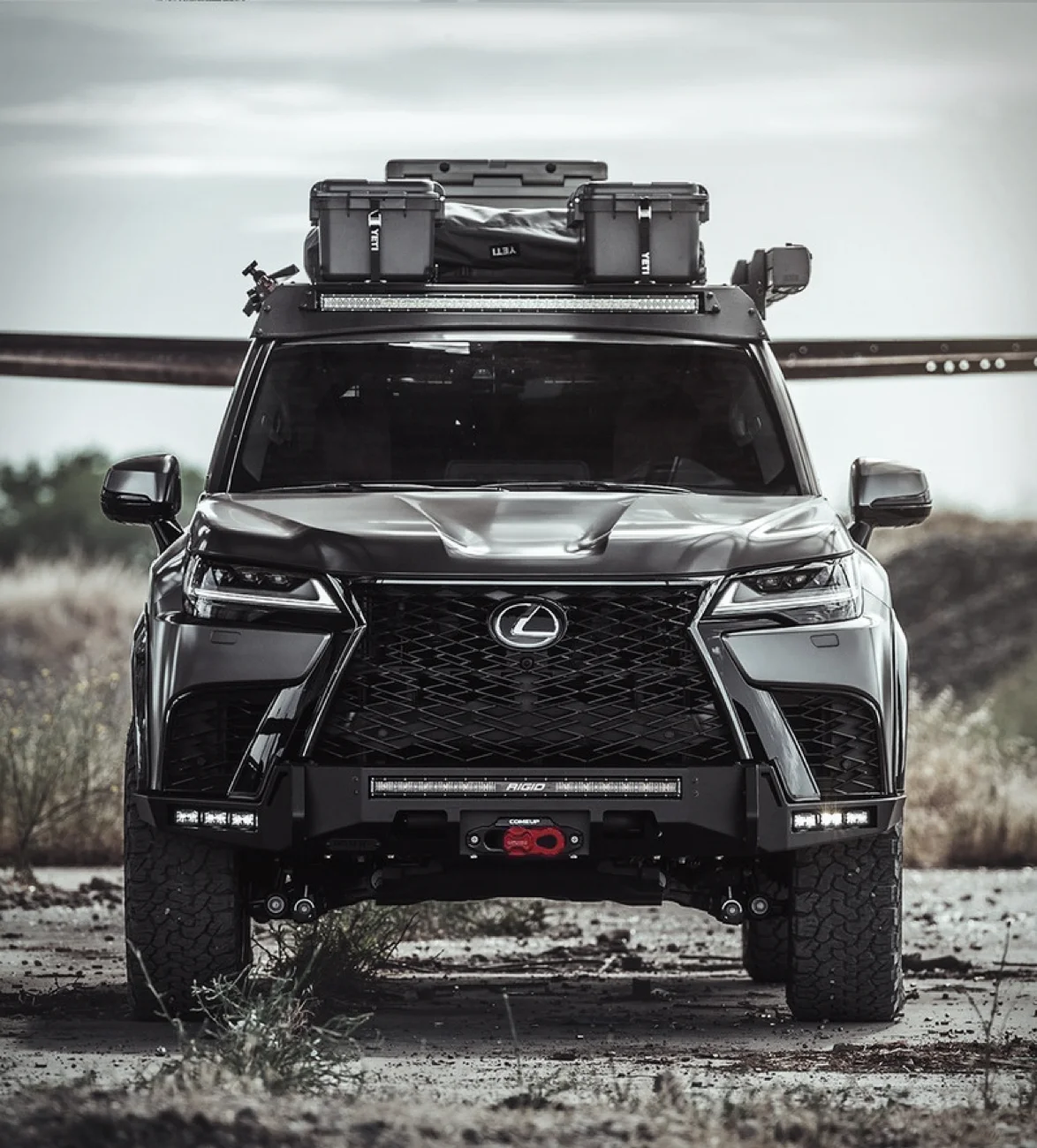

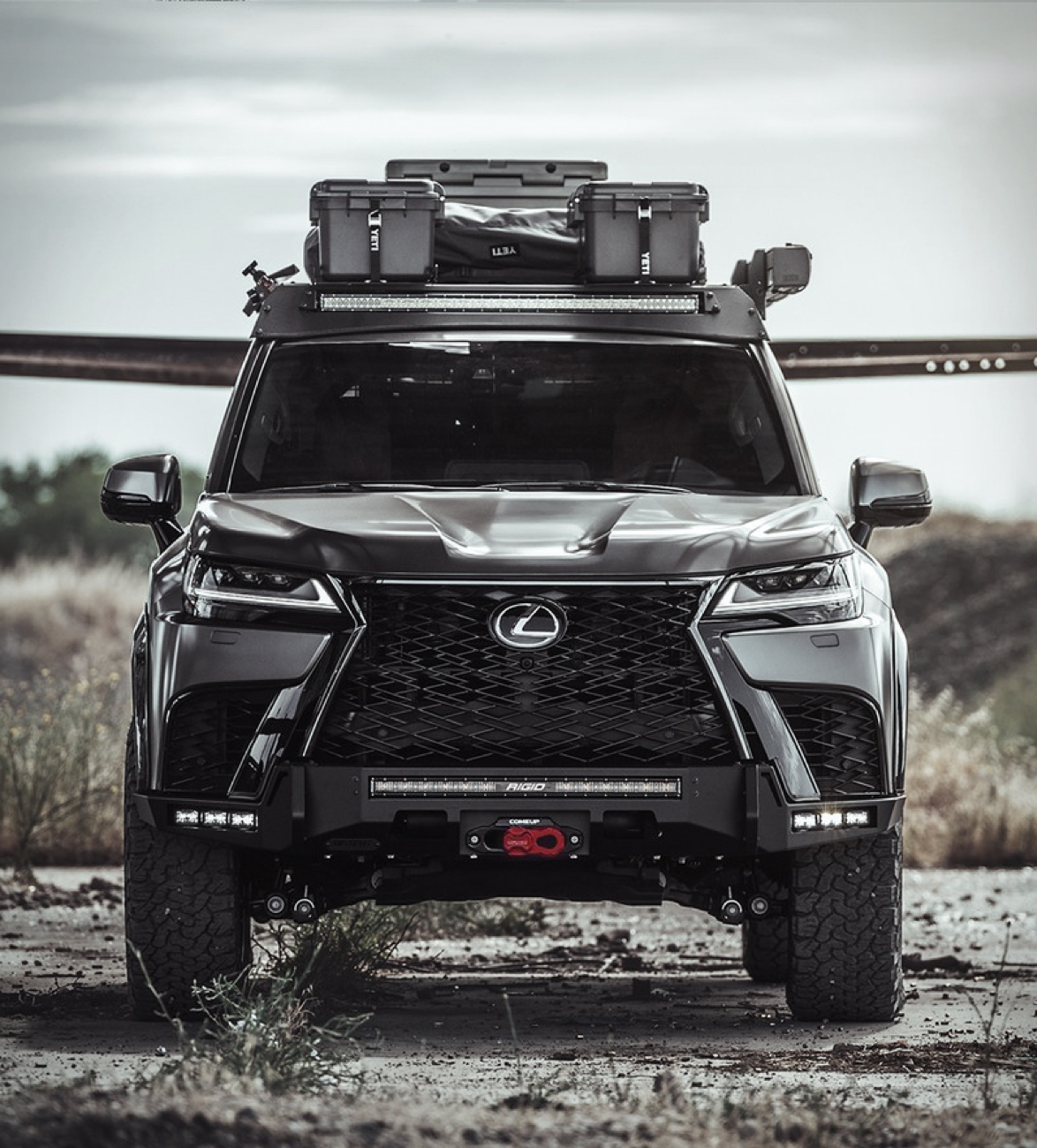

For any one that doesn’t know we had built the lx600 alpine lifestyle concept for Lexus last year and have had a good bit of interest. Here is a photo
of that build.

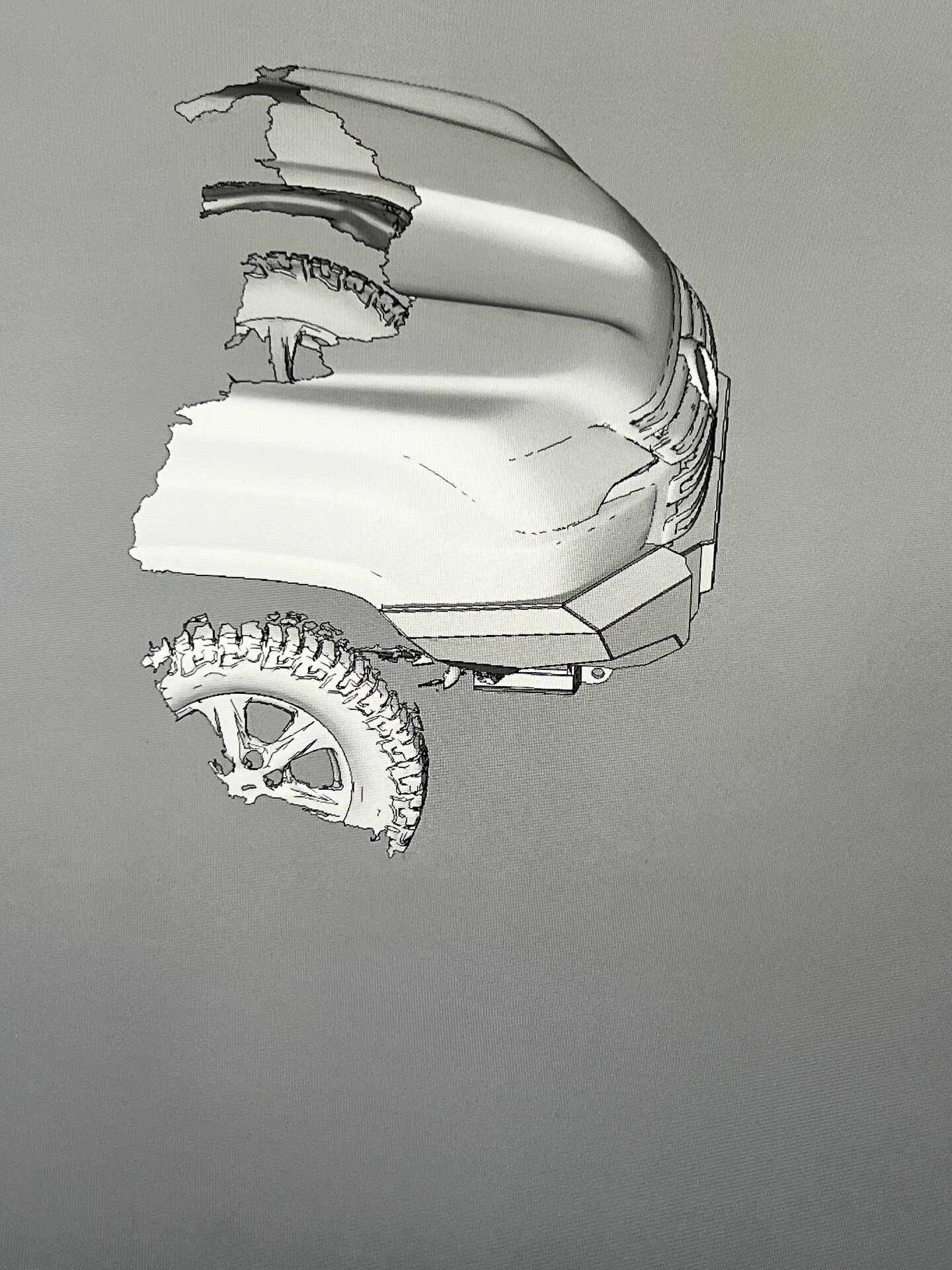

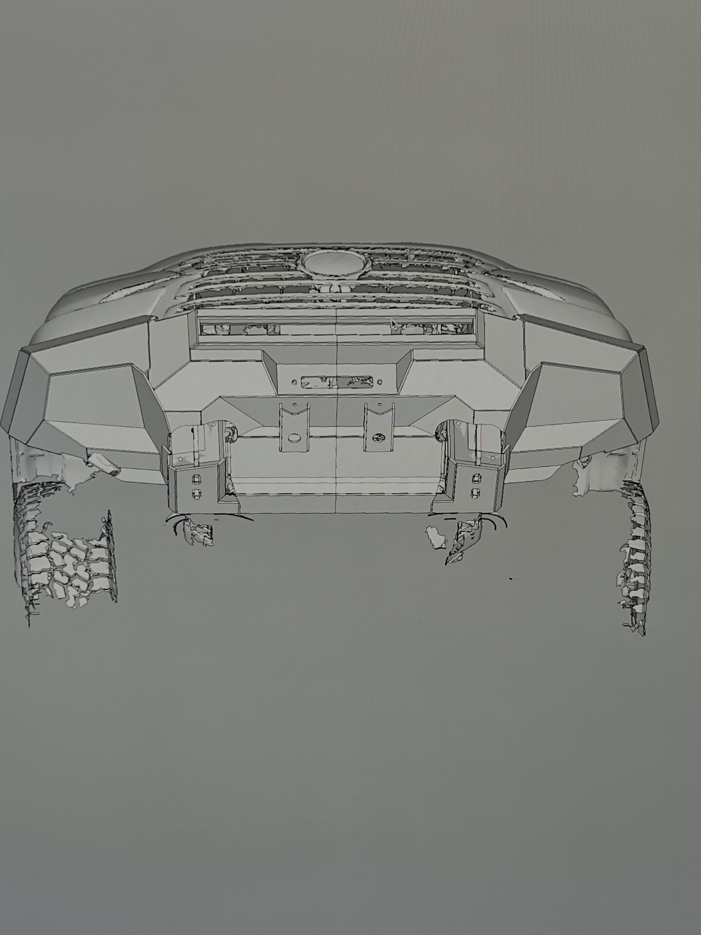

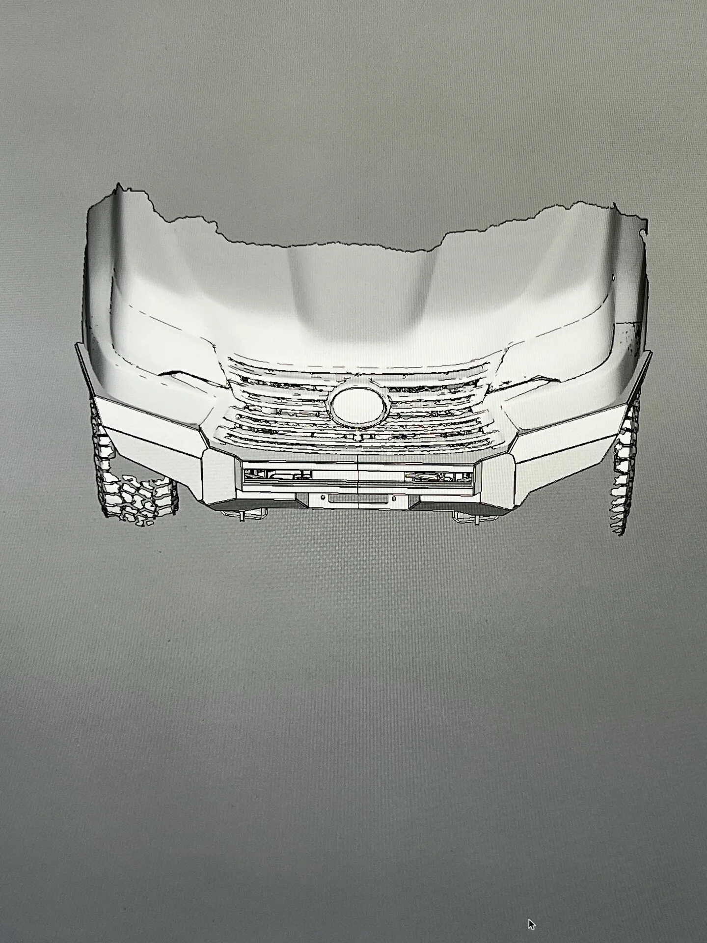

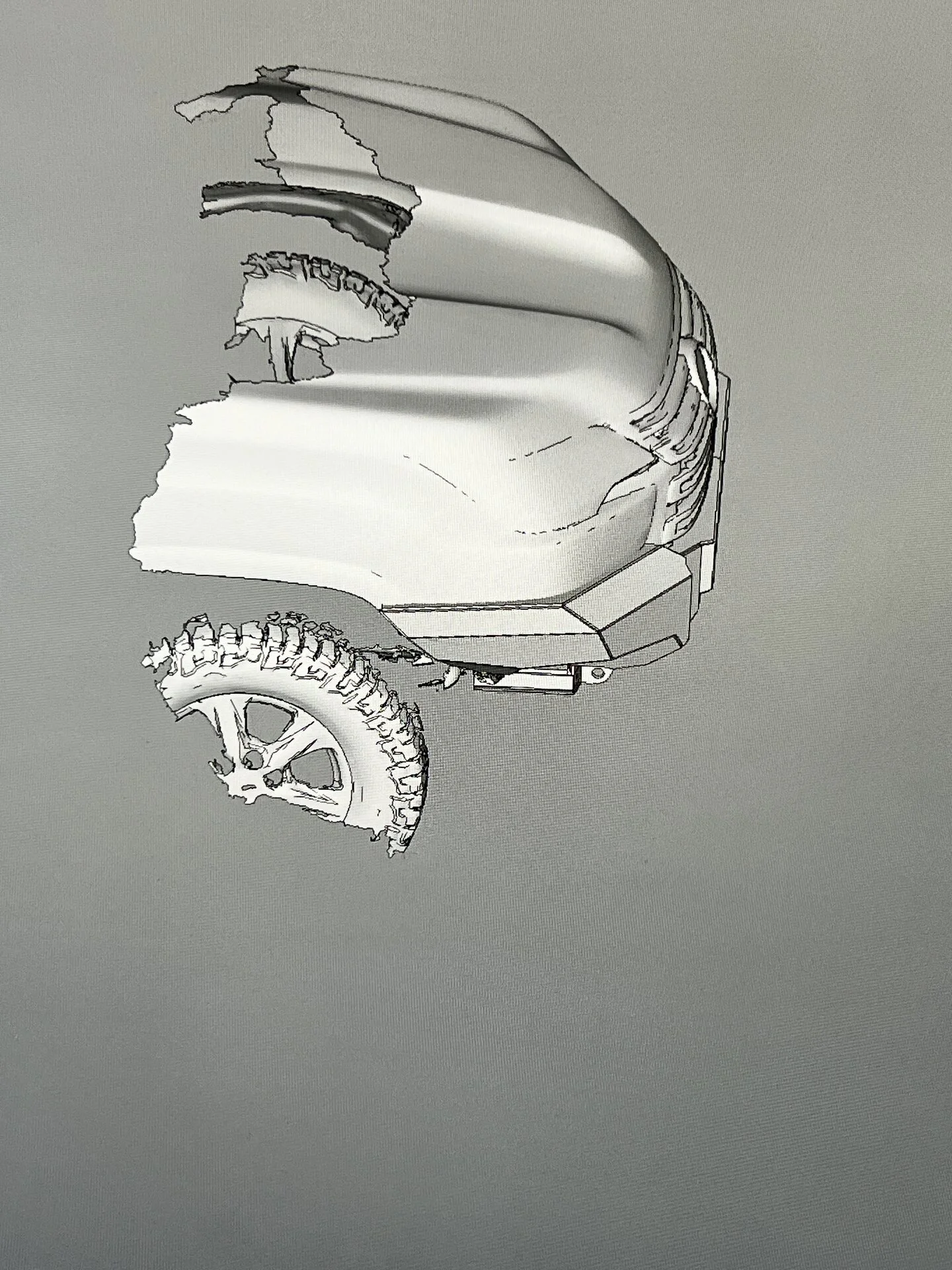

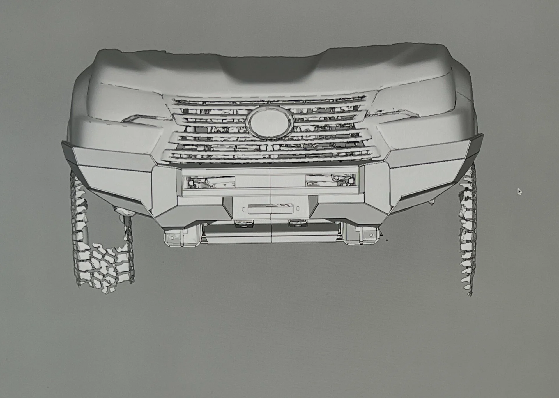

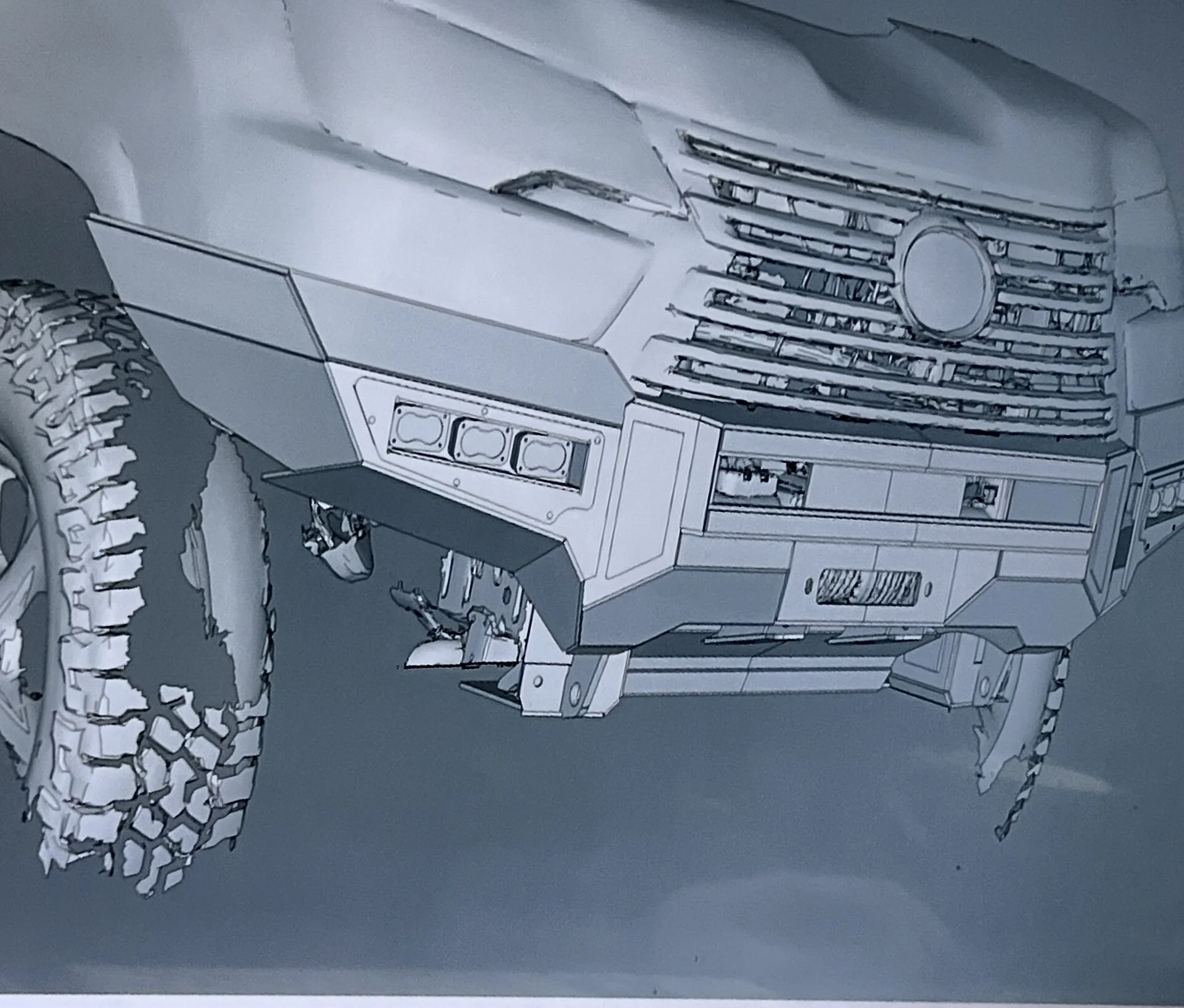

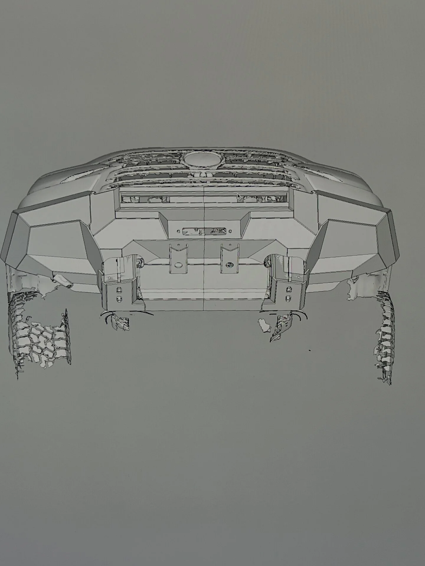

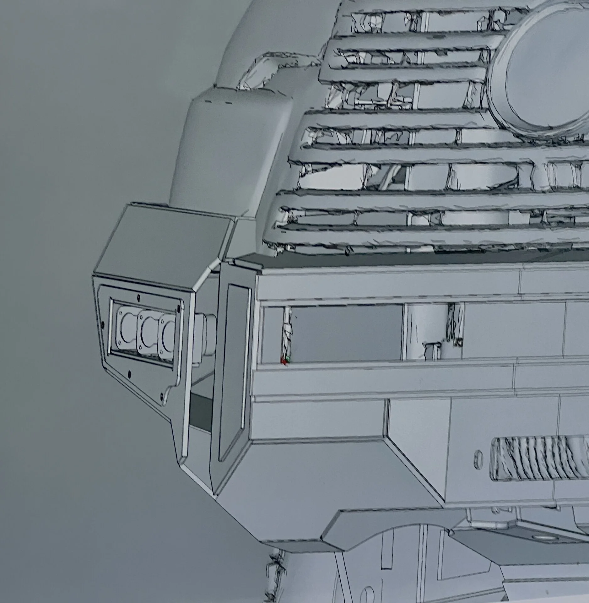

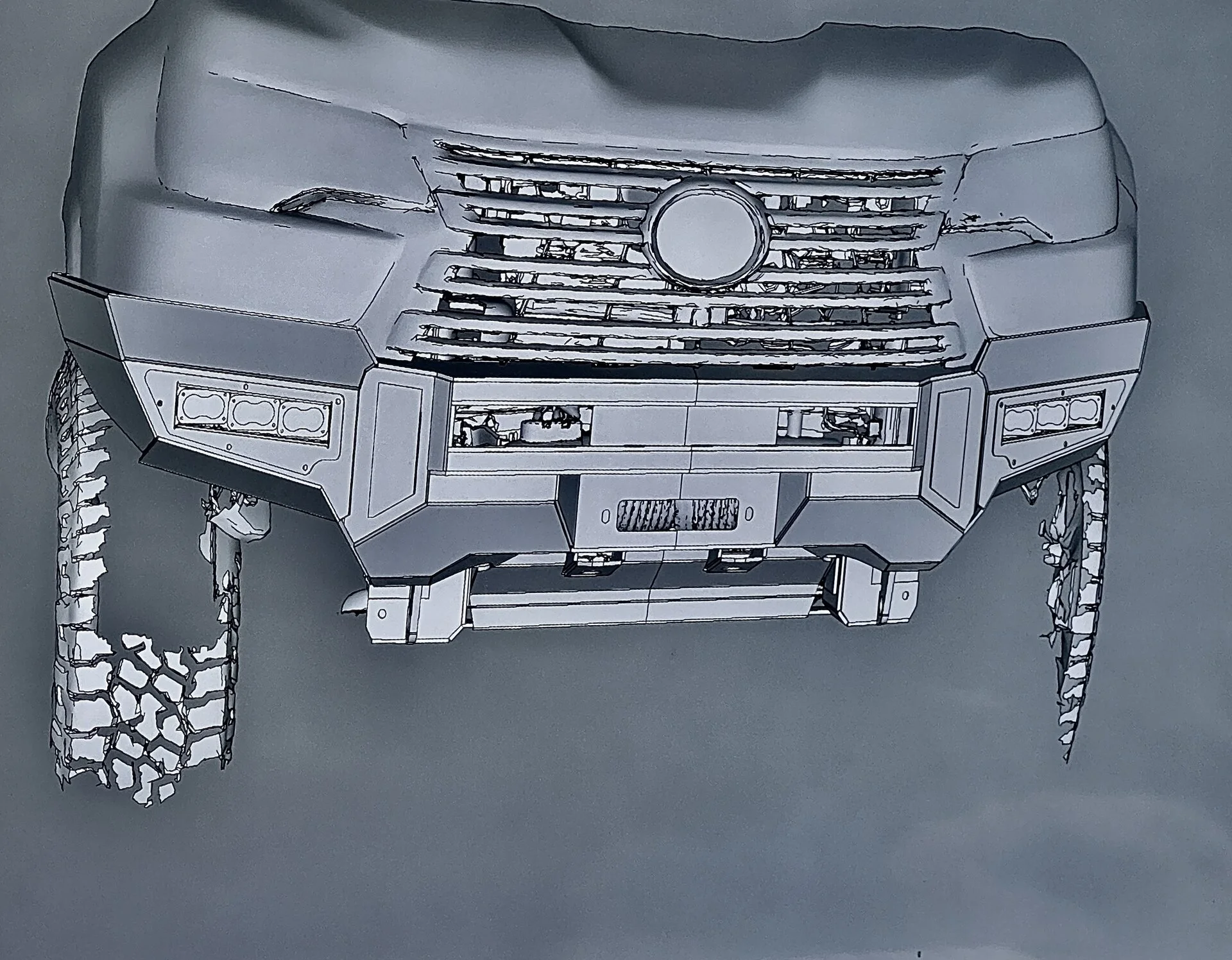

Man, the Ix600 is tricky for a high clearance bumper but we are getting close! We are extremely limited with how high and slim we can go because of the intercoolers. This is certainly a bit more bulky that our typical designs but think it's coming together nicely!
This is far from finished so don't mind the rough edges.
This will be aluminum with a steel subframe. We are veering from our traditional full modular design as we felt it just didn't look right on the x600 with the protruding recovery points. Stay tuned as we are doing a pretty wild build on this one!

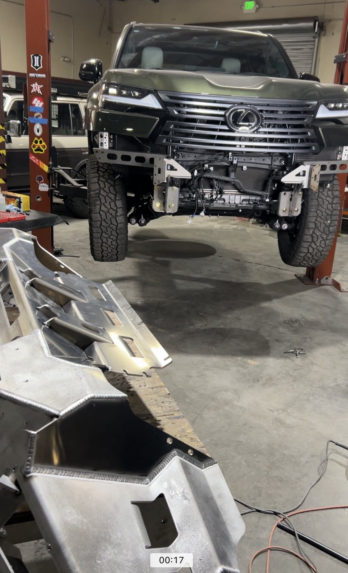

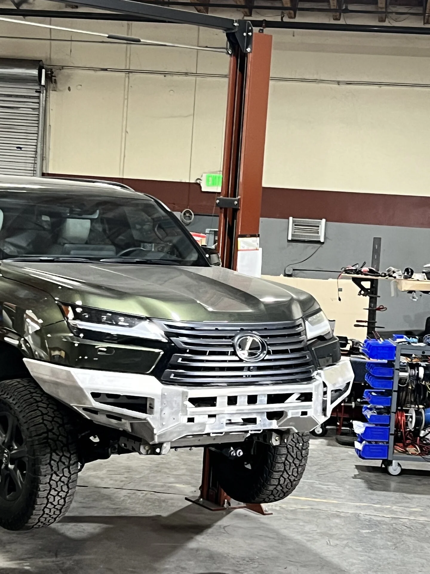

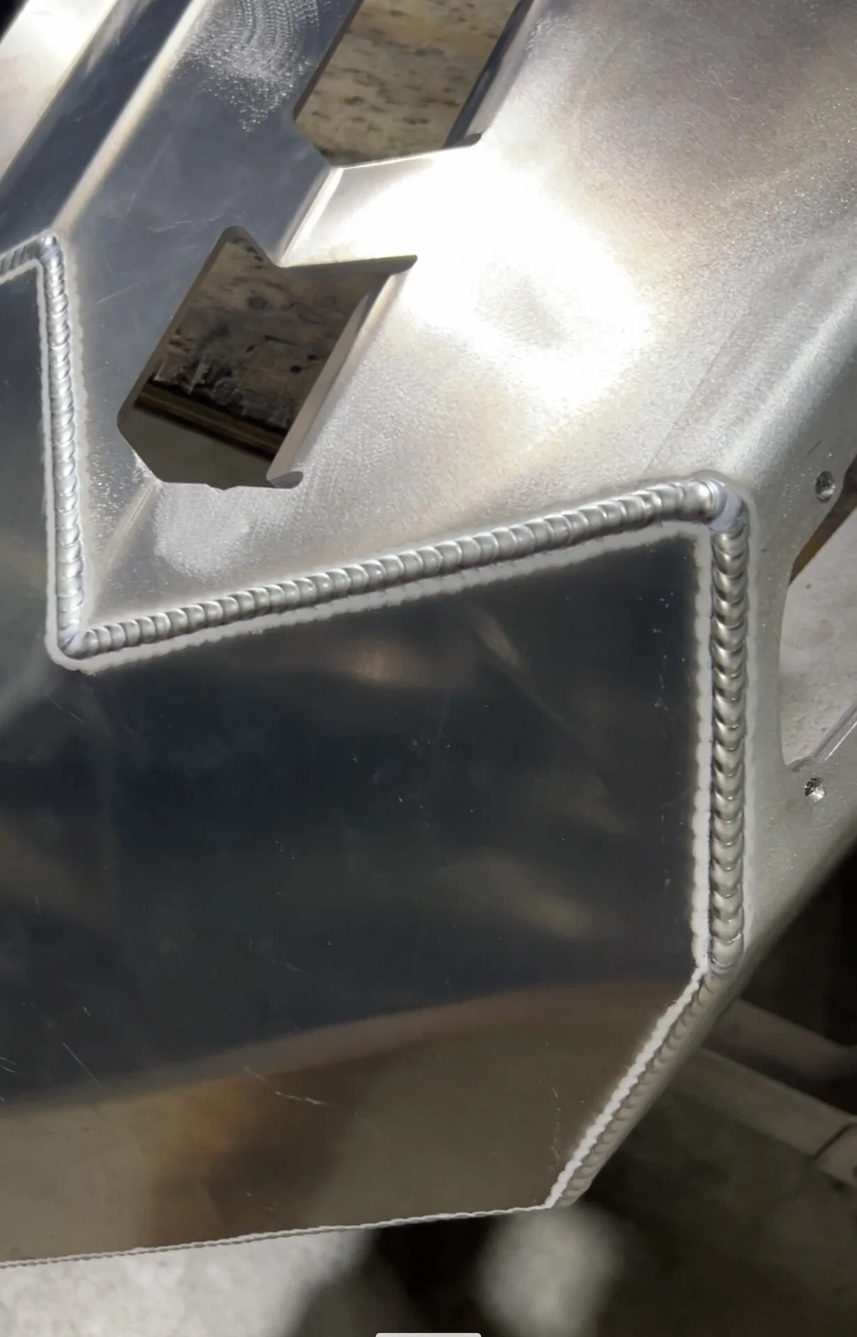

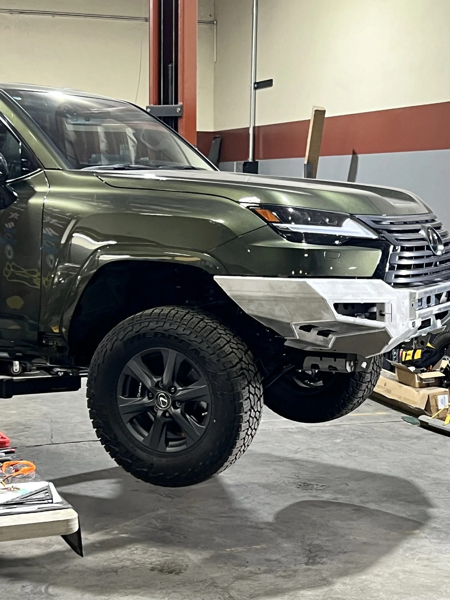

Front bumper is coming together nicely!
In the one picture you can see the steel frame brackets and substructure that the 1/4” aluminum shell attaches to. More details on how everything fits together soon but here are some teaser shots of mock up today after welding.
