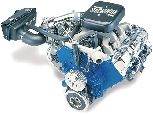

Banks Power | 82-93 Chevy/GMC - 6.2L>>Sidewinder® Turbo System
Cool video from '89 when this system was new(ish):
Looking at this picture, the turbo is on the PS side, so you should have plenty of room for it in the engine bay. The only point of concern will be the exhaust pipe that runs from the DS of the motor to the turbo, but based on some googling, it may clear anyway:

I had a Banks kit and never got around to putting it on. I found a couple of people that had put regular GM4 turbo setups on their 60's. Some inner fender modding was needed on the pass side. Also the drivers side to make clearance for the crossover pipe. I have some pictures I got from two people that did the turbo install. They're probably on my old computer. I'll dig them up after this weekend. The Banks does protrude out a couple inches more than the GM turbo.

The 6.5 is a Diesel setup for induced draft as it has lower compression than the 6.2. The Banks setup is specifically targeted for the 6.2's higher compression. My intent here is to leave a bread crumb trail for the next idiot cruiserhead whom feels a 6.2 diesel swap is a stellar idea ( a 6.5 would essentially be the same swap as this one). My goal here is to get increased drivability over the 2F which was absolutely painful being loaded for a fun weekend and having to only make 50 mph up a grade, not being able to effectively tow and getting crappy mileage ( I'll take 20 or so mpg). The 6.2 with or without the turbo appears to be a decent solution - I am not looking for a lot of speed performance. Hold 70 mph down the highway and still have excellent low speed crawling capability is going to make me a happy camper. I'll get the engine in and running put some miles in and then I'll take a look at final drive ratios, tire sizes and overall drivability to optimize mileage and desired performance.
