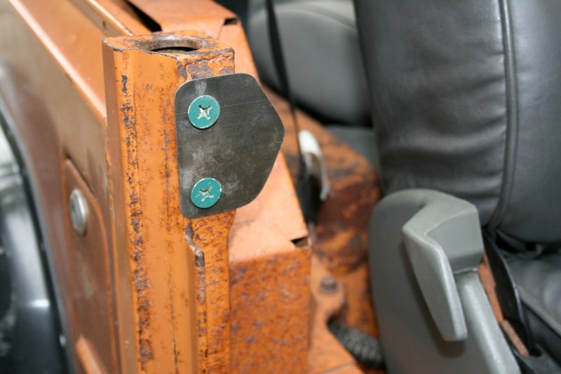

I started by making a template for the updated strikers using an old set of newer strikers, some cardboard, mounting screws, and thin metal. I mocked up their proper location and cut out the cardboard template first. Then once I was certain of the placement I made a thin sheet metal version...
Here's the sheet metal outline with the mounting hole placement:

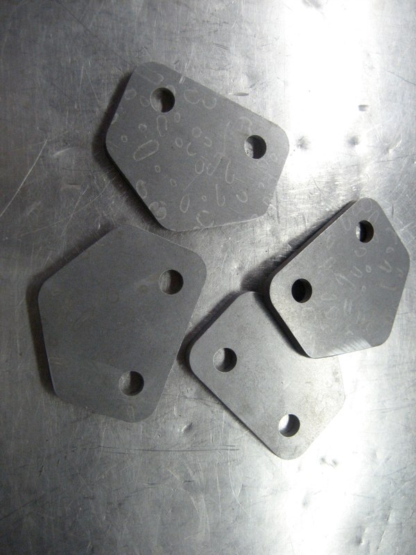

Now that I was comfortable with the template I asked for help from Pat at Summit Steel (landcruisnman). He had a few sets of these 3/16" plates made up in no time. Thanks Pat!

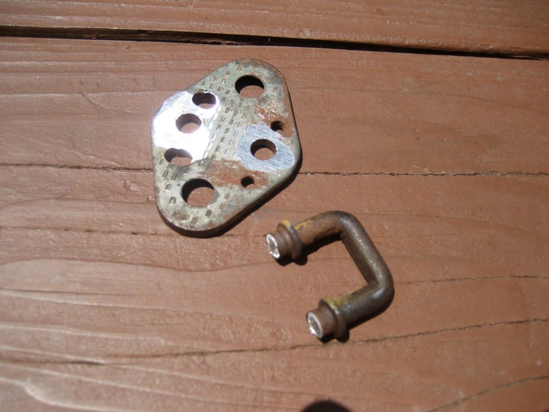

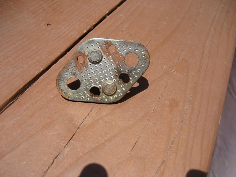

The next step was to take the old striker and grind off the metal backing holding the "U" section to the plate.

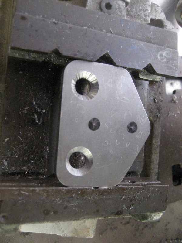

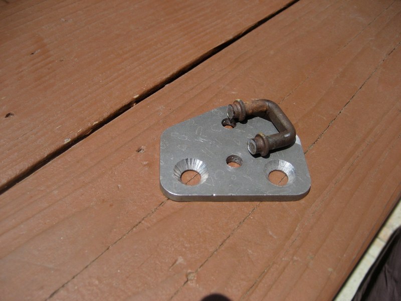

I had to use a large punch and a BFH to bang out the "U". Then I countersunk the mounting holes (3/4" countersink bit) on the new plate so that the original screws could be used on the stock tub...

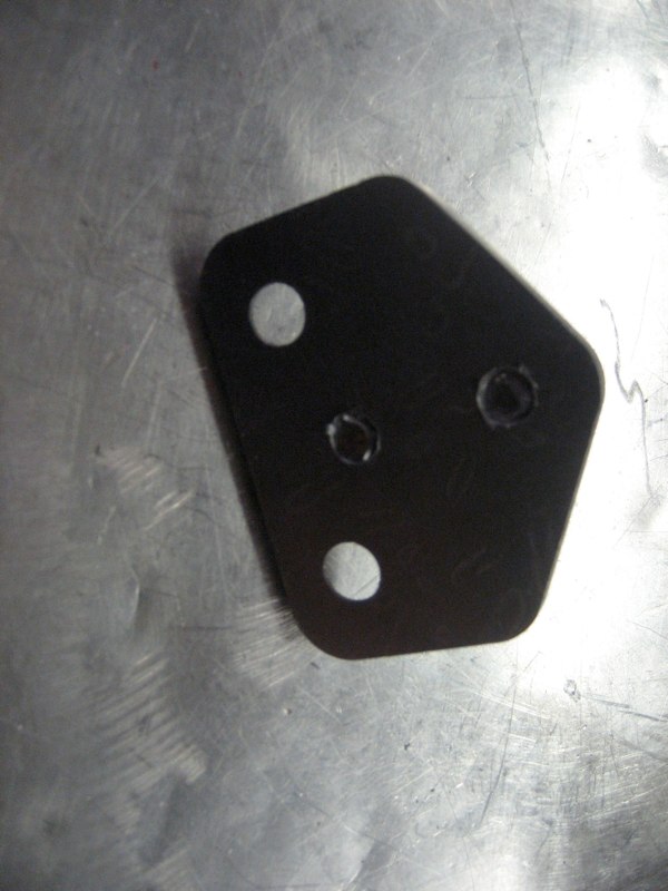

As you can see above, I also placed the old striker plate on the new larger version and marked the holes to re-attach the "U" section. I was extremely careful to mark where the ends of the "U" section lined up with the new plate, then drilled the two holes. The last bit I used was 19/64 and it was exactly the right size.

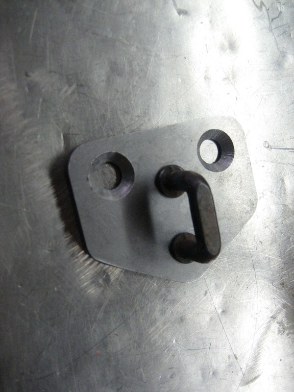

I placed the "U" section against the holes and beat it in with a hammer. Front view...
Rear view...
Rear view...
