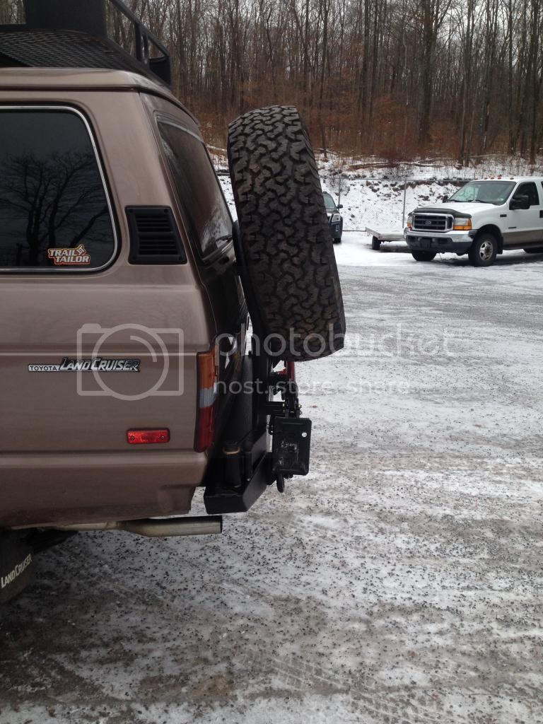

Jason,
Wanted to give you an update on the rear bumper install on my 60. The fit of the bumper was spot on. I had a devil of a time getting the cross member rivets out, had to use a combination of grinding the rivet head flat with the frame, drilling the rivet shank to get it concave, then heating it with a torch, and driving it out with a pneumatic chisel:bang:. To say it was a PITA compared to the front would be an understatement. I guess my hopes were too high after how easy the front rivets came out! At any rate, the bumper receiver frame fit nice and snug between the truck frame rails so I only needed to spread out the frame rails a smidge with the hi-lift, slide in the bumper, and bolt it up. All said, if the rivets weren't such a PITA, this project would have taken me 30 minutes. All in all I had about 4 hours total into the install, most of that spent figuring out how to drive out the cross member rivets without boogering up anything else. Here are a few pictures of the final product. I couldn't be happier with the look, heft, and quality of the bumpers. You make a kick A$$ product sir. Thank you again for all the "customer support" through the builds and installation. To anyone considering one of Jason's products... don't hesitate to pull the trigger, you won't regret it!
Beat me to the punch Jason, didn't see your post before I hit the post button!
Sorry, I came in from the shop early and decided to post them up.. Funny we picked almost the same pics to post..
Thank you S, I enjoyed this build and all of our related correspondence.
