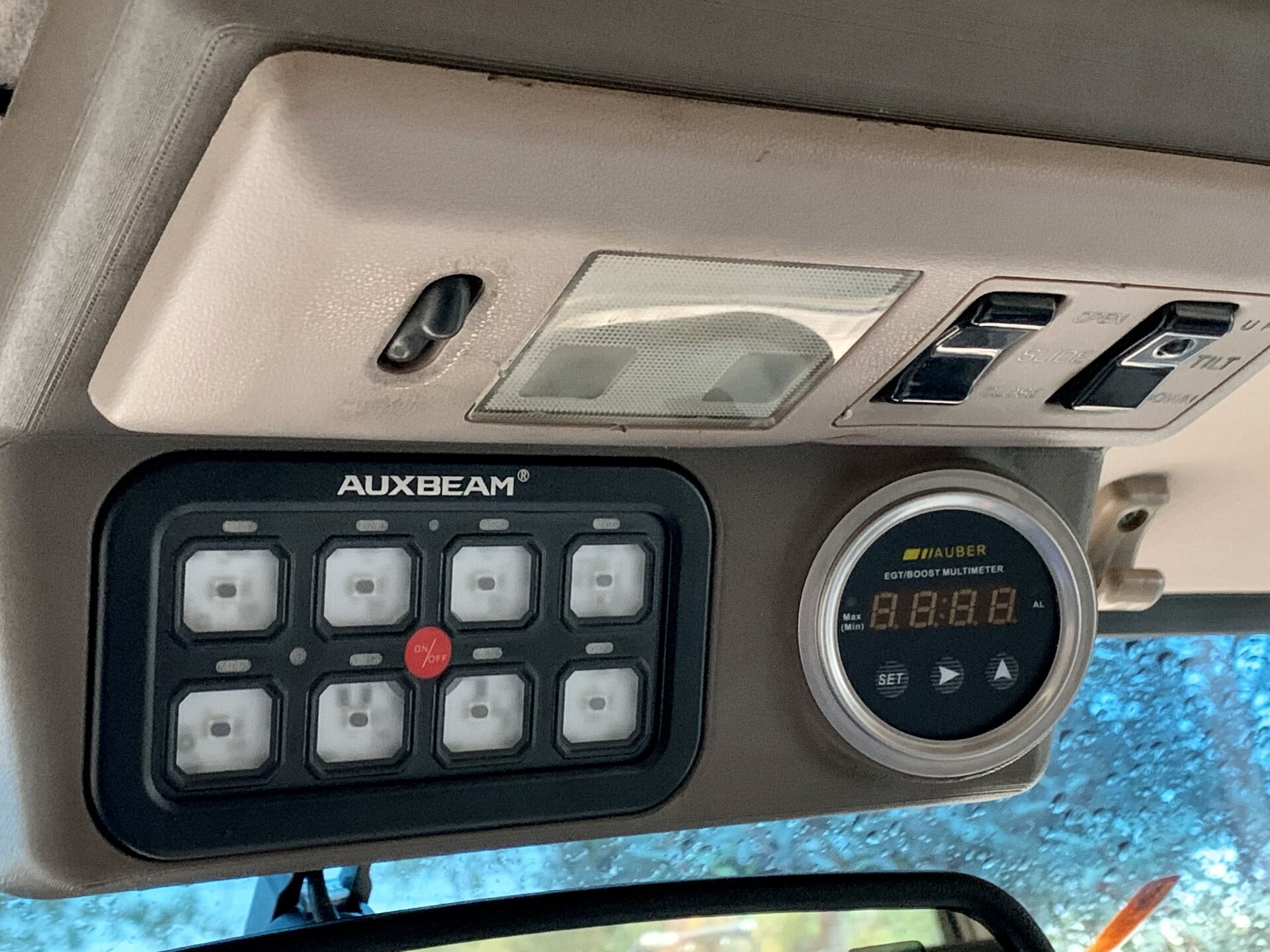

I have started printing some overhead consoles for the 80 series trucks. There a few to choose from. Gray and tan/oak. Im planning making a few other designs. Maybe one for a CB radio, a blank plate so you can cut your own holes, and anything else that you guys might have a need for. Let me know what you think. You cannot use the factory sun visors with these. I have the LS400 visors on my trucks and the consoles work fine with them. They have the same footprint as the factory consoles with the aux fuel gauge/compass/altimeter that were available in the Japanese and European market. There are tapped holes in the roof for the rear mounting bolts, but I don't think they are really needed unless you plan to put something heavy in the console.
$100 Shipped in the lower 48.
This one has a hole for a 2” gauge along with a little display I found on Amazon. It has a clinometer, GPS speedo (KPH/MPH), GPS altimeter (feet/meters), GPS coordinates, voltage, compass, and clock. It retails for about $50 on Amazon. I have used it for a few months and it seems to work well.
Amazon product ASIN B08ZHDKQ6GView attachment 3251386
This one has 3 flat holes for 2” gauges
This one is for a 2” gauge and an 8 port Auxbeam switch panel.

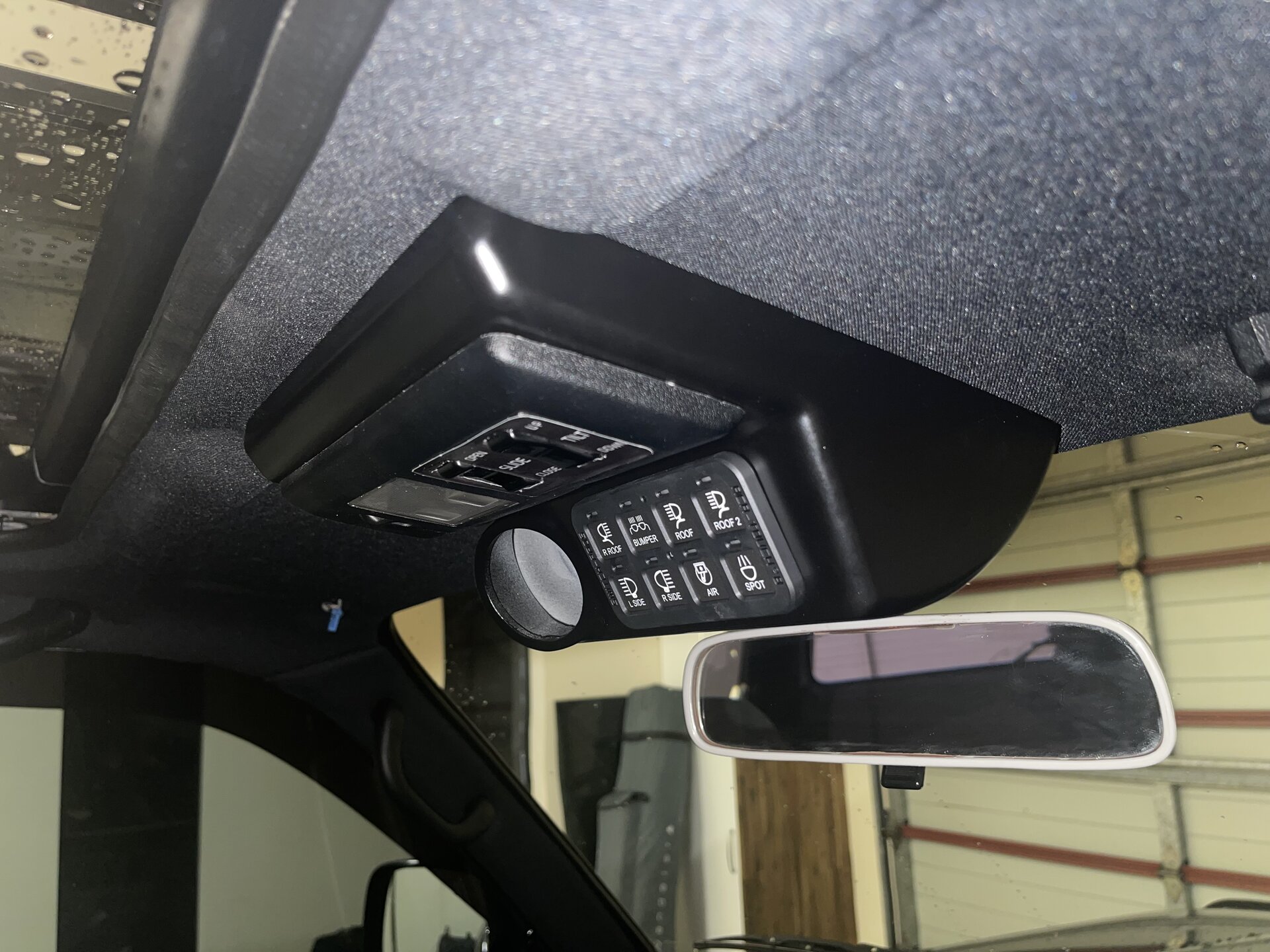

Yes, PM me.Can you make one in tan that will fit the Auxbeam 8 Gang Switch Panel RGB AR-800?
SentYes, PM me.

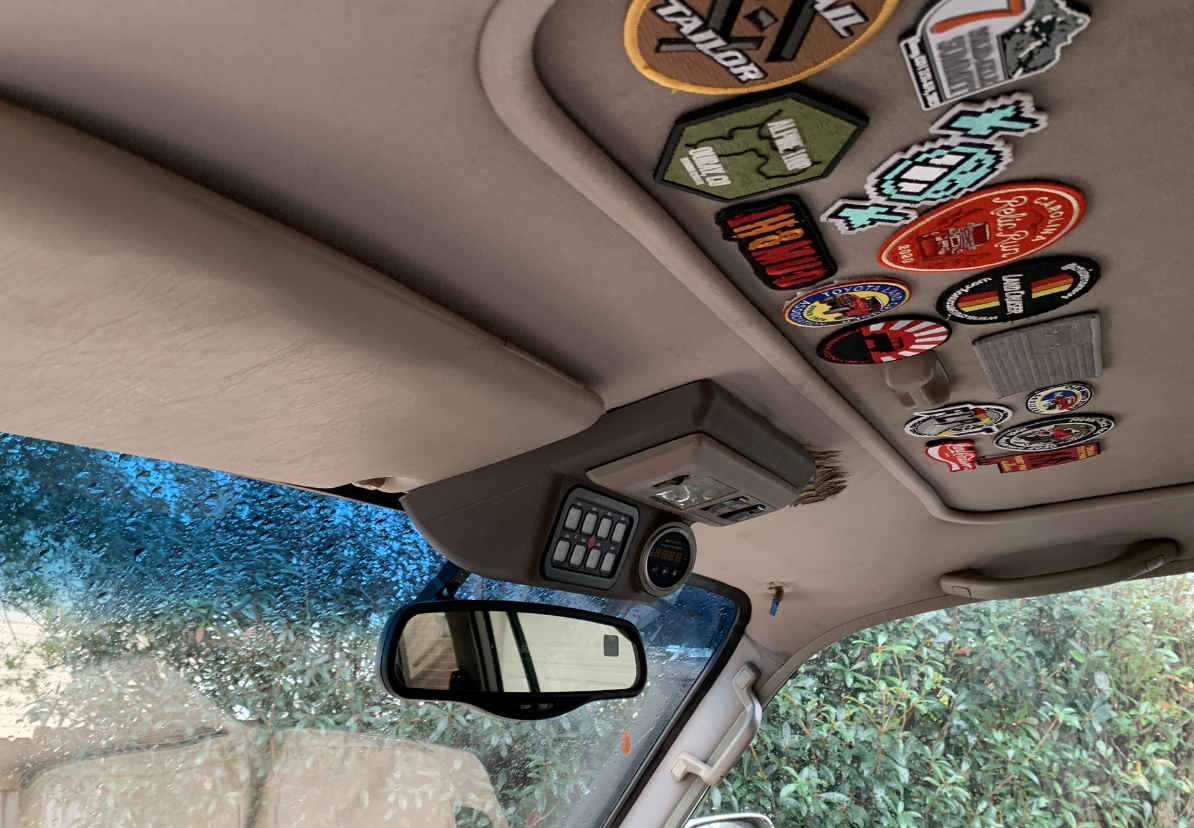

Where did you wire the switch to what power source or did you run the wires from the bottomI installed mine yesterday. Such a great product and the price is nice too. Thanks.
I fished a bundle of wires up the B-pillar and around the sunroof to the sunroof controls a number of years ago for the Gentex mirror. I used a Magnepull that I already owned. Unbolting the seatbelt and sun visor made it easy.Where did you wire the switch to what power source or did you run the wires from the bottom
Nice thanks for your reply gonna be getting mine this week and will have to try thisI fished a bundle of wires up the B-pillar and around the sunroof to the sunroof controls a number of years ago for the Gentex mirror. I used a Magnepull that I already owned. Unbolting the seatbelt and sun visor made it easy.
Amazon product ASIN B00MW9A8AY
What year is your 80? 95+ is a cakewalk due to the modern headliner.Nice thanks for your reply gonna be getting mine this week and will have to try this
97What year is your 80? 95+ is a cakewalk due to the modern headliner.
We have different style headliners. You can easily drop yours. Mine (94) is a flimsy suspended cloth that can’t be dropped down for routing wires.
What gauge you thinking of putting up there?Fitted mine here in Australia fantastic quality thanks so much I sanded and painted mine as my interior is now all black fitted with switch pro just need to install a gauge and it’s done
