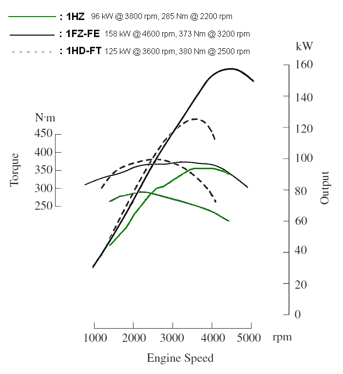

I remember reading about the high torque number at idle being around 80% on the gasser.

There is more than one version of those transmissions (both were available in diesel-powered vehicles). My factory turbo diesel truck has an A442F. IIRC the gearing is the same as the gasoline version although it is not the same transmission and you could consider the 1HD-T to be relatively high-revving diesel.
