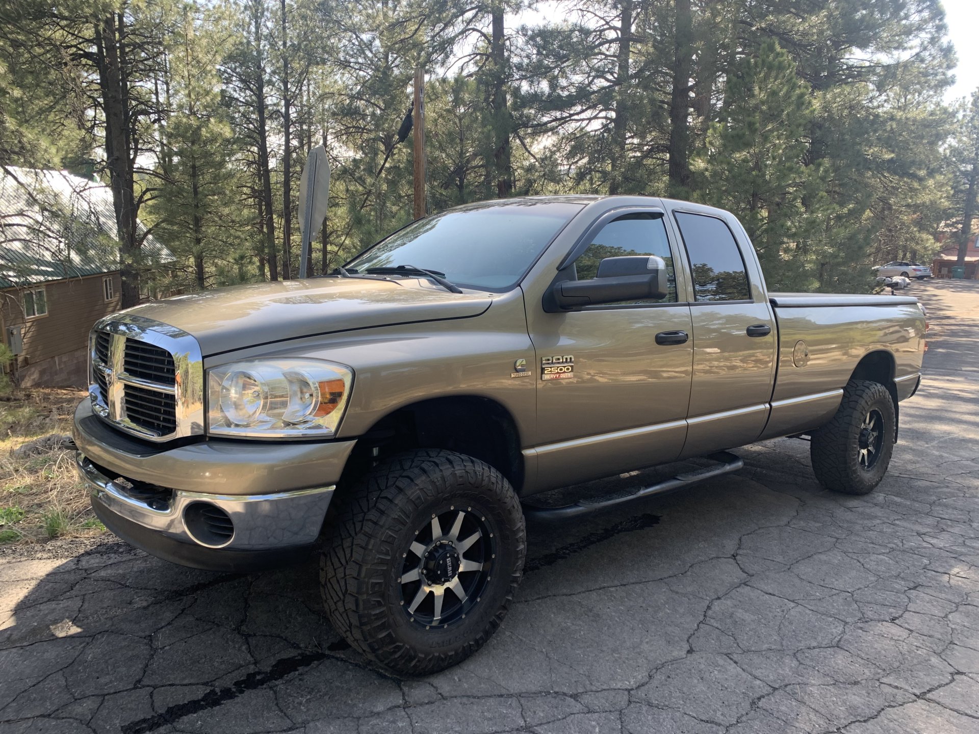

By the way, I just bought an 07 5.9 truck last weekend to replace my 8.1 gasser.
