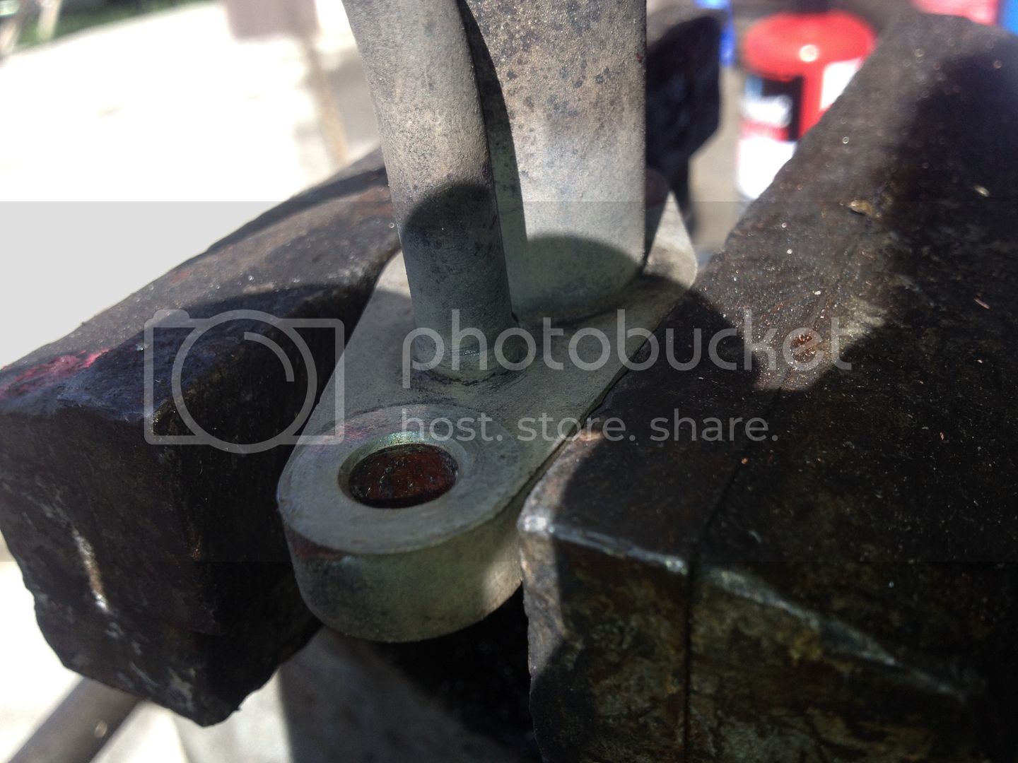

Here is where my pipe cracked. once removed I could not see the crack but as soon as I applied heat the crack was well visible due to expansion.
you can see where it was pissing oil from the base of the mounting flange.
I ended up bronze brazing it using a benzomatic map-pro oxygen mini torch set (found at crappy tire)...we'll see how it holds up fingers crossed.

Well the bronze braze gave way today and I'm leaking oil again. This is my daily driver and I'm trying to get it back on the road tonight.
My question is can I nickel silver braze on top of bronze?
