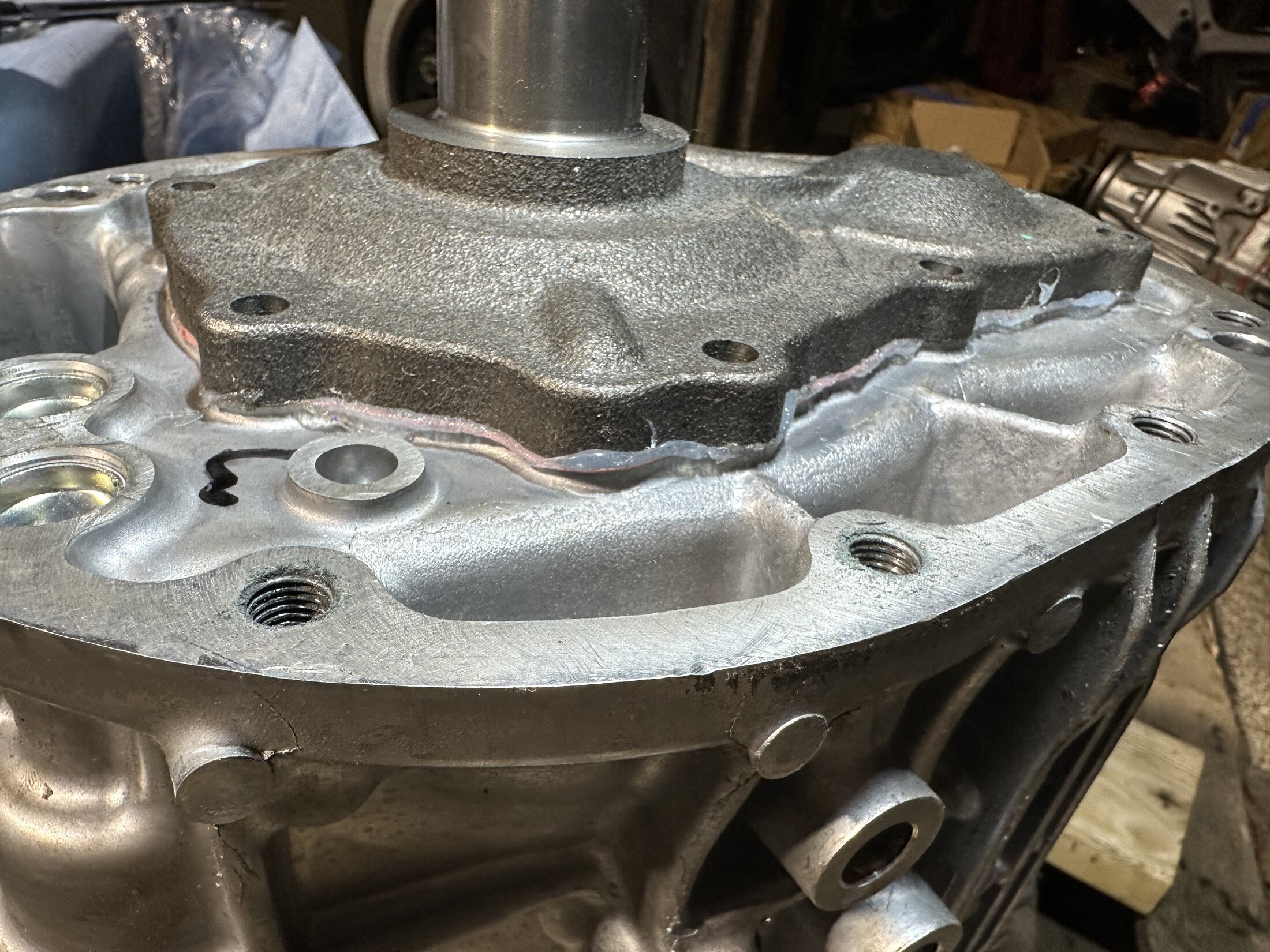

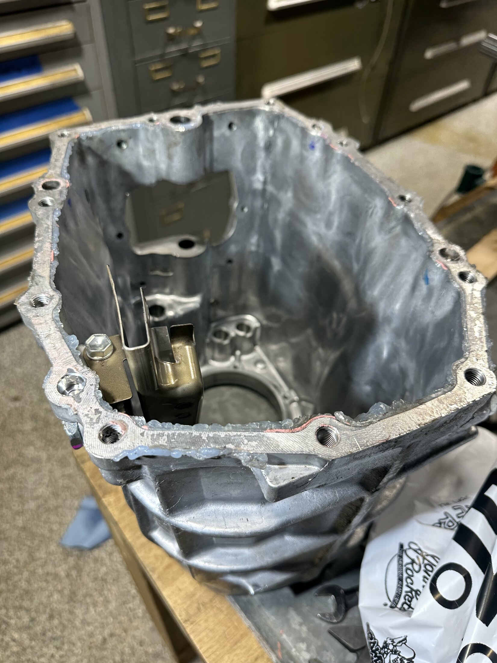

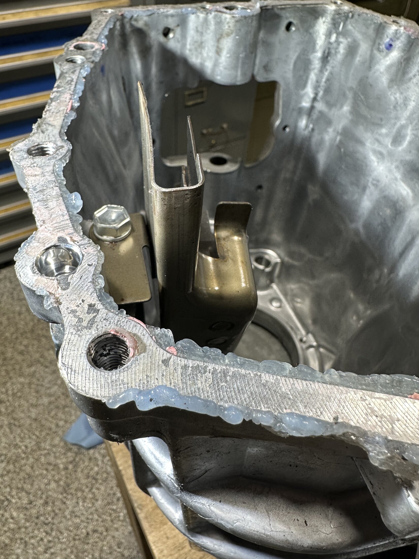

I’ve had some bad experiences purchasing in the landcruiser parts market, but I think I just reached a new level. I just bought a brand new H152 transmission sealed up with clear silicon bathroom caulk. I guess fipg is on back order in NH!

Red FIPG is $25. Sooooo cheap.
33030-60C51 (vdj) h152 is about $2500 plus shipping or local pick up add sales tax.
The other parts are $350 shipped
$25 tube of toyota red FIPG.

The synchro on the input shaft was installed incorrectly. The transmission just flat out doesn’t work. So now I’m figuring out how to fix it.

Just an update for the future potential customers... The 5th gear syncro on the 1fz input shaft is seized to the gear somehow, so the transmission does not function. Basically high prices for longer than advertised lead times and broken parts.
Figuring out what to do with it. I can fix it, but it's some bs, but I've learned a lot about how manual transmissions work. May just order another one and fight these people over $5k.

You bought a brand new transmission right?
If thats how it came from manufacturer how is that the fault of the reseller or is there more to this than just a new trans?
