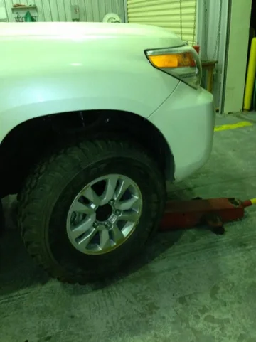

A while ago i tested if Maxxis Buckshot LT305/70R17 will fit my stock 17x8" alloys but there was a like a finger space from UCA and obvious rub to the front. However they fit just fine in my friend's Lc200, who's got stock Toyota steel rims (17x7). We are both running OME 2".
Pic is from my 17" alloys with Maxxis, didn't even lower the wheel after noticing the obvious rub n UCA clearance
285-70/17 seems to be the best size for my rim size.
