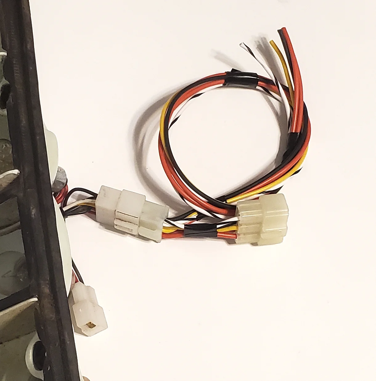

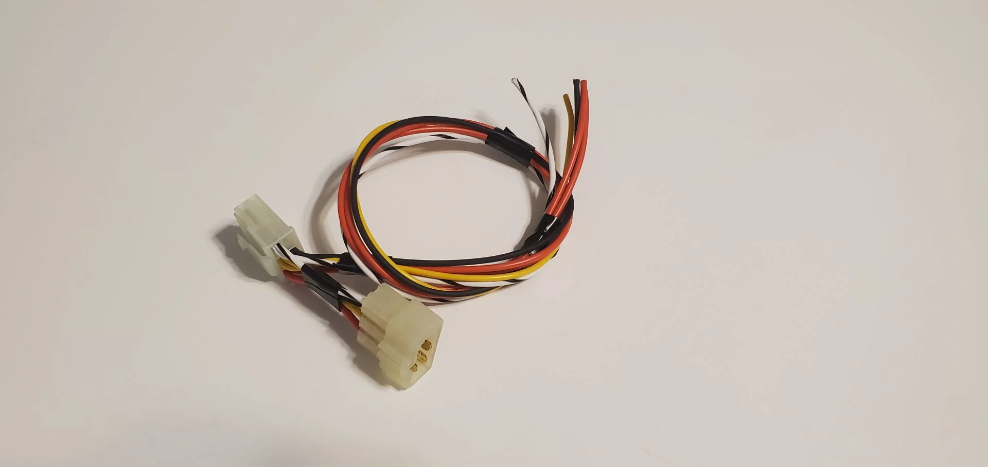

Anyone be interested in a 100% plug and play trailer light wire harness? Installation would compromise of plugging in these jumpers into your taillights. No wire work or permanent modification whatsoever required at all. I have the initial plugs in stock so I figured I would just make a demo.
I would handle all the wire splicing / plugs on the FJ60's end, making this to be a breeze of an installation job for you.
Let me know if you guys are interested and ill throw some out there

So how would this work? The pigtail that plugs into the vehicle's wiring would just provide signal to the box you have pictured, which would use batter power to power the trailer lights? Looks like a great idea. Is there an option for the round 7-pin connectors?
Yeah basically,
Im still working out which final kits to use, A different kit for the 7pin may be needed so ill figure that out. I want these to be as versatile as possible so there's still some figuring out to do.

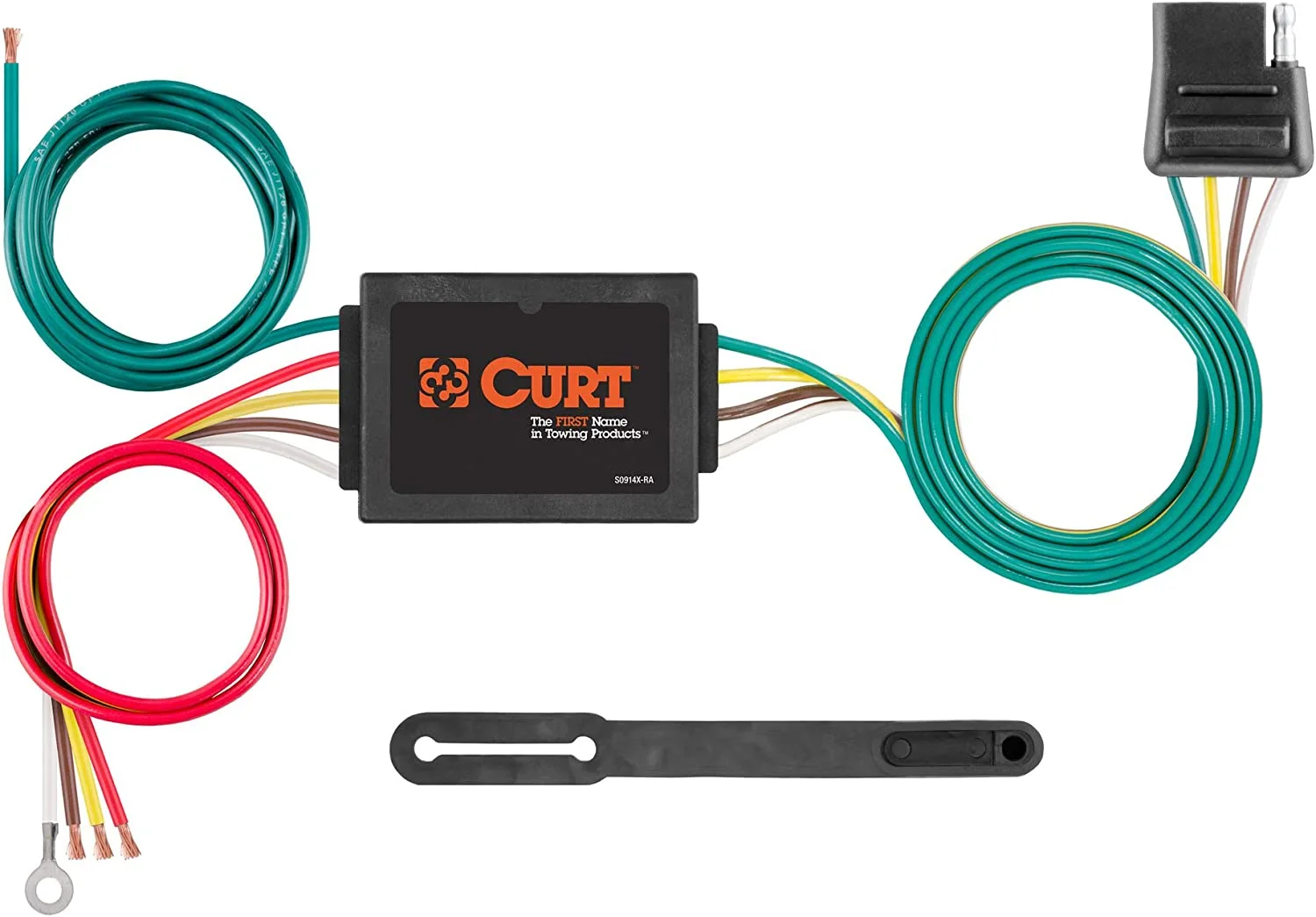

Is the 5/6 wire to 3/4 wire converter even needed if you have access to creating a pigtail to plug into existing wiring? You could do the conversion in the harness you make couldn't you? So a pigtail that plugs in between the factory harness and taillight, converts the Japanese 5 wire lighting to US 4 wire wiring and comes out as a 4-way or 7-way plug. The 7-way version of the pigtail would just need the reverse light signal off the taillight in addition to the normal stop, turn, run signals, and then an open wire for the 12-volt feed included in the 7-way setup if desired. Not sure if that's the road you are going down or not, but would be pretty slick. As plug and play as it gets.
I currently have that converter box on mine and use a 4-way to 7-way converter plug coming off the converter box. I don't need the additional wires the 7-way gets you for my little trailer, but like the 7-way plug style better. The 4 to 7 converter plug has a 4-flat connector and then has extra wires to crimp to get the 12V and reverse signals. I just don't use those. My adapter is powered so it drives the trailer lights instead of having the tired 80's era lighting wires do the work of lighting both the truck and taillights. It would prolly work fine but I decided to help it out and got the powered converter variety. I would have just been happy to have a plug setup so I wouldn't have to splice into my factory wires to get signals, but as long as you are making this up from scratch, I am trying to decide why you couldn't convert in the harness.

Without the converter the turn signals wouldn't work while the brake is being pressed as it would just be getting a constant charge.

My kit will include a "CURT 57672 Dual-Output 4-Way Flat Vehicle-Side to 7-Way RV Blade Trailer Wiring Adapter" to be more universal between trailers. I'm going to include the option of Trailer Brake control leads from the 7pin connector that will that will reach up near the driver compartment for those who want to run trailer brake controllers. Once I get everything in for testing I may create wire mounts that will clip on to existing fuel lines to make the installation easier. Its all still up in the air.
