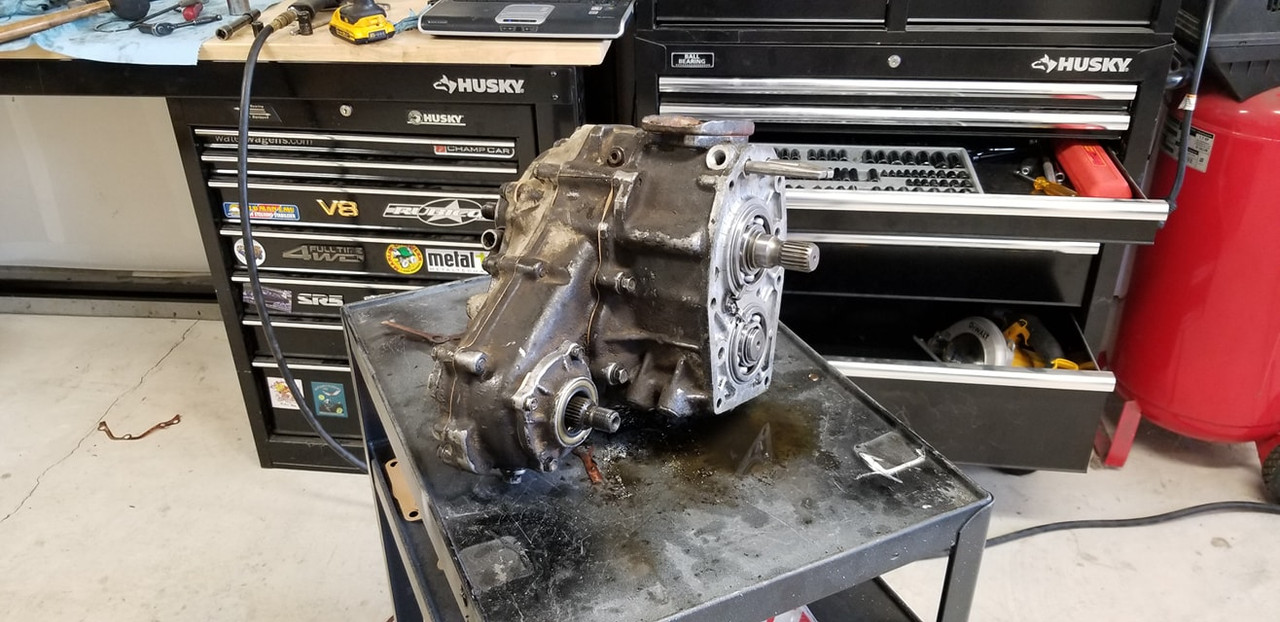

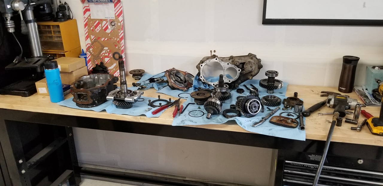

I got a little bit of an update, but nothing too exciting. Saturday a buddy came over and helped me pull the t-case and install Sumo 4.7 low range gears and FROR twin stick. Unfortunately, I was really greasy so I didn't get many pictures. Hopefully this week I can throw some 90w in it and have everything work. LOL!
I just had to tear my twin stick out to reseal. Make sure you glue the little boot.
Mine is a forward shift, so it would take a lot for oil to get out the boot...
You should have taken two more minutes to clean up the case. :flipoff2:
Ain't nobody got time for that.

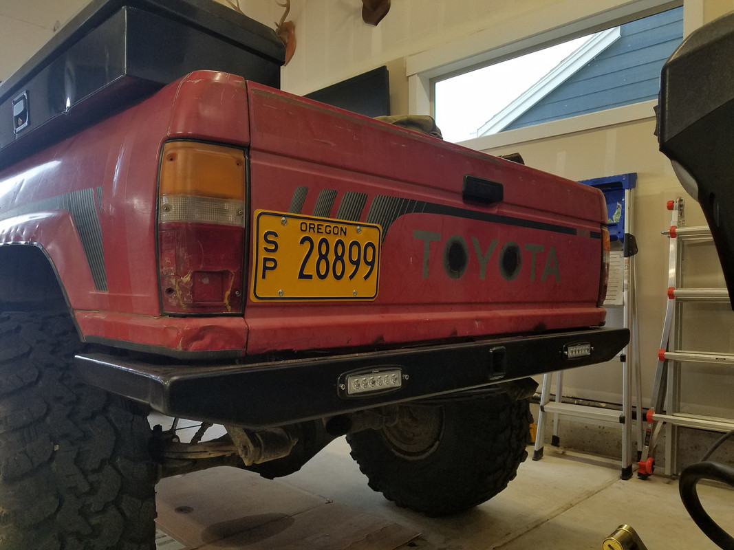

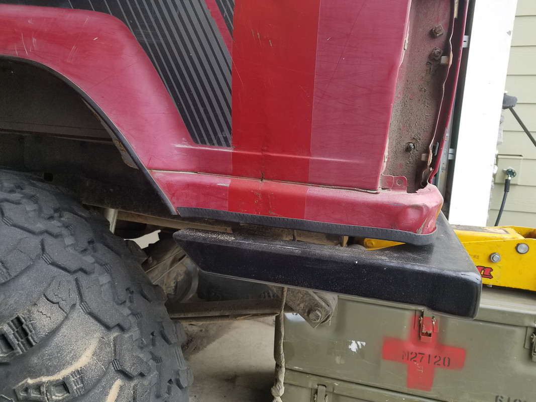

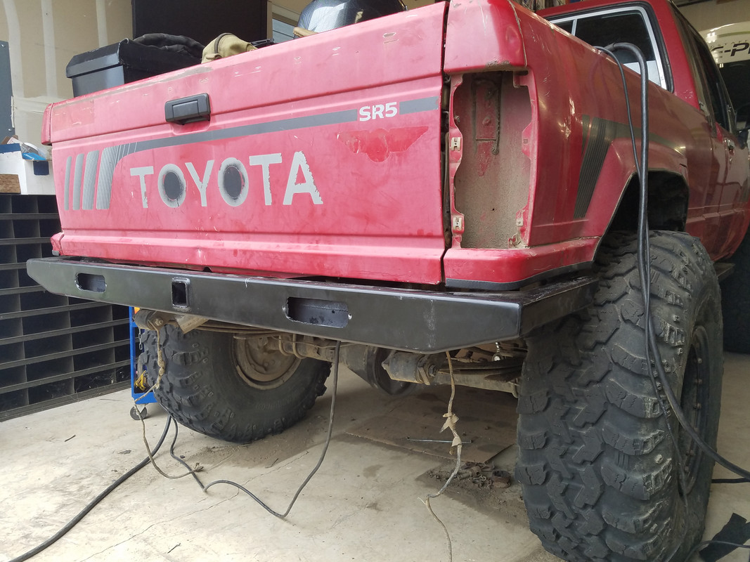

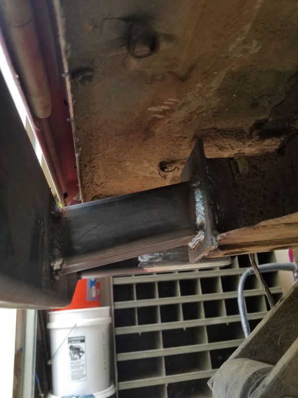

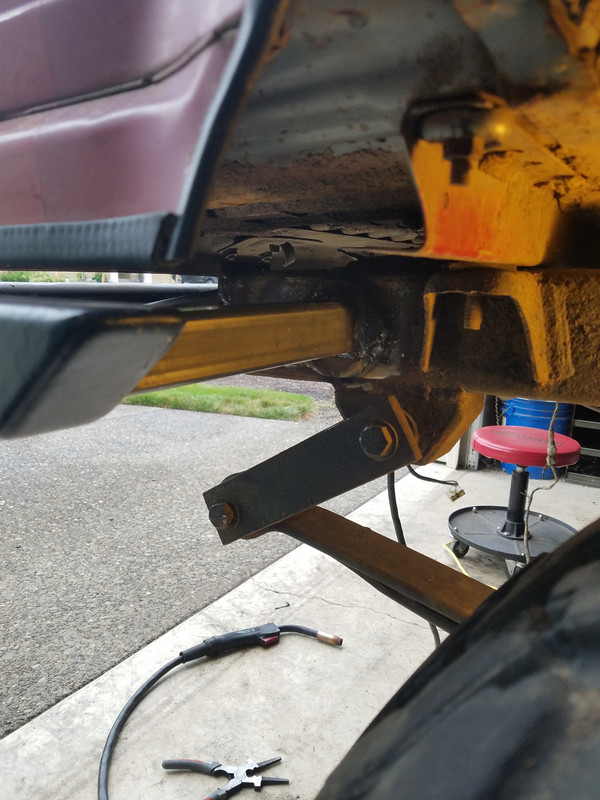

I finally got a little bit of time to start working on my back bumper. The main body of it is almost done, then I'm going to trim up the back and sides of the bed. After that it will just be figuring out how to attach it to the frame. A picture is worth 1000 words, so here you go:
I'm really just making it up as I go along, but I think it is working out nicely.

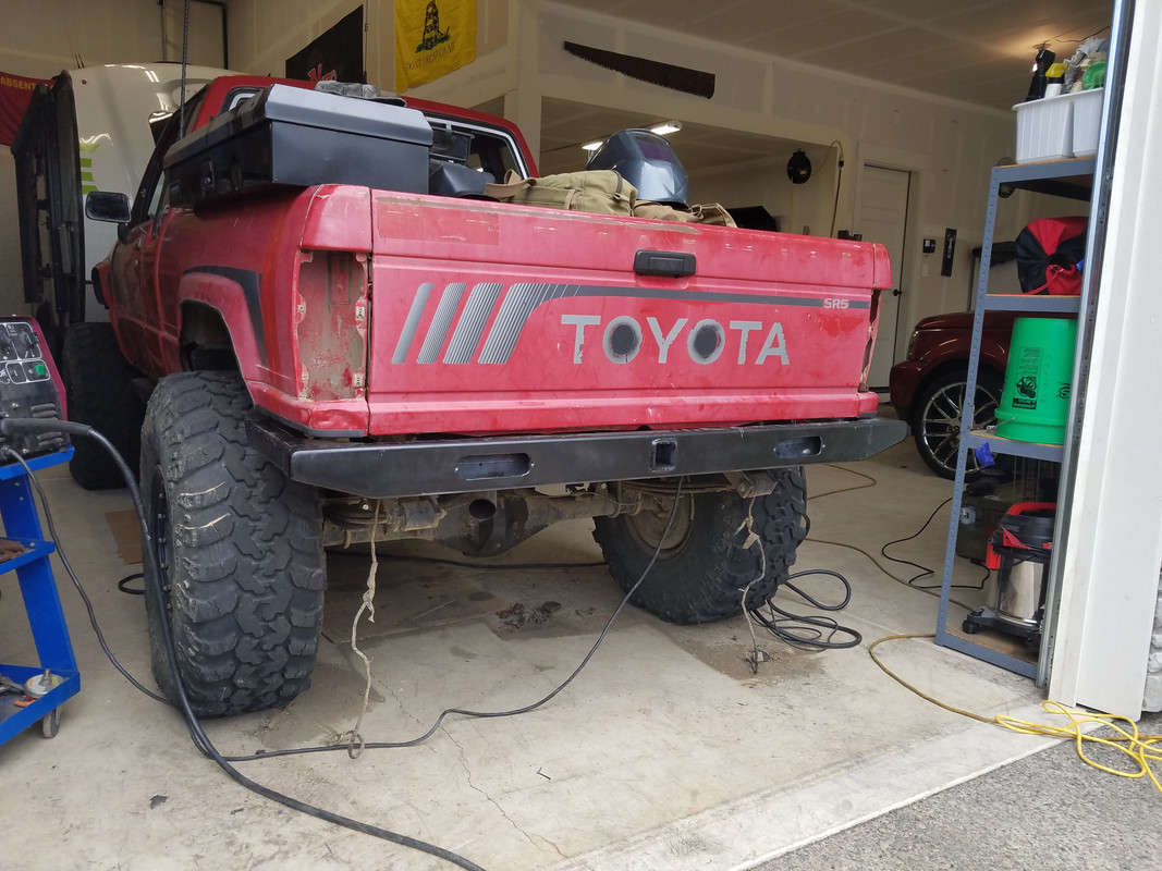

I finally got the rear bumper done! I'm pretty proud of how it turned out:
Now I need to get working on the front bumper... I kinda doubt it will be done in time for Cruisin' the Woods this year, but we will see.

Boring qustion but what size bearing splitter did you use as I'm bout to do the same thing as part of going twin case.
Doh !

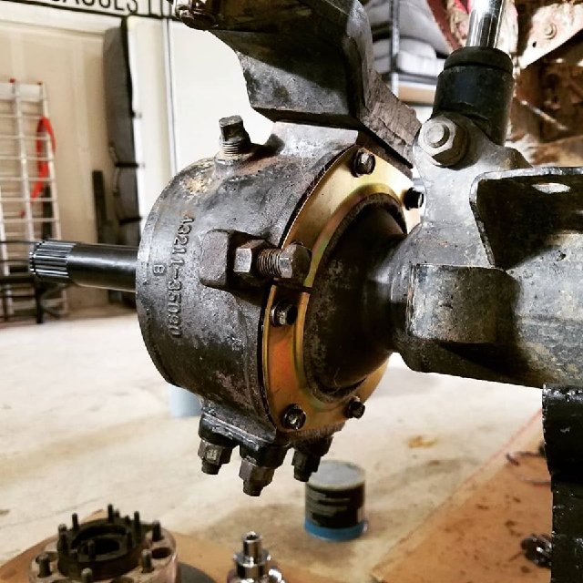

Quick update: Cruisin the Woods was awesome as usually. If you haven't been, it definitely needs to be to be on your radar for next year. The truck worked great except for breaking a birf on the Friday run. When I bought the truck, I was told the front axle was fully built with RCV's. Not only did it not have RCV's (just stock birfs / shafts), it also had no grease... Or inner axle seal. I really would like to kick the PO in the shin, but what's done is done...
Starting October 1st I started my own insurance agency, so I have been super busy! I will also be super broke for a while, so I'm not sure when I will be able to fix the truck. Jerod (@2ndGenToyotaFan) was awesome enough to help me with the trail repair and offer up his used stock shaft and birf! I really want to get some RCVs in there, but I may have to go the stock route for now and do everything twice... :banghead: I guess we will see what happens.
Well the Rover sold, so I will be getting some 30-spline chromoly shafts and birfs. I know RCV's can't be beat with the 300m star and warrenty, but I'm really tempted to save a couple hundred and get Marlin's made by Empi... They are on sale right now for stupid cheap.
This truck will never be on anything bigger than 37's, so I think I can get by with the Marlins. What do you guys think?
Dig the simplicity of the front and rear bumpers. My rear bumper has been sitting on sawhorses for 3 weeks as I've been trying to figure out mounting to the frame...weld or bolt on. I think seeing yours I'm going to go simple and weld on. Congrats and good luck on the new business.

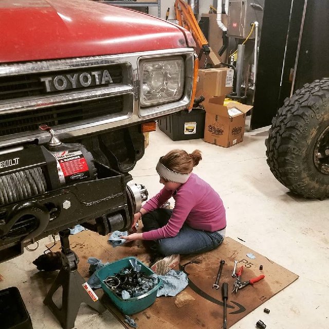

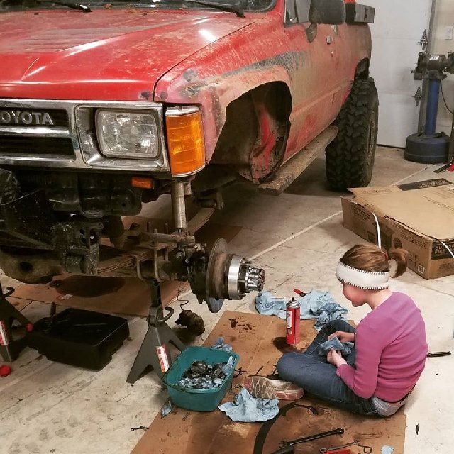

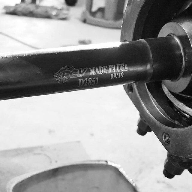

I got the front end rebuilt with all new bearings and seals. She also got 30-spline RCV's! The best part of the whole thing was my 10yo daughter wanted to help me with reassembly. It was pretty special having her out there working with me.
