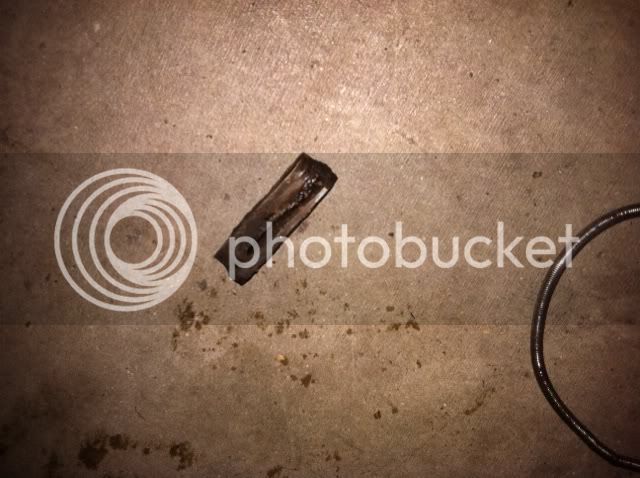

Here is an update on my crank pulley issue. With Paul's help we were able to remove the crank pulley to get a better idea of what was going on. It looks like the threads on the crank pulley have been damaged as well as the crank shaft key. It looks like the crank pulley and crank shaft have been damaged from where the key had rubbed on both of them. There was also a spring that I assume is part of the seal which is also damaged. I was wondering what everyone thought would be the best course of action to fix the issue. I am guessing that a speedi sleeve would help with the thread damage on the pulley, but as the key damaged the pulley and crank I am thinking that they both might need to be replaced.

I have a 2F crank you can have. I might also have a 3FE pulley, though I'm not sure how it would work with your accessories. The pulley closest to the engine is a different size than the 2F. No belt on that pulley? Then you should be OK since the other two are the same.
I do have a 2F pulley, but the rivets were mugged by the impact socket.
Pappy-
That would be great! I think the 3FE should work as I am not using the inner ring on the pulley. The crank would be great as well, any time that would work for me to stop by? PM me and I can stop by and to discuss what you want for the parts, $$, beer, etc. I appreciate your help!!
Ian
Typically that spring comes with a new seal. I think it provides a little rigidity and compression of the sealing surfaces onto the shaft.
