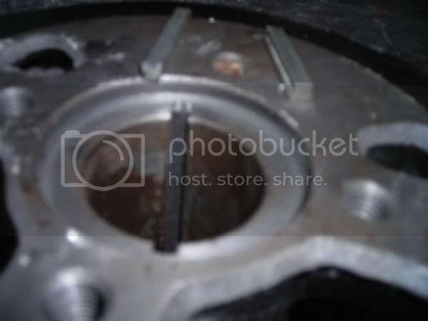

I cut an extra keyway cut in the balancer 180 deg from original. I got two pieces of key stock. one 1/4" with a 3/16" step. The other a 3/16" square. I got a dremel tool and cut a 1/4" groove where the original woodruff key was. The 1/4" part of the key will fit in the new crank slot, and the 3/16" step portion will go in the balancers original keyway.
I cut another 3/16" slot in the crank 180 deg away. the square 3/16" key lines up with the new slot in the balancer.
If you take the balancer to a machine shop and ask them to use a broach to press in a new keyway. The process only took them 15 min and only cost $20
Machine shops will have stepped key stock.
