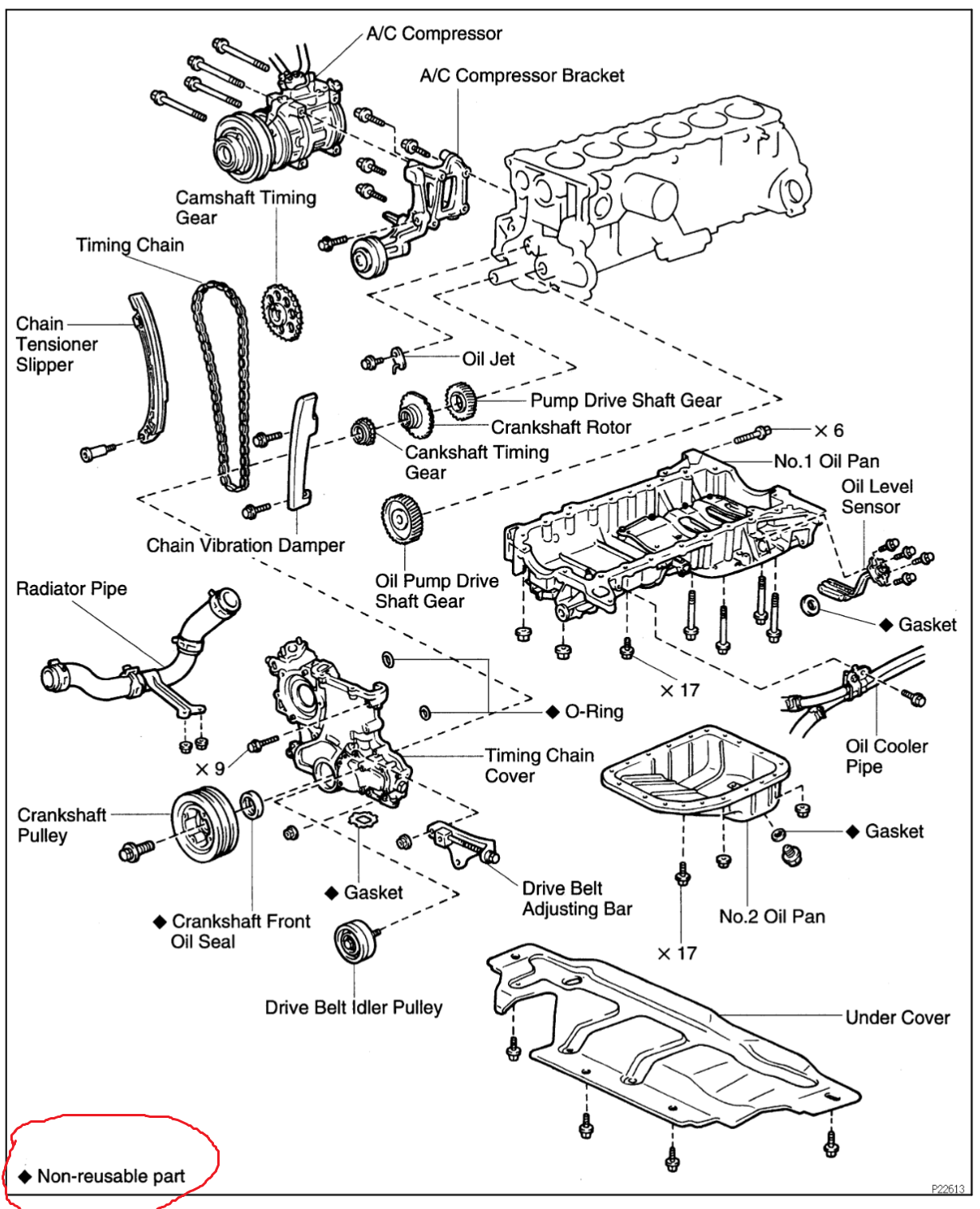

Does the crank bolt need to be replaced each time?
If there's not a black diamond next to the part in the FSM (Factory Service Manual) then according to Toyota that part/fastener can be reused assuming no obvious damage.

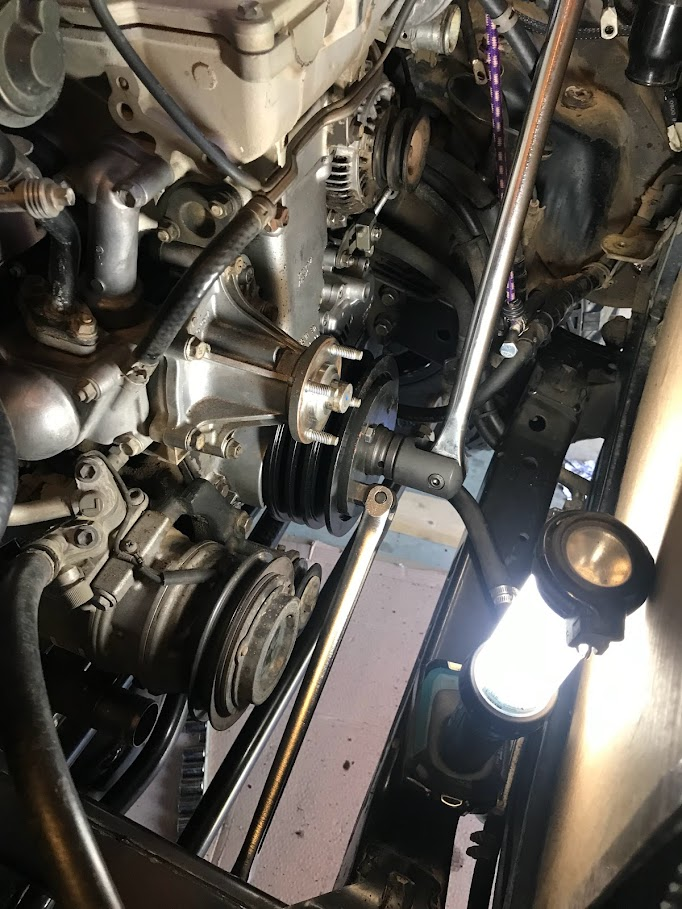

I might be nuts but I replaced my crank bolt, It took more than 800 Lbs to loosen my crank bolt. I had to use a torque multiplier to remove the crank bolt, the torque multiplier + crank holder with tool (with welded on brace) made it a piece of cake (once I finally used the multiplier) bump start failed, Milwaukee impact failed.

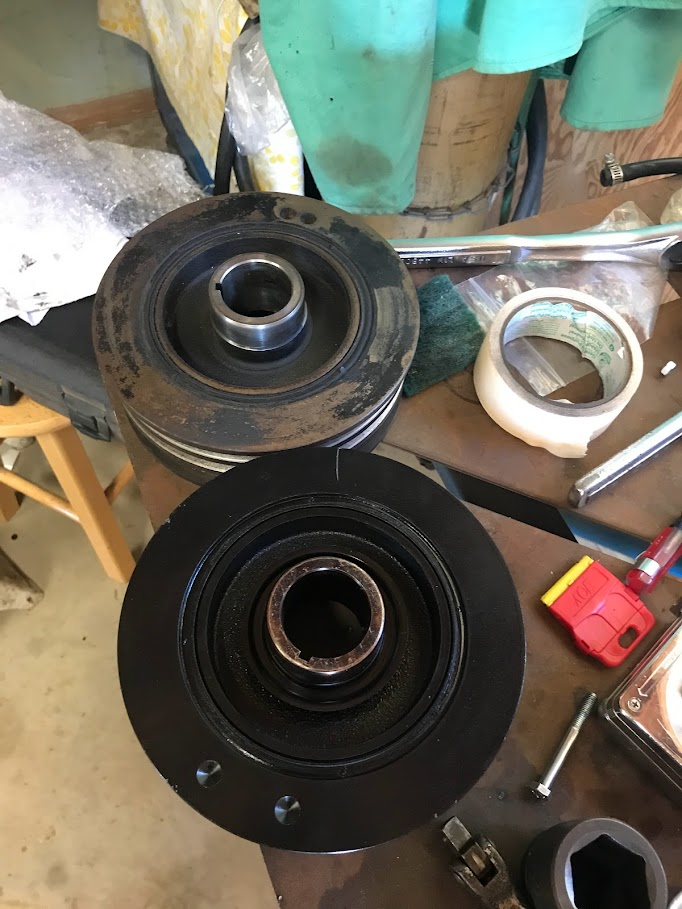

I also replaced my Crank Pulley, Crank Pulley technically only has a 10 year working lifespan due to the vulcanized rubber (its science look it up) but you wont find that in a service manual

CPA crank tool with a 1/2" breaker bar to hold it & a 3/4" x 40" long breaker on the socket/bolt made it easy

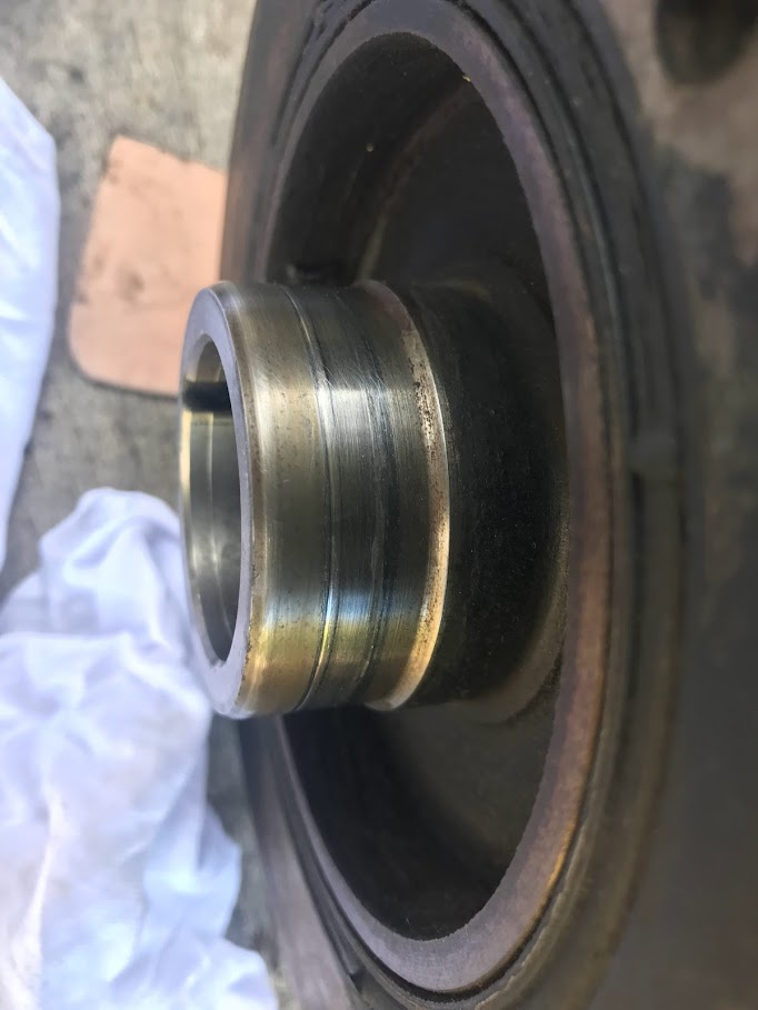

I replaced harmonic balancer because of wear on the seal surface

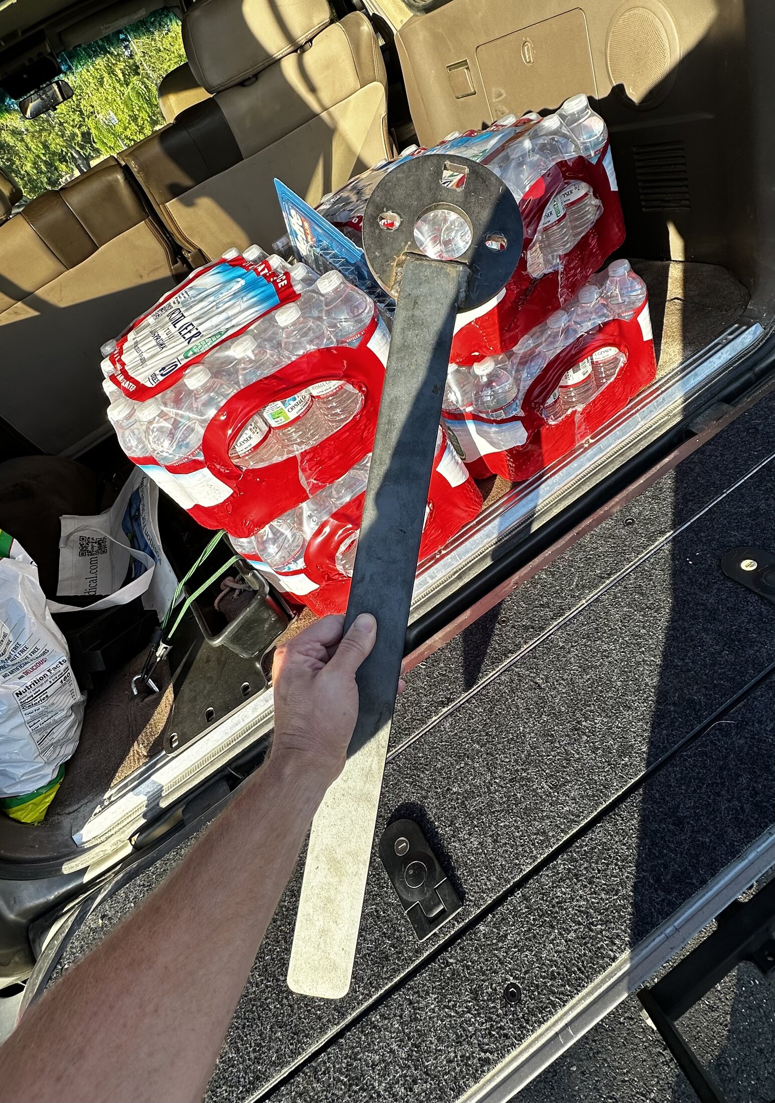

Anyone who is looking at this and wants the crank bolt removal tool, just DM me and we can work it out for you to borrow mine and pay me a deposit of the price of the tool (obviously to be returned once I get it back, so you just pay shipping both ways). It's just sitting in a drawer. I would rather have it used more than just sit. Cheers. I owe Mud a lot more than that.
I have looked over the FSM a few times looking and I must not have seen this. I am new to the land cruiser and the FSM. Thanks for the help.
