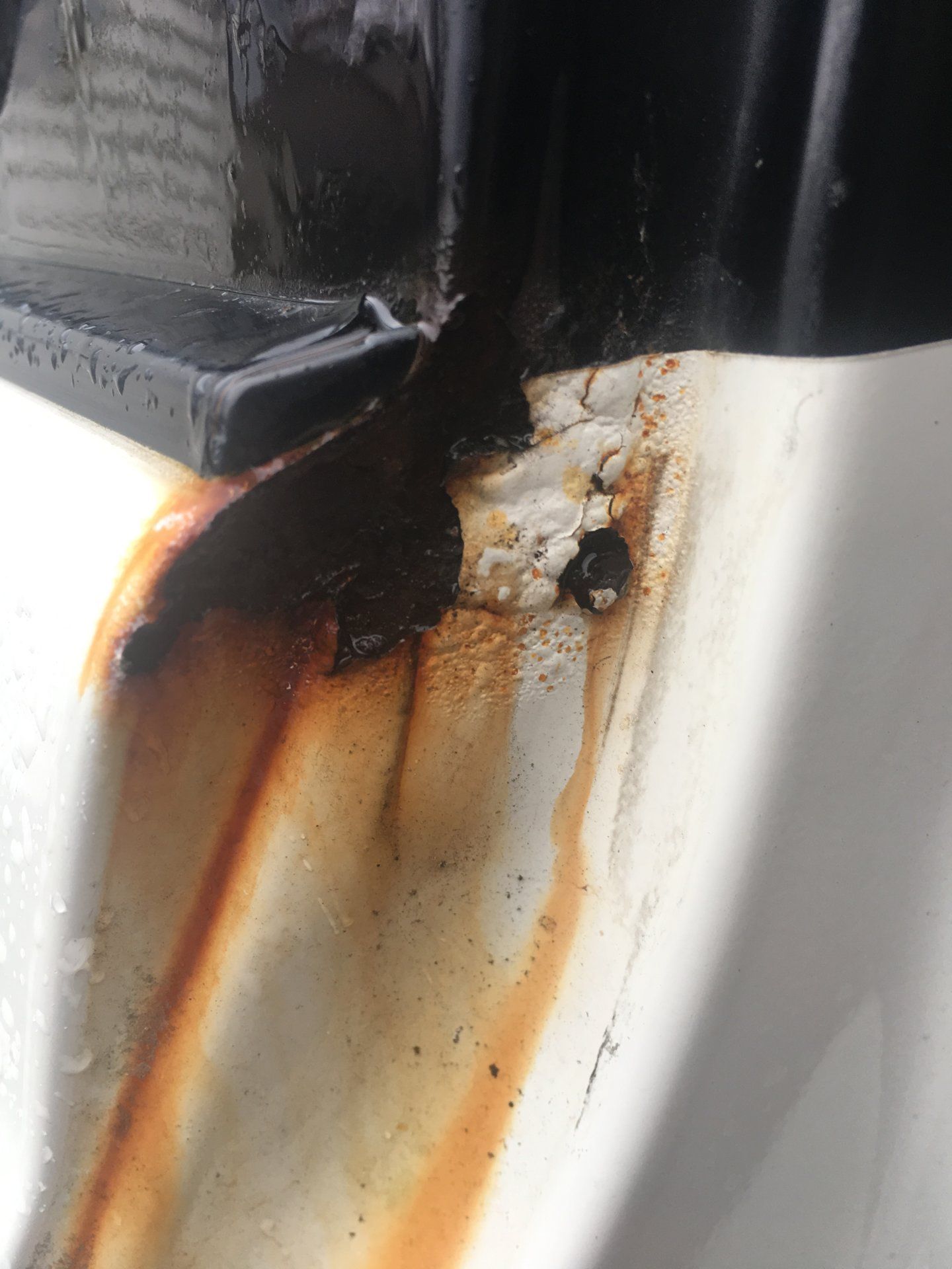

Cracking in "C" pillars
I would just treat area with a rust converter (Ospho) and cover with a sealant (Sikaflex)
I have one side with a crack.. its been there for over 20 years as far as I know.. if it has not gone catastrophic yet.. it wont!
I would like to add stop drilling the ends of the crack as well as rust reformer and some type of seal up.
Just checked mine. Sliver of a paint crack on one side. Same sliver, but with a little bit of rust showing other side. Going to do what Cruz recommended. Danke.
Went out and checked mine, about a 1/2 inch thin crack on either side with rust inside. Very similar to the pictures above. Will get around to sealing it up eventually. '94, 219k miles
If you have a crack with a little rust don’t neglect it! Next, buy some Ospho....
Remove loose rusted metal and/or sand to expose all possible rust. Paint on Ospho generously on any rusted metal and allow to dry. Repeat. Repair (Silkaflex) and/or prep for painting. Paint.
