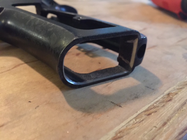

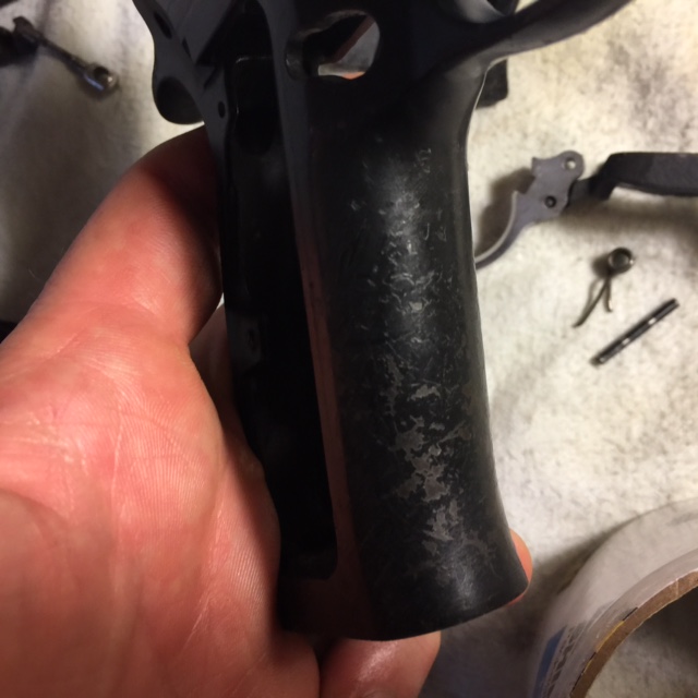

Here's another pic of how pitted the frame was. CZ uses a polymer coat on their guns that is super durable. I have no idea how rough you have to be with a gun to get it to look like this. I've had one with 30k draws on it that looked damn near new.

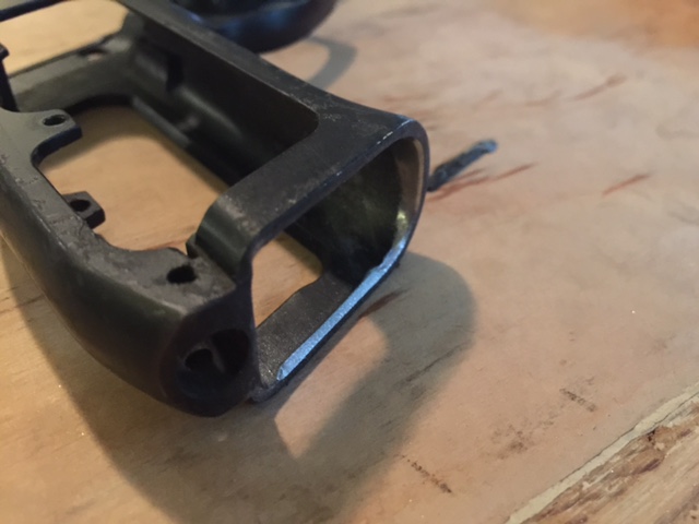

One additional thing that I decided to do while I had it completely stripped down was to bevel the mag well a touch to remove 30 years worth of dents and dings that a mag could hang up on during a reload. So break out the dremel and a steady hand. It definitely makes it a bit more forgiving on speed reloads. But the magwell is still lacking when compared to a factory built Shadow.
