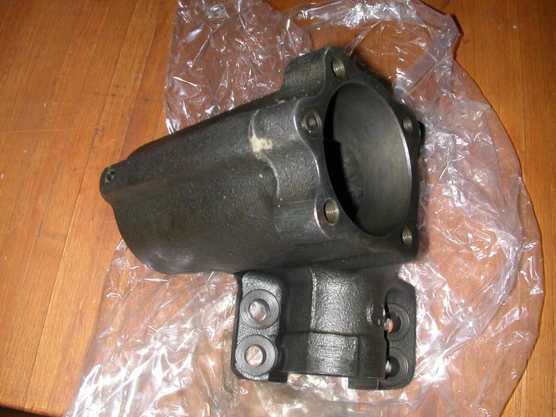

that is a mini truck conversion, it will feel the same as OEM but it uses a bracket to mount the mini truck box at the correct angle.

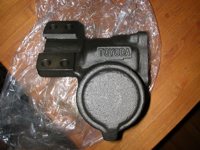

to add value, I would use the new fj40 PS box casting(empty PS box) fill with mini truck guts= OEM fj40 PS. the casting is not cheap...

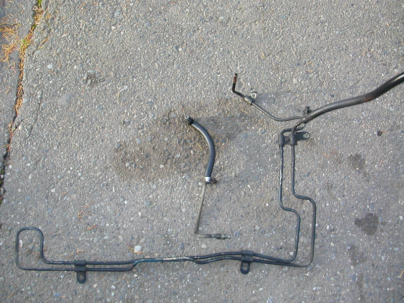

BTW, this is what the factory PS cooler tube looks like, pretty much the same as a fj60, which may be an option of someone really wants the cooler tube...

the 60 cooler tube is similar but it is longer as the frame rails are wider.
I assumed that, but it would probably not take much to modify it to work on a 40.
My 60 cooler tube spung a leak(only rust on a rust free 60) over 10 years ago, under the radiator of course, I cut out the bad part and replaced with some hose. After that....I couldn't see using the oem cooler in the 40, but darn if I'll let it go ;) (maybe if/when I replace the radiator on the 40, I'd consider it again)

In my case I started with an new empty PS housing for a fj40(can still be had), then used solid axle mini truck box for parts for the internal guts of the new box(guts are the same as fj40), OEM PS seal kit(again, same as mini truck) Sent that to Redhead Gear in Seattle to be put together. The new box bolts right in-place of the manual box. The PS pump and bracket(fJ60, same as 40) will bolt up to your 82 2f, new steering rag joint (or whatever its called, not required but I did) Manual steering shaft is cut just a tiny bit. That's really about it. You can get the high pressure hose from NAPA(for $40-ish)
As much as I am a OEM nut, the PS cooler tube is not needed, I used a small trany(or maybe a PS cooler) cooler instead. After I did all this to my 82, I ended up finding 2 factory PS boxes locally, one had the cooler tube......never had the desire to put the tube in, but also not getting rid of it ;)
