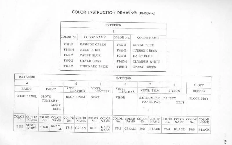

Dash - the ash tray, and the glove box door, should those be color matched to the body, or should they be painted silver?
And, "IF" silver, does anyone know the correct Paint code for the silver and the silver that 'I think' should be on the backs of the seats, the 2 rectangles on each door, and the rear heater. If anyone knows the correct color for those, please let me know.

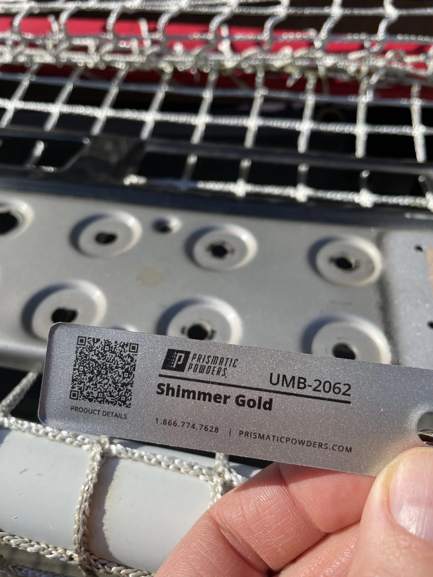

The paint color for Glove Box, ashtray, bumper, bumperetts, outside mirrors, seat frames, etc…is pewter. There is a color code for it. I found when powder coating those components an industrial electrical silver is a pretty close match.
Engine is easy…..black on black….any quality engine enamel will get you there…I also powder coated my valve cover, oil pan, lifter cover, timing cover, flywheel tin, splash guards, etc… in black. It makes it so easy to clean…..
⬆️ what @Mark Jennings said, Hood latches should be body color. Heater is grey or black depending on year too, Gauge cluster, outside/inside mirrors-pewter.
depending on year, back of seats are black or early years are pewter.

Can anyone give me the correct Paint code for the "Pewter" color?
Have you looked in the paint and body section. There's usually discussions going on in there about the different colors that could be pewter, along with the color of the bezel and top.
Nice looking bike.
I can't remember what year your rig is but up until mid-67, the "silver" had a bit of gold color to it and some metalic. There is a Toyota paint code but no one could use that when I was looking. I can grab a pic of the mix code if you need that older color. I took an example piece to the paint shop and had some mixed up.
Otherwise I've heard that Rust-Oleom pewter is pretty damn close to the later color.

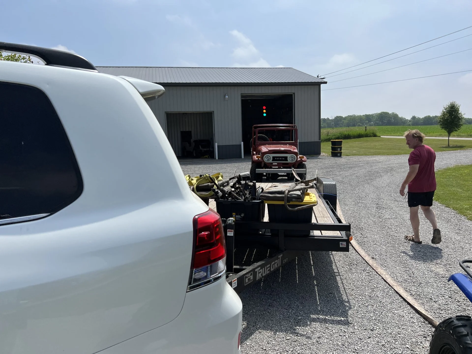

I appreciate everybody's help and input. One more quick question, from the factory if it was, for example, Freeborn red, was the entire engine bay and firewall painted red as well, or black, or did they spray the front inner fenders red and paint the firewall black?
Yep. The whole thing was sprayed top color. Even the underside.
