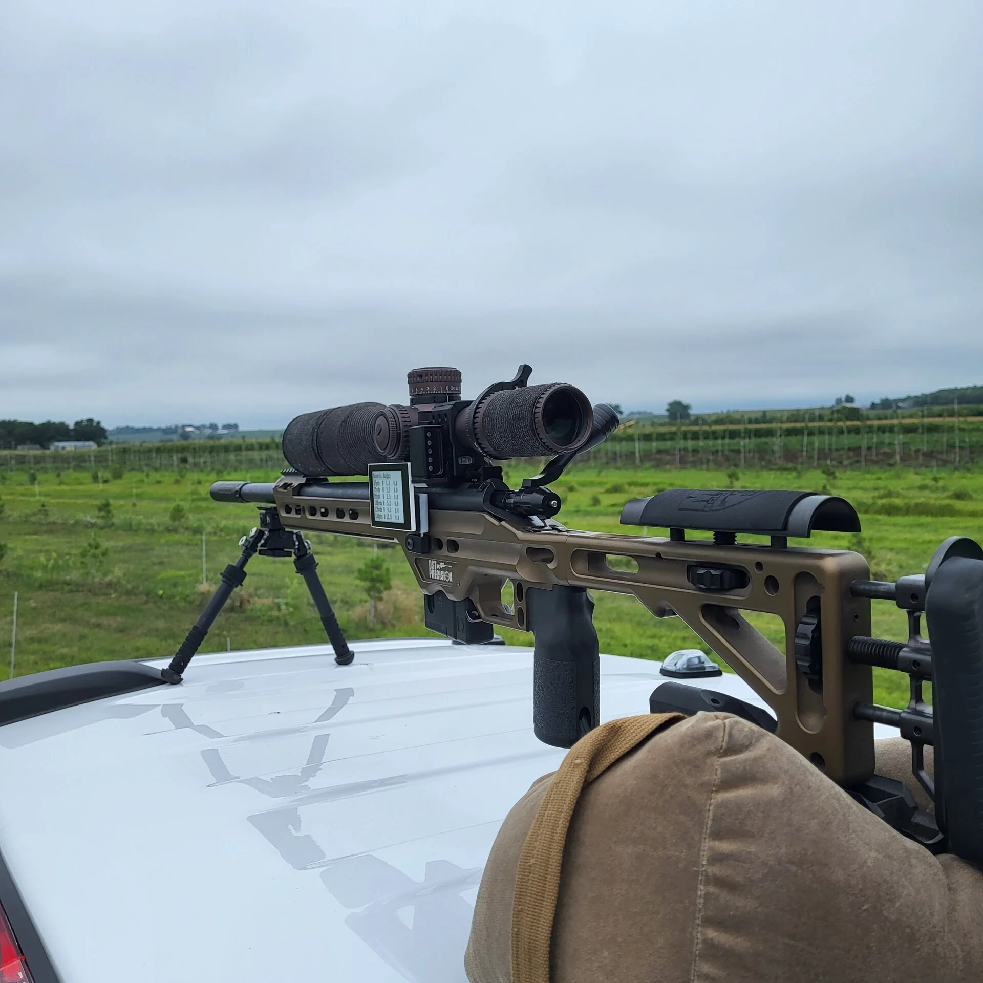

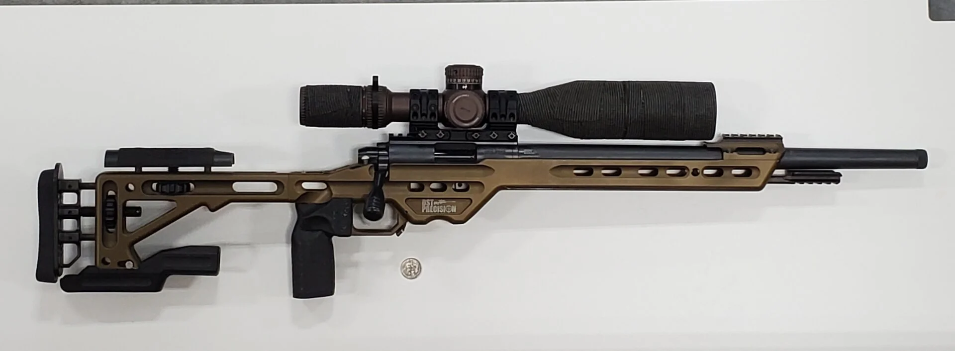

BTW - love Cerakote on my firearms. Use on my AR platforms, pistols, and barreled actions of some of my bolt actions. I'm going to refinish my rear door handle with Graphite black as a starting point and then hit the heater blower motor and internal heater. My friend does high end custom BBQ pits, he's getting ready to finish one in Cerakote.
Cerakote got back to me and said extending the cure time to 2 hours and lowering to 300 F would work.
That's the only reason I have any experience with it. It's a really durable option.
