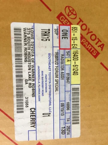

I received a BIG box from Onur over at Lowes Toyota. It contained my brand new OEM radiator and numerous water hoses (3FE kit maybe?). I ordered a new fan clutch, thermostat and radiator cap as well. I looked into the CSF radiators but could not find one for less than $300. For about 10% more, I went OEM. I figured the original lasted 21 years so why mess with success.

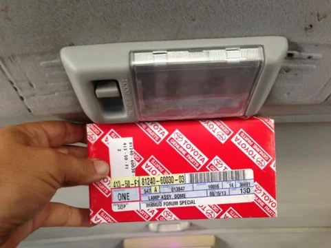

Along with these items, I ordered a new dome light to replace the disc player the PO had installed and I uninstalled. I went ahead and put it in today.
