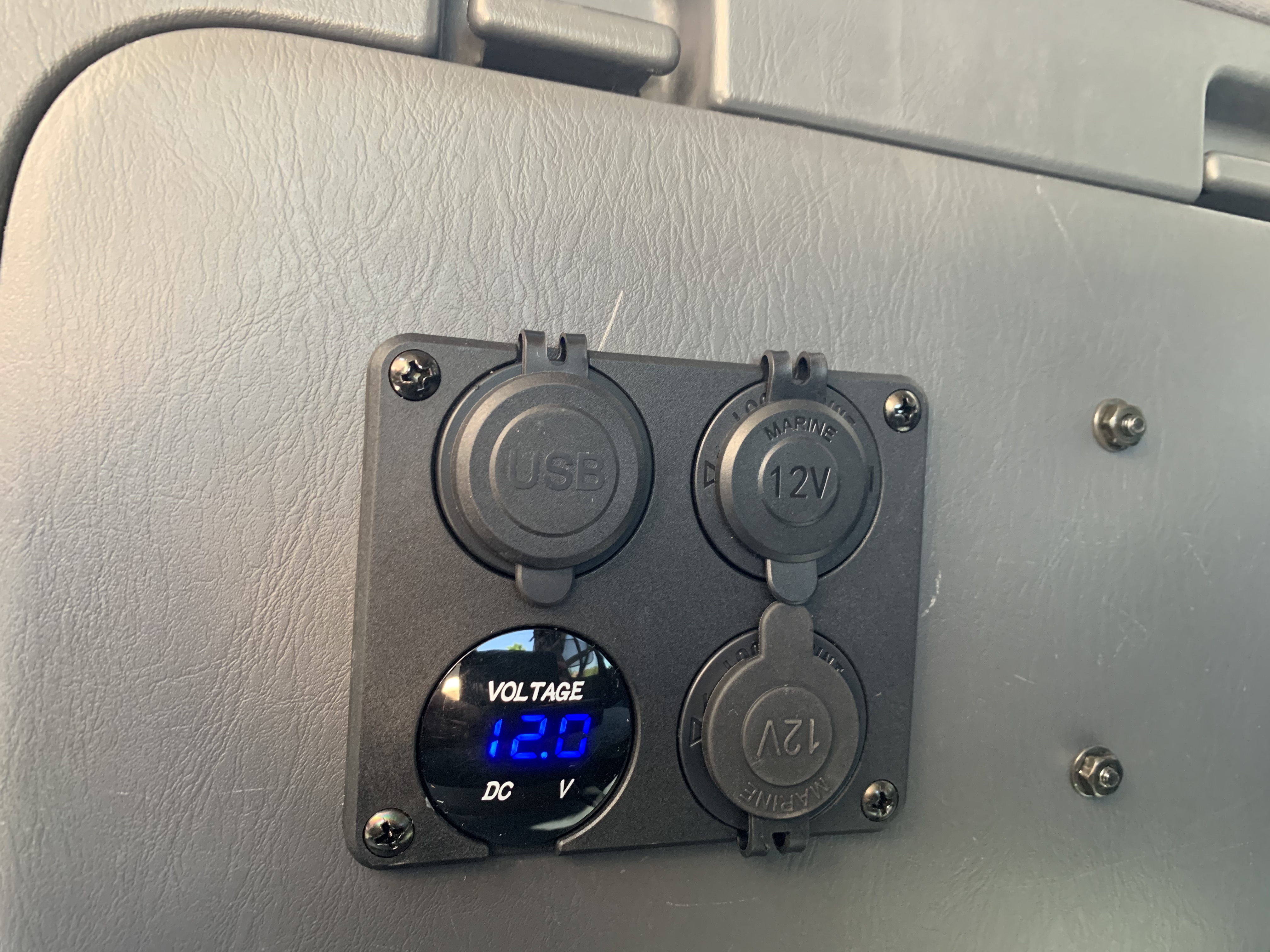

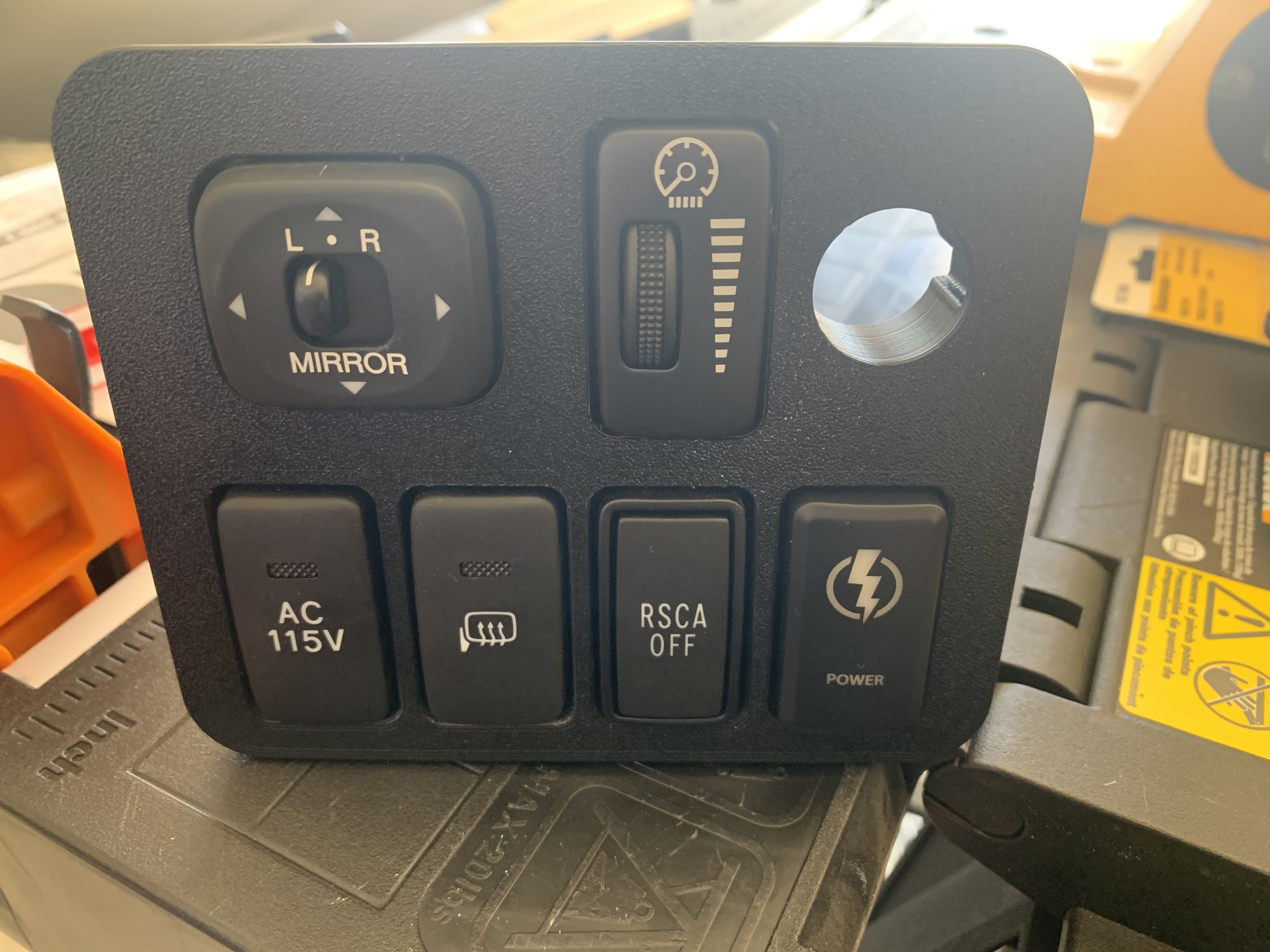

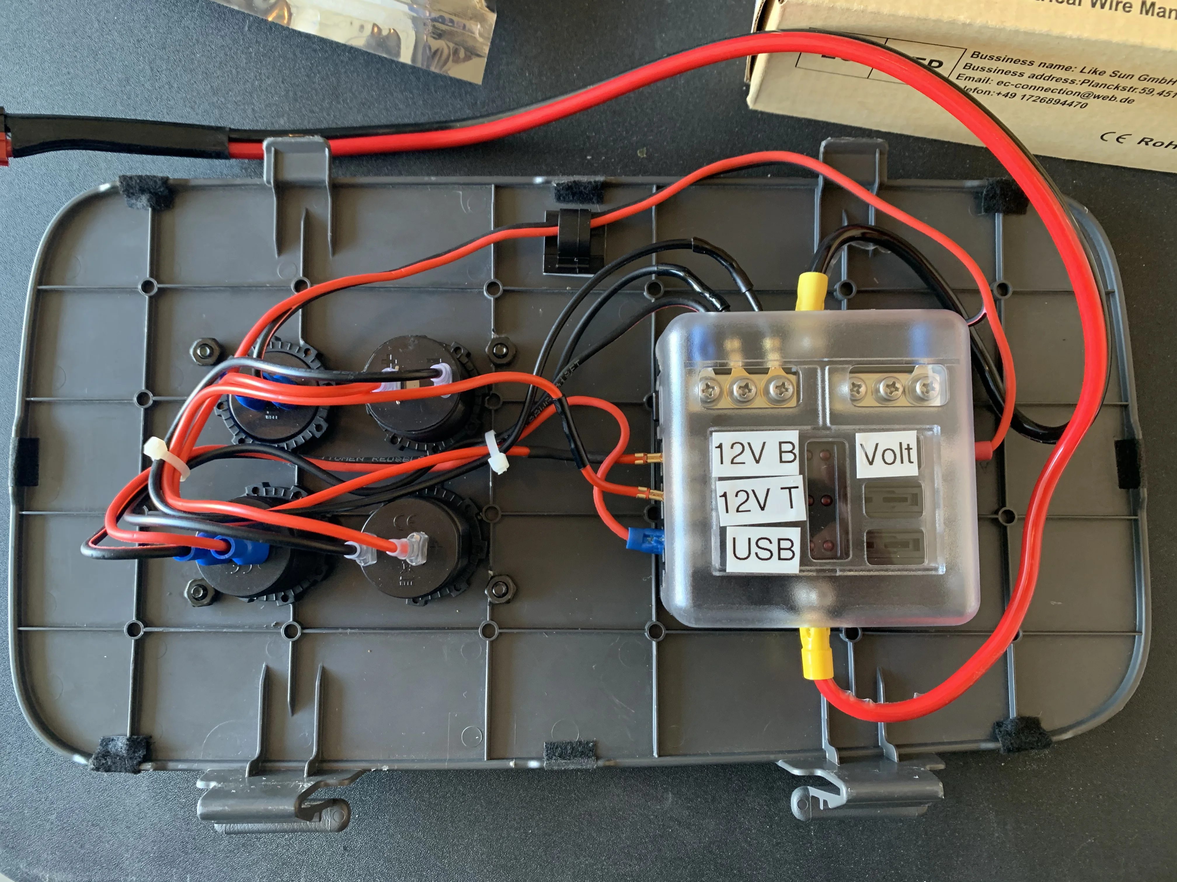

On my previous overnight camp with my son the Flexopower was dead. I'm not sure why as I thought it was plugged in the house, but that killed using the fridge and we had to last minute go get some ice and use a cooler. That bumped rear power delivery to the top of my list. I did a bunch of research and had some parts already, but not all.

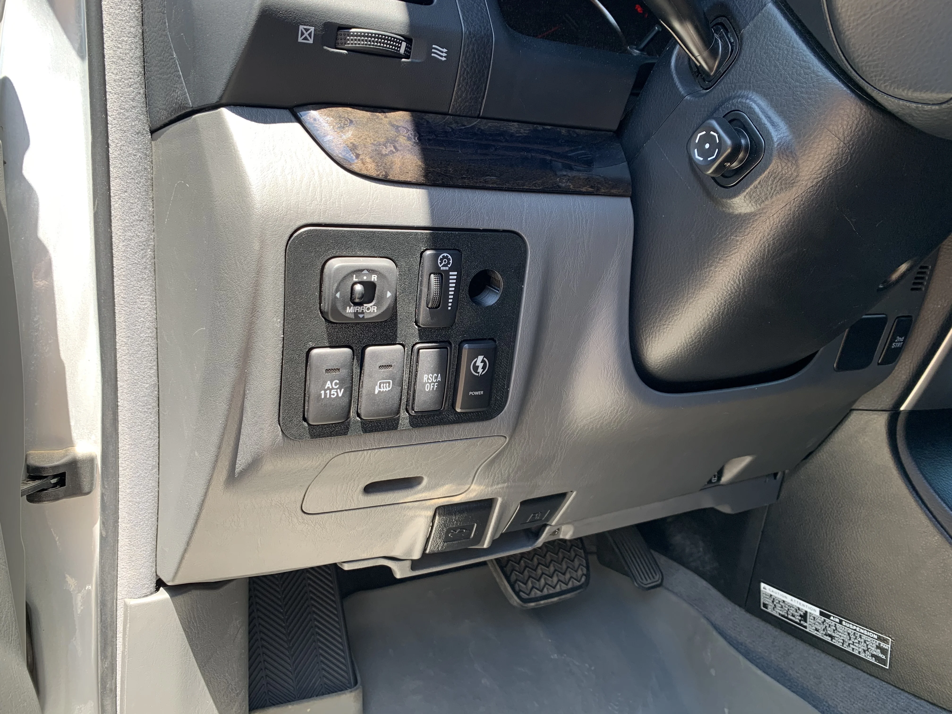

I used a mirror switch panel from Steve Berson (SBE PRECISION PRODUCTS – The Leaders In Followers - https://sbeprecision.com) that is made for the LRA aux tank and one additional switch. My LRA install is scheduled for August. I made the power switchable just in case I noticed a battery drain while driving. Plus it required me to go ahead and set up my aux fuse panel which I will need for any future accessories. I went with the Overland Equipped 4th Gen 4Runner panel and it needed some minor re-shaping to fit in the back section. Now I can power the fridge directly from the GX, but I can also charge the Flexopower at the same time.

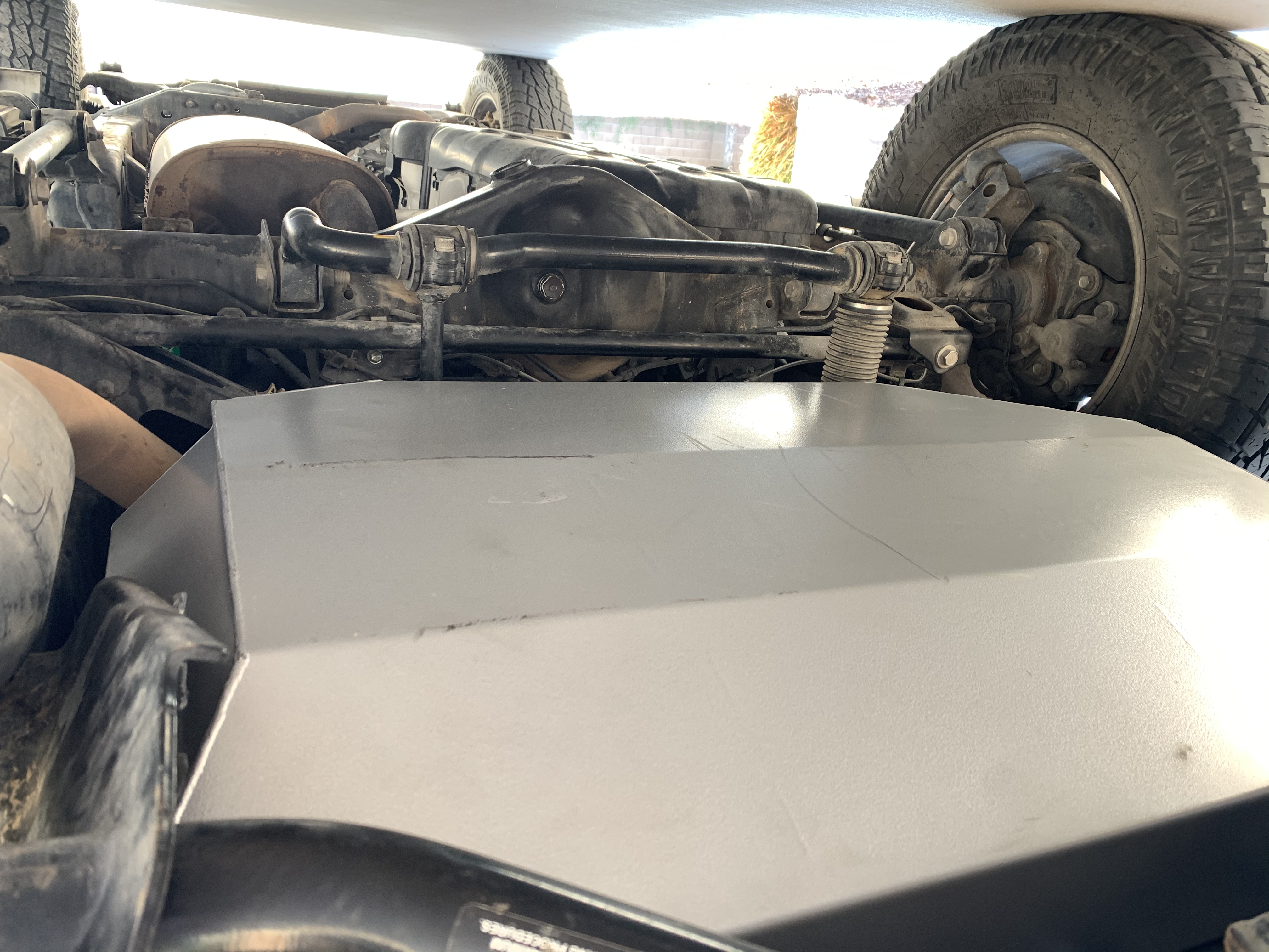

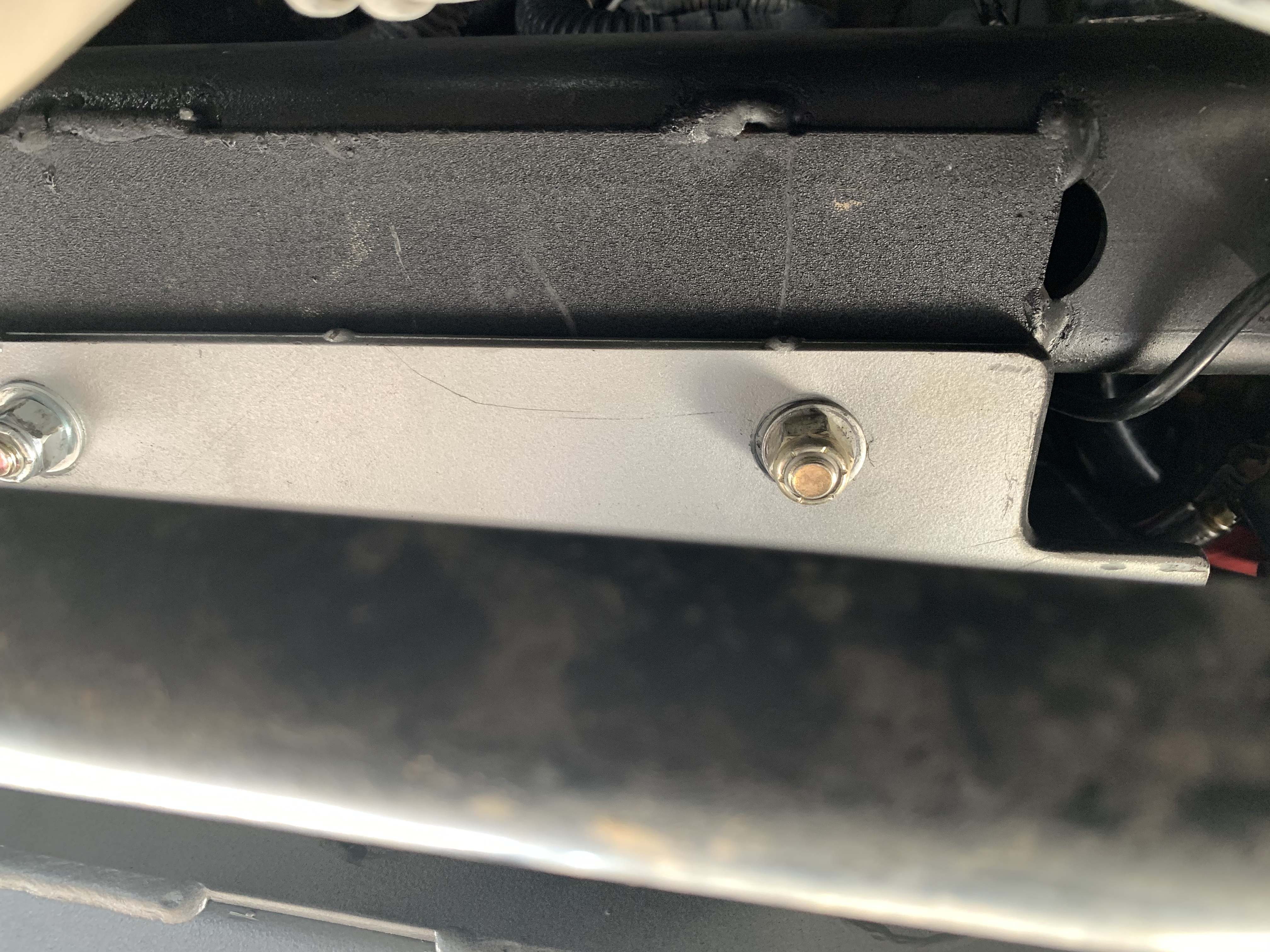

I got my GX back from Ben at Arizona Toy Pros in Mesa, AZ. We had several conversations over the last couple of weeks and he was on the phone with LRA about my 24 gal aux tank. Word is that they re-designed the tank to fit KDSS for the 5th Gen 4Runner, but it didn't exactly line up with the 470 with air suspension, KDSS and OEM hitch as expected. He had to cut a bit of the hitch out, re-drill some mounting holes and weld on an extension plate for mounting. He also put some new Arnott air springs in since my complete Lexus service history prior to my ownership never showed any air spring replacement. Unfortunately since the install took a lot longer than expected he wasn't able to get to my Becky install. I'll have to do that on my own now.

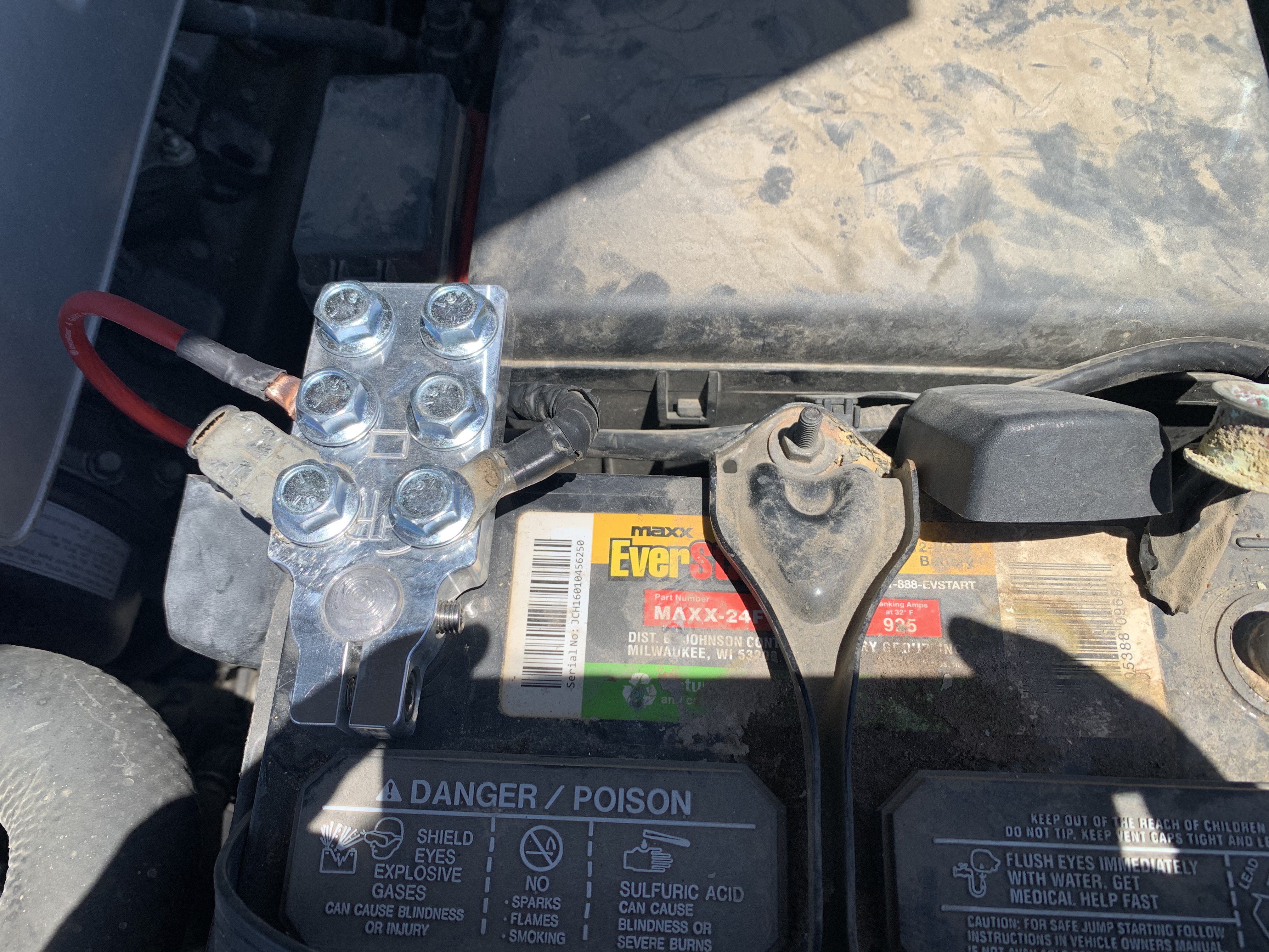

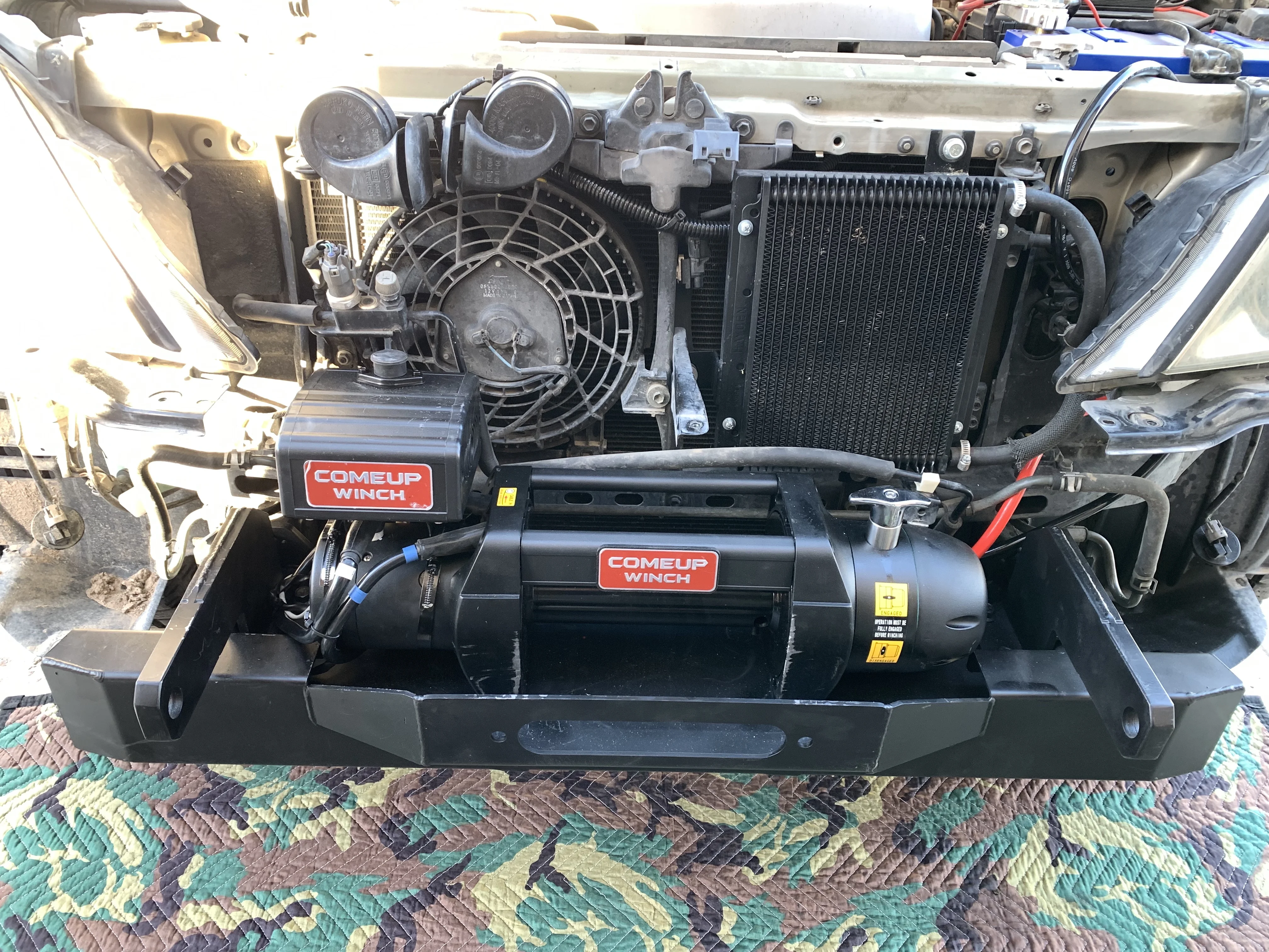

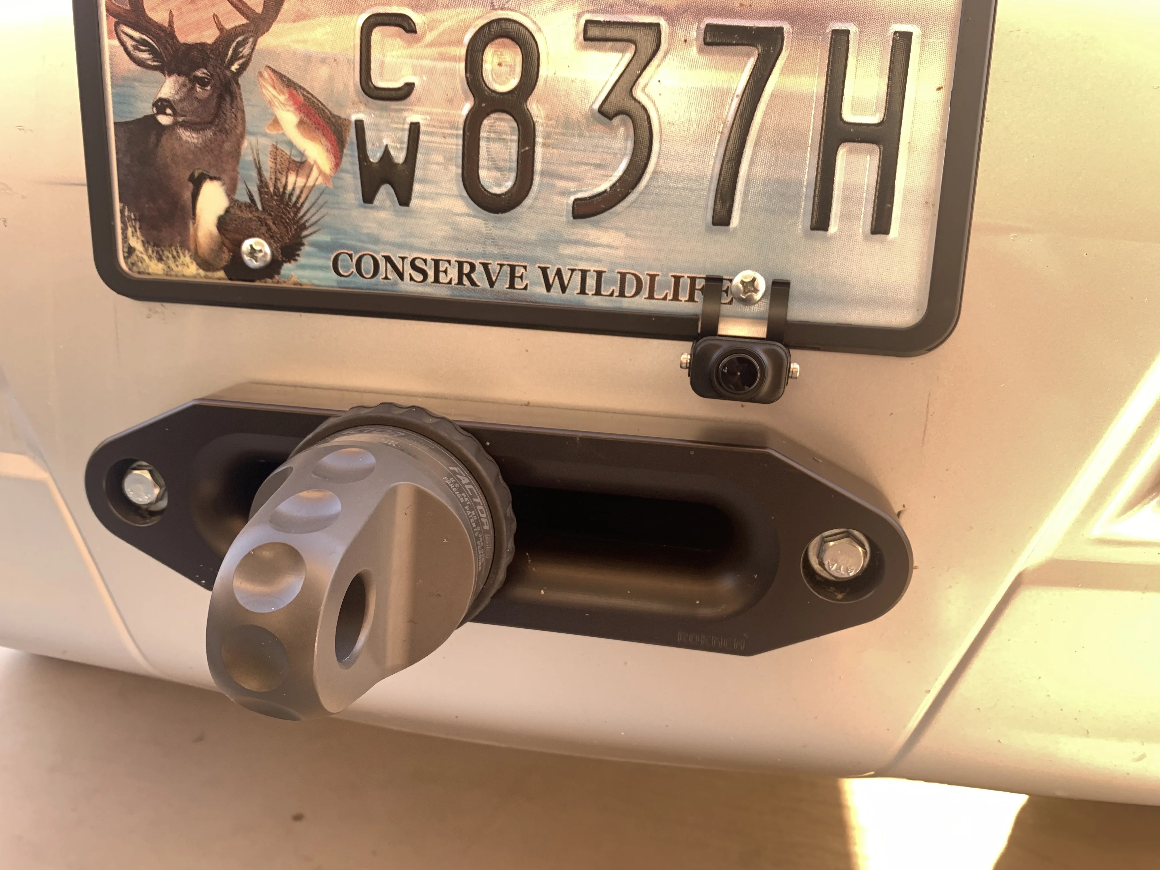

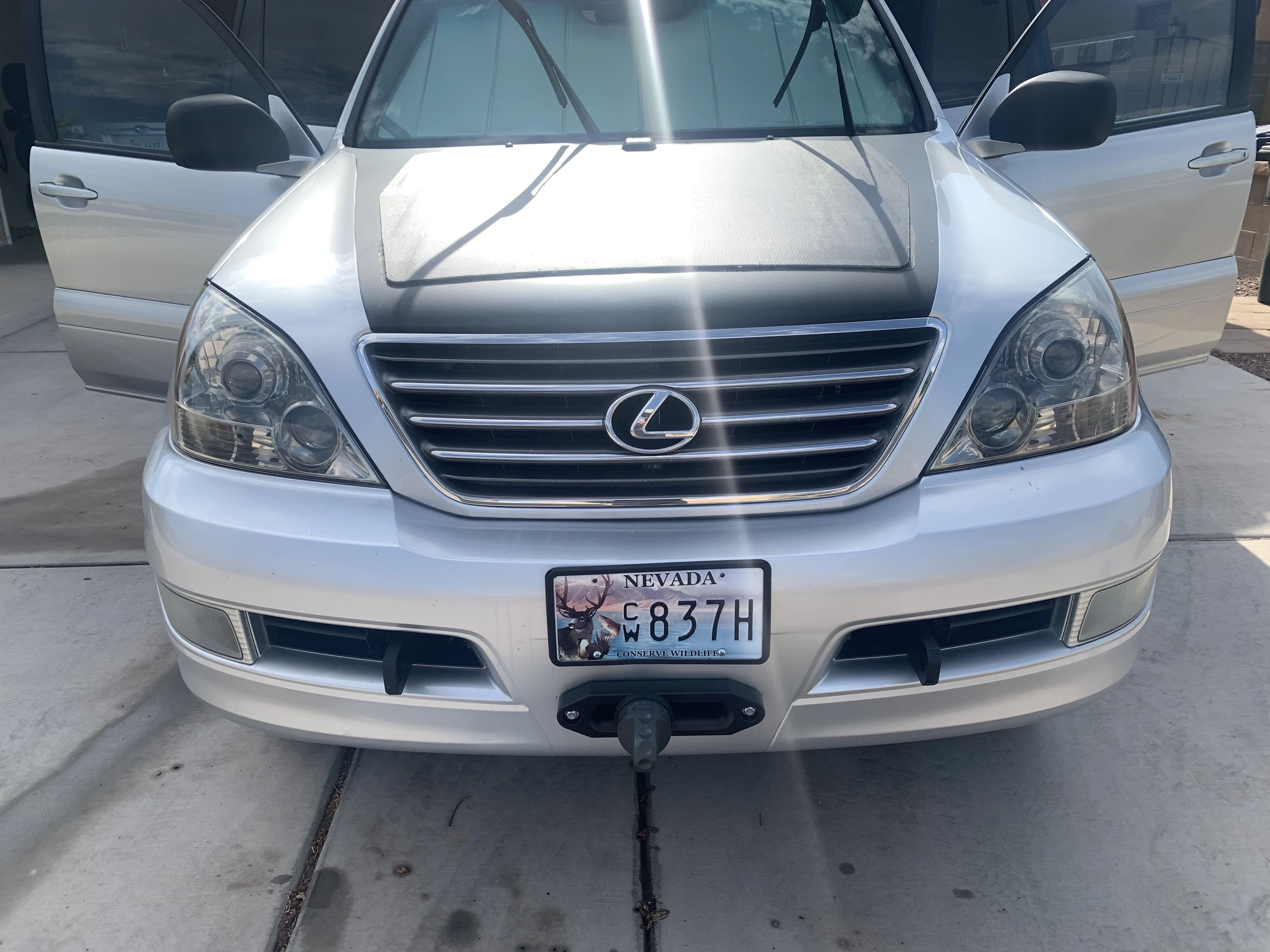

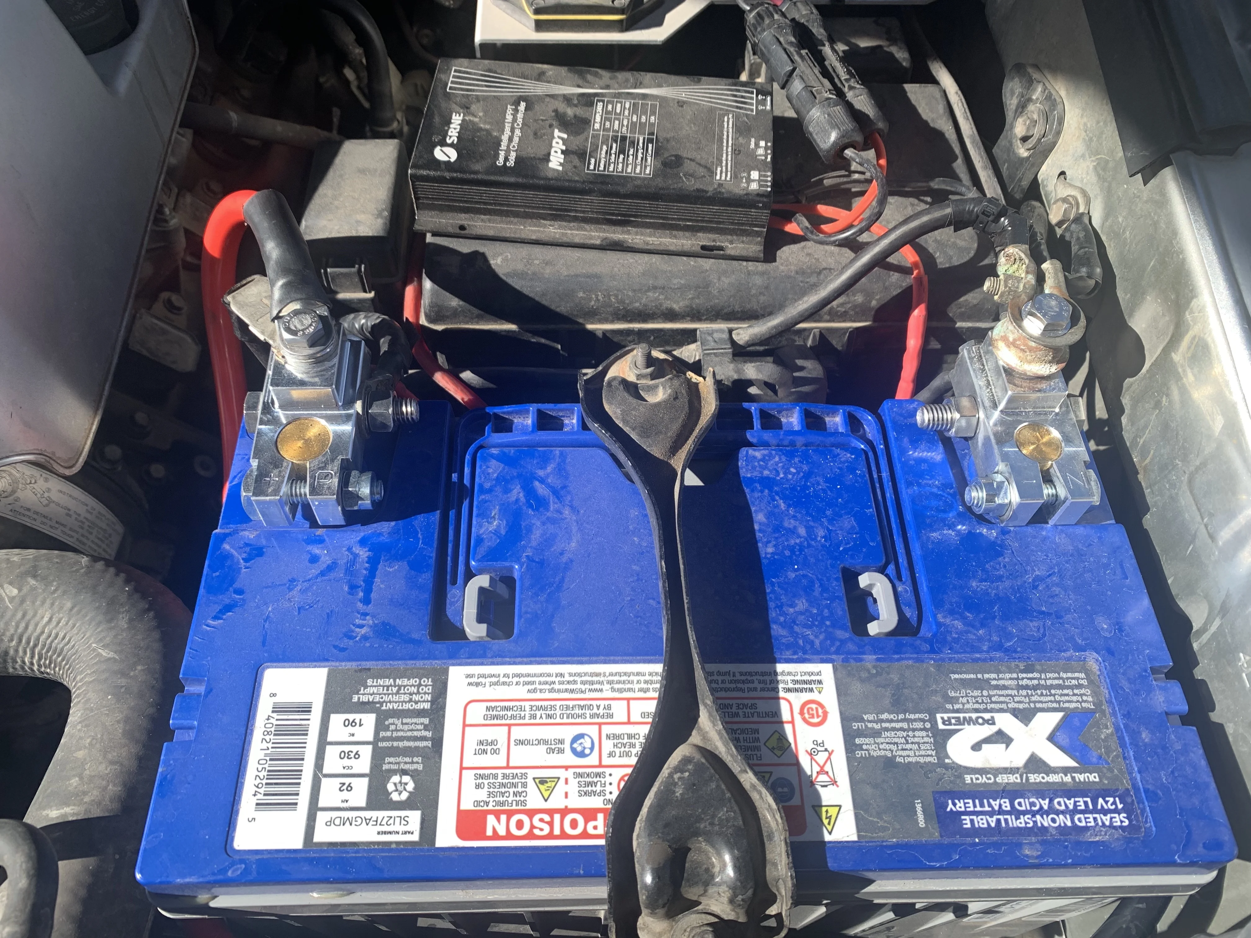

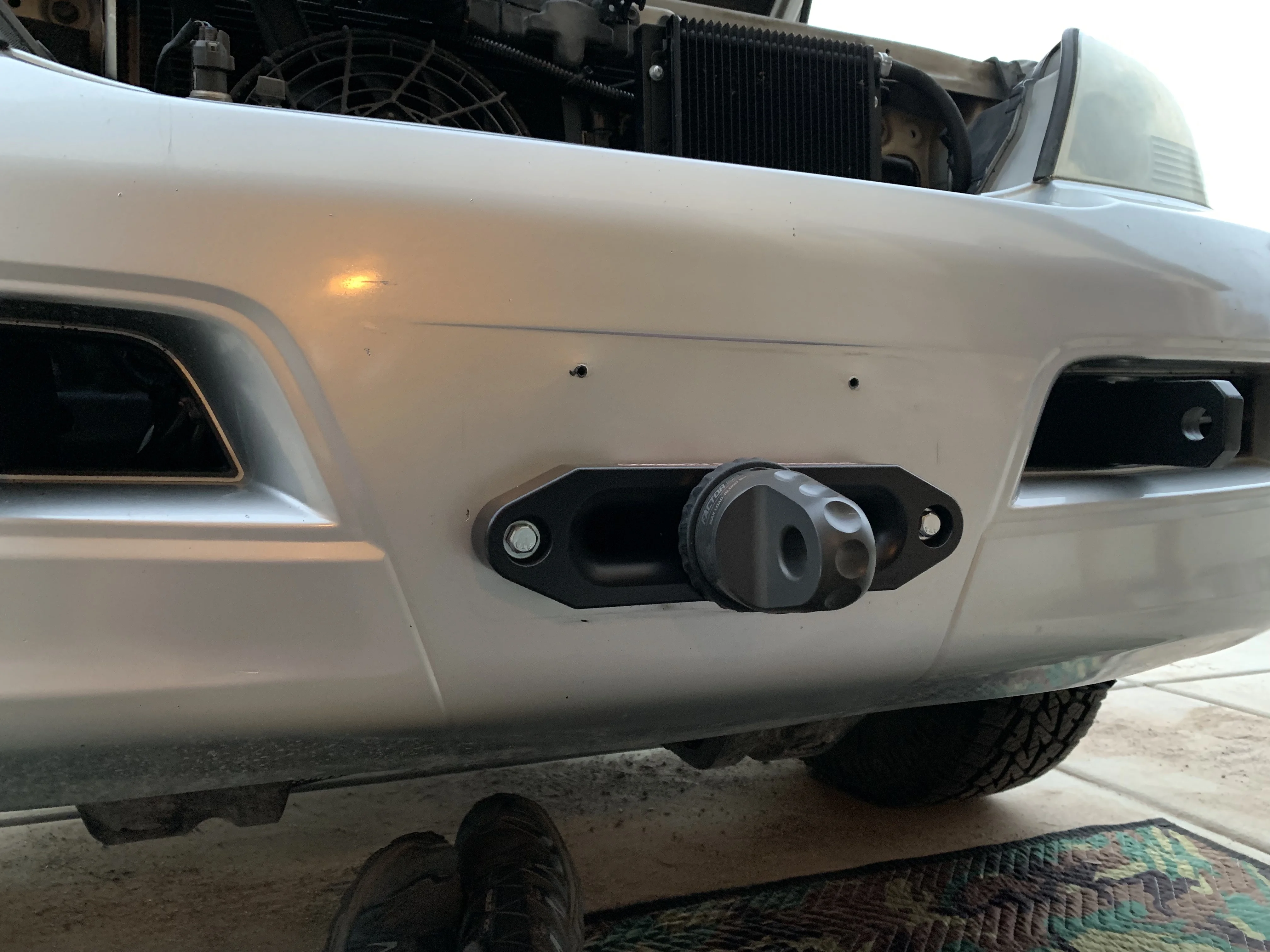

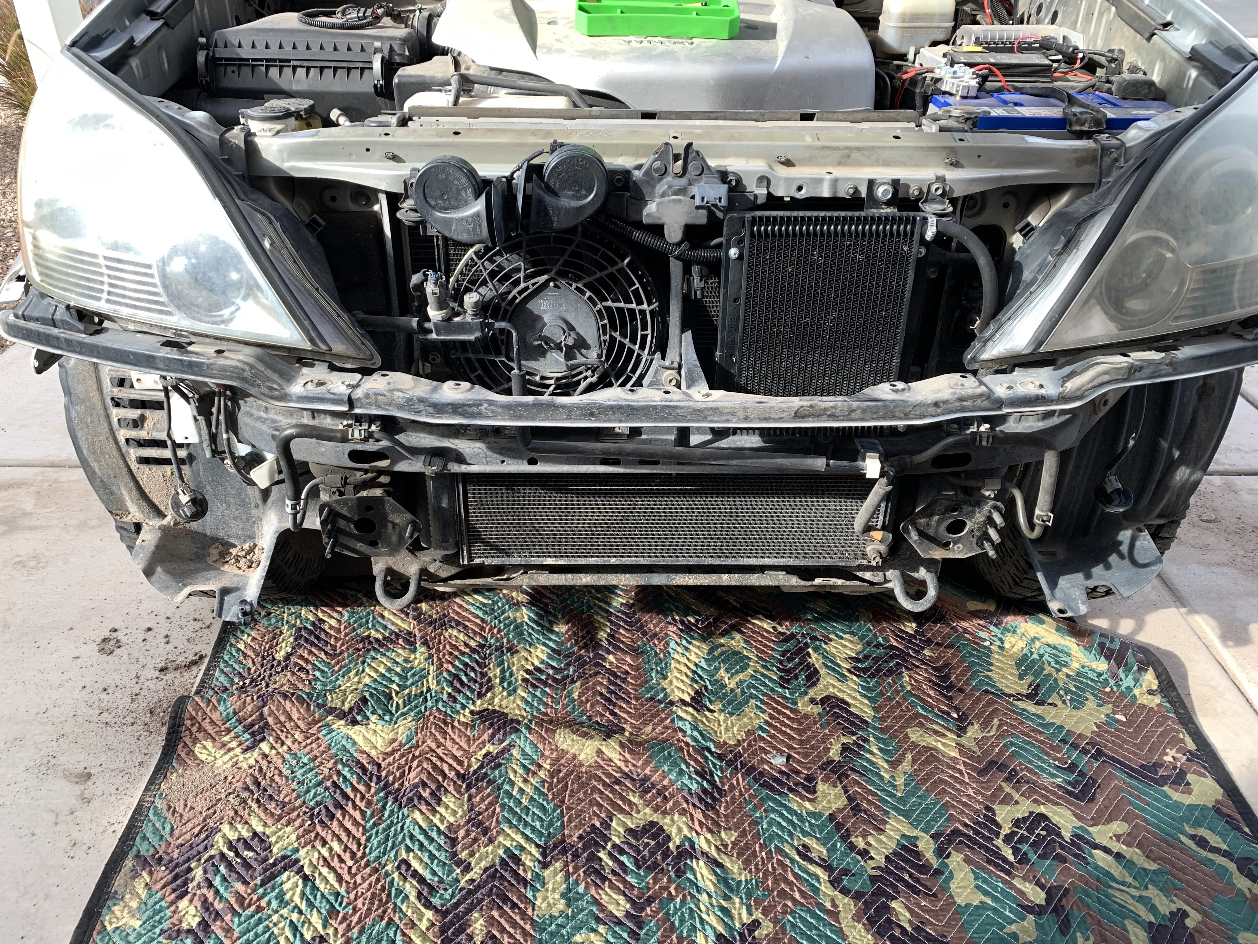

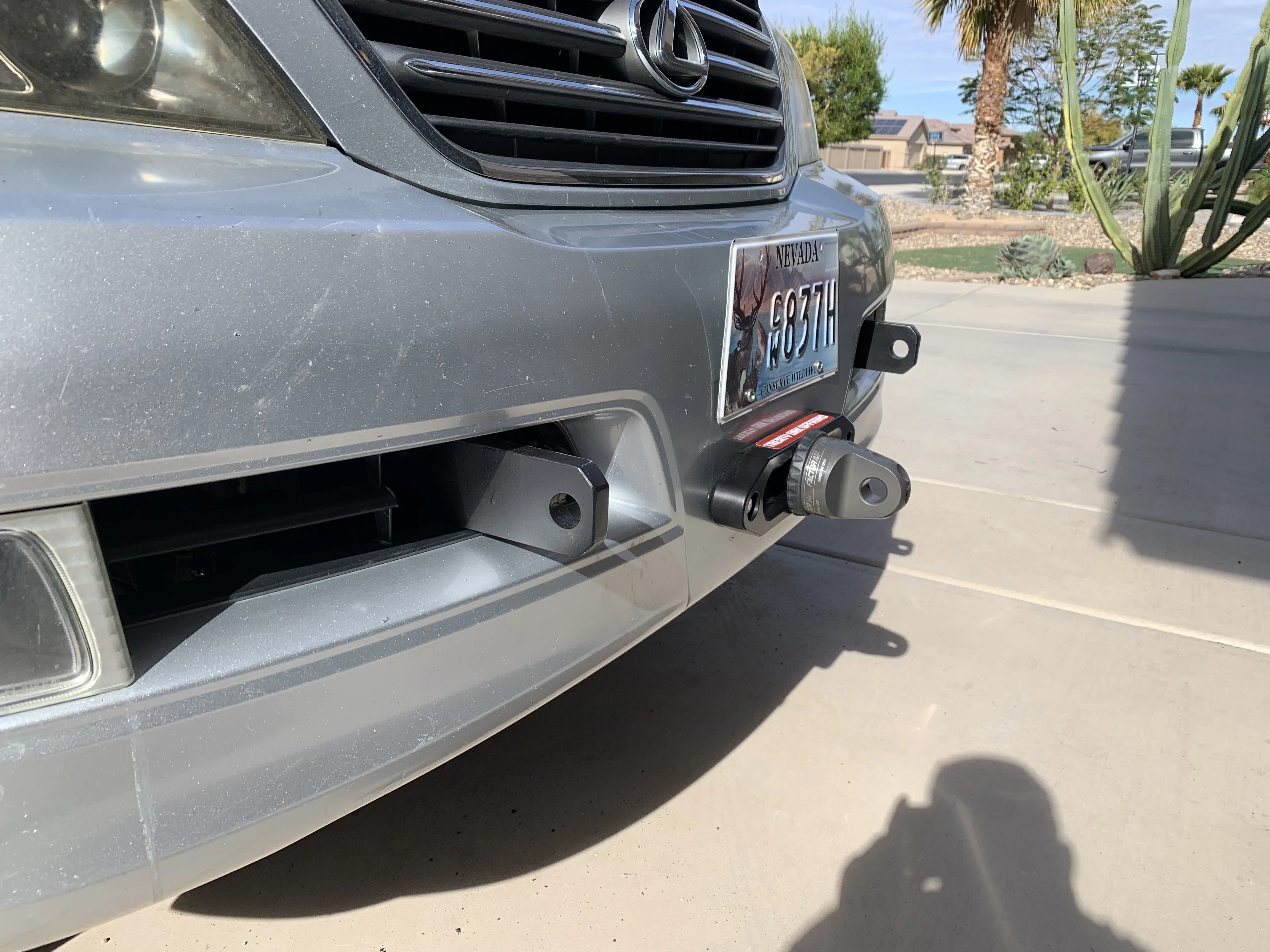

Been a while. Turns out the Becky won't work with my LRA tank. I can't say it won't work with other LRA installs, but since mine was modified to slide back some for KDSS, the LRA tank and the bottom support for the Becky were competing for space. That got tabled for a while and I finally got around to installing my hidden winch and upgrading my battery terminals. Fitting that control box in there was a PITA! I went with a ComeUp 9.5 package from Treaty Oak Off Road on the Southern Style Off Road Incognito mount with recovery points.

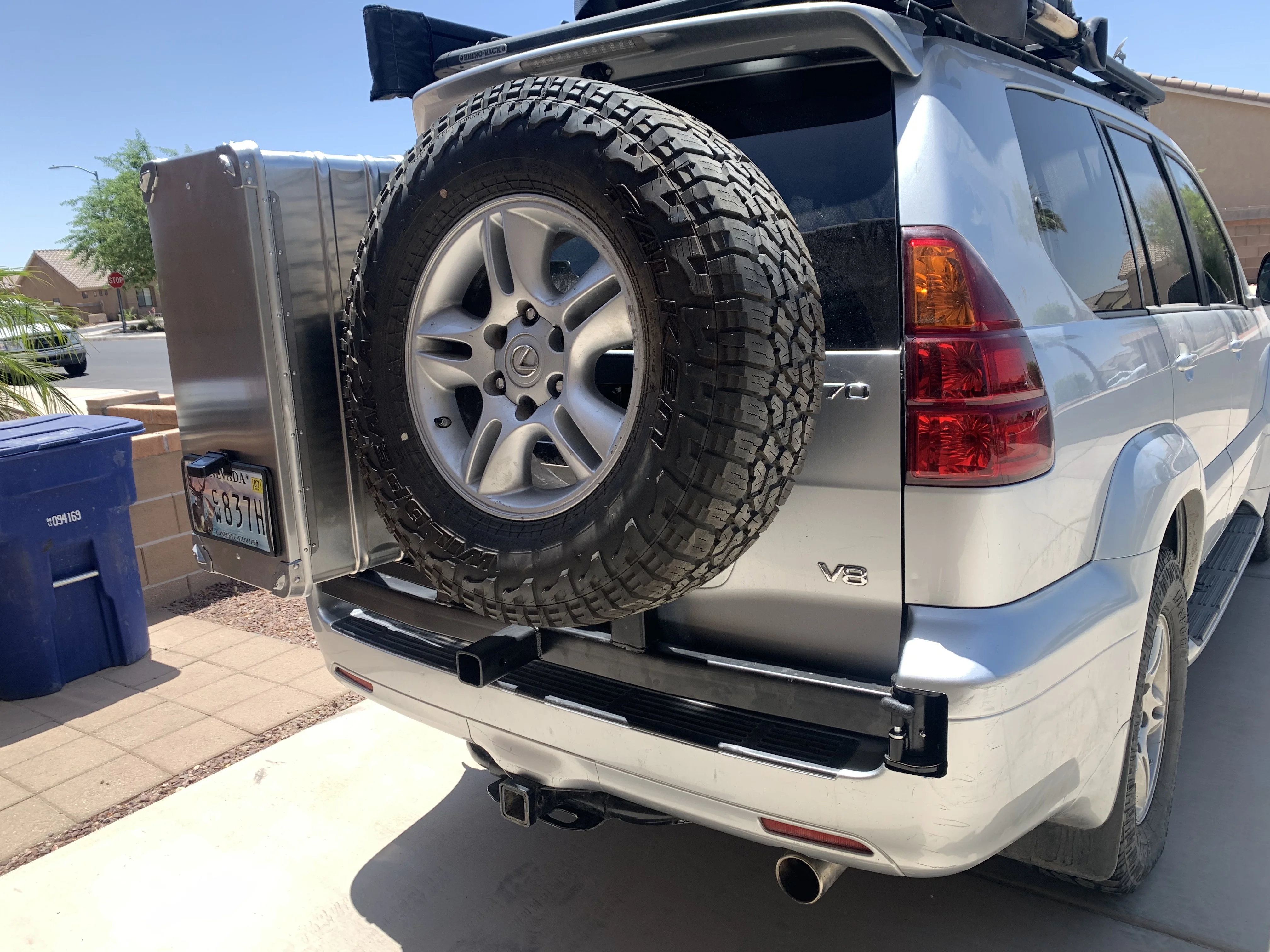

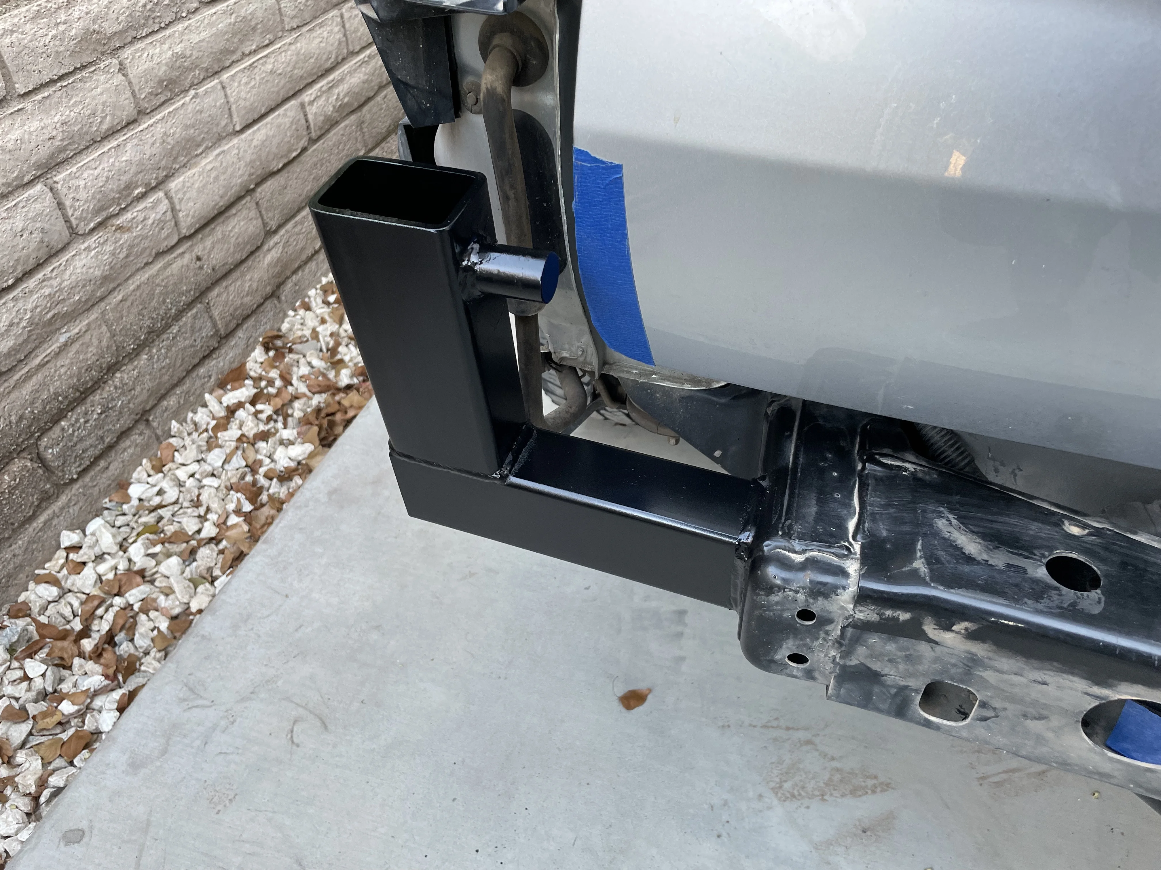

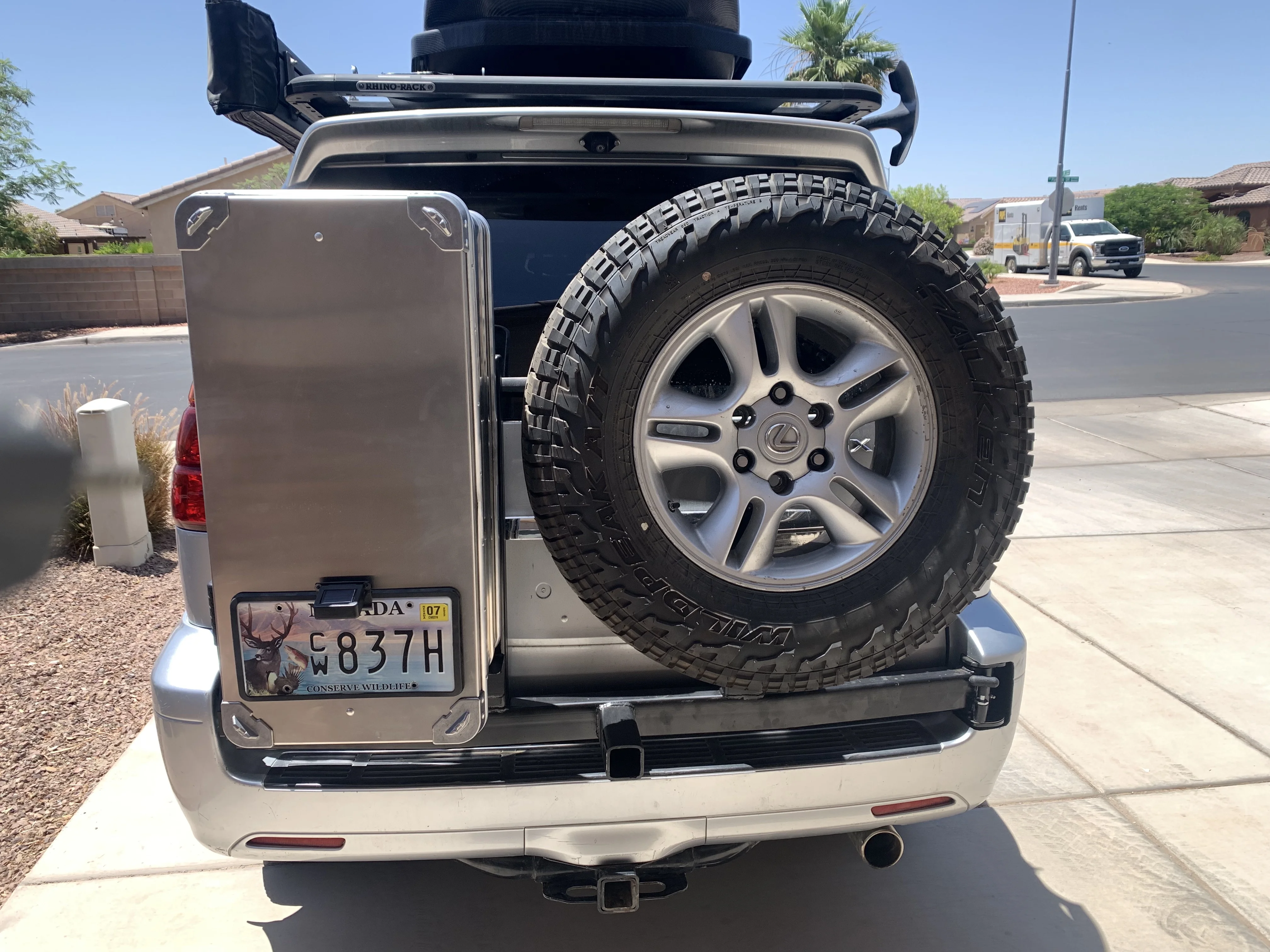

I had a few trips planned so I really wanted to get my spare tire situation figured out. I went to one of the airframe mechanics in the squadron; word was he did side welding/fab projects. We talked it out and I showed him pictures from a similar build I found online. He had never done a tire carrier before, but he literally welds on airplanes for a living so I know he knows what he is doing. It was a totally custom job and it came out great! The mounting points are welded to the rear cross member.
A lot of people with similar swing outs put jerry cans opposite the tire, but with the LRA tank I didn't need EVEN more gas. I decided to take a cue from Chris Cordes's previous Excursion with the Alu-Box to hold some gear. We also added a 2" receiver so I could add a bike rack or cargo carrier and they would be swing out as well.

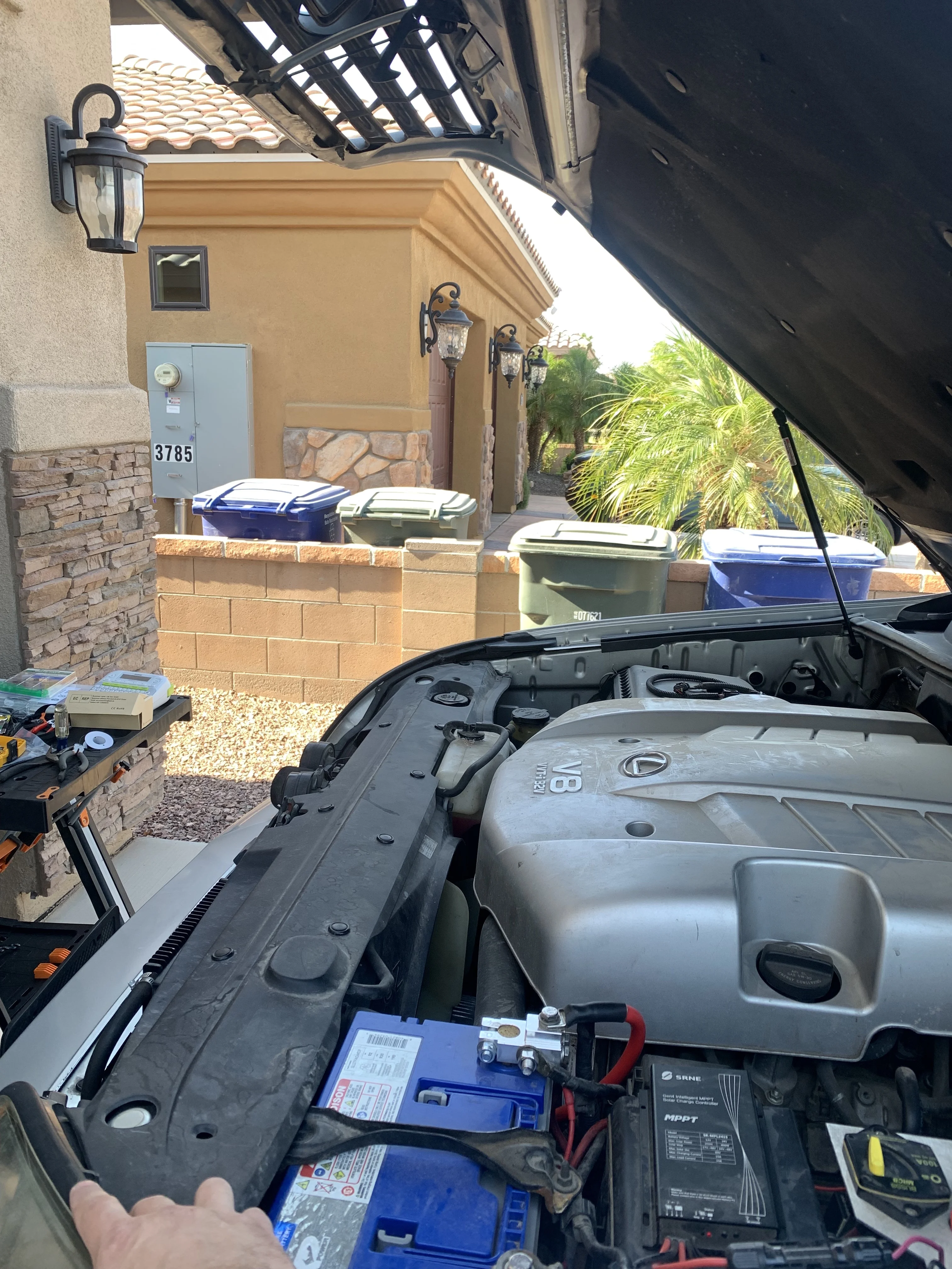

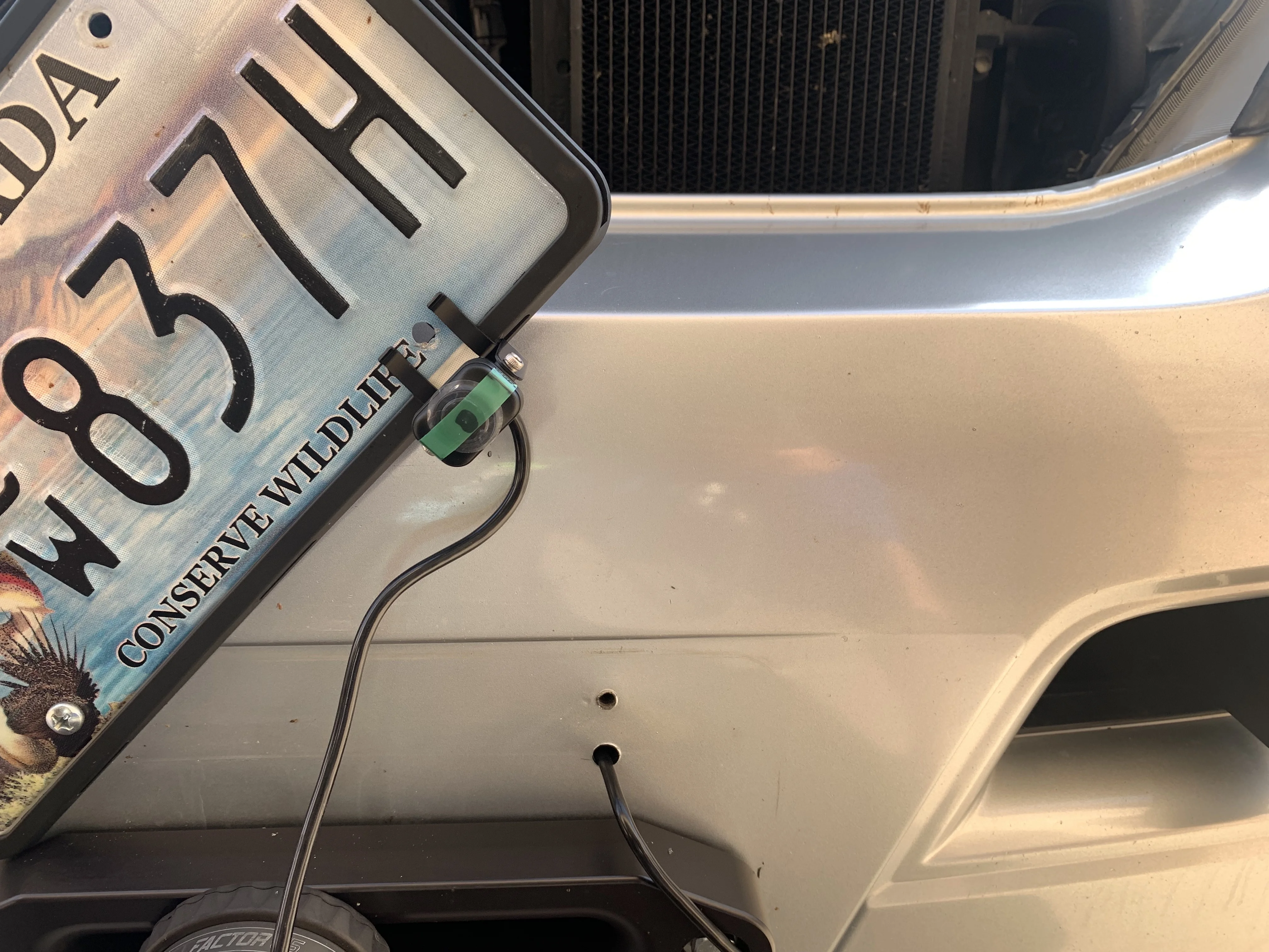

I have wanted to install a forward facing camera for a while. In fact, it was the ability to run multiple cameras, the Power Switch integration and the InReach integration that sold me on the Garmin Overlander. I have the camera set with with a relay to turn on with the ignition. That way the view is always ready for the Overlander.

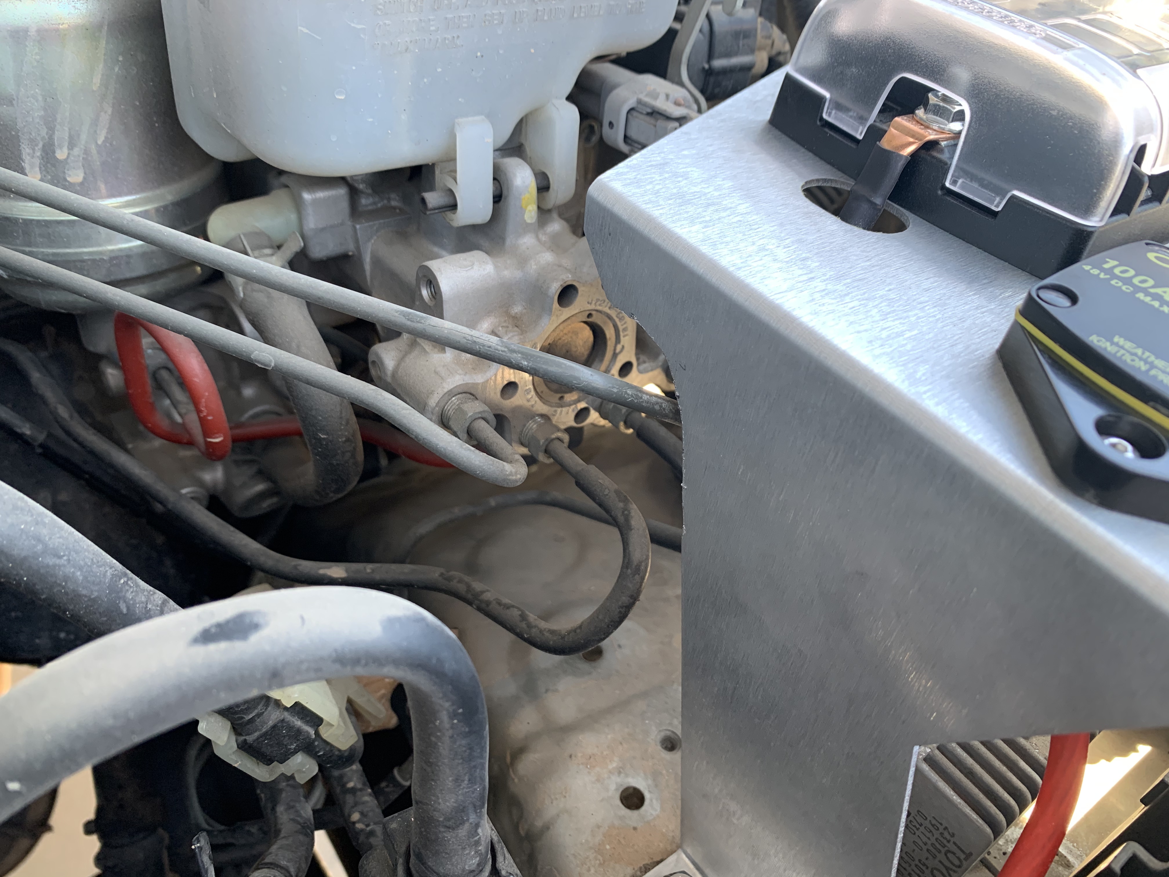

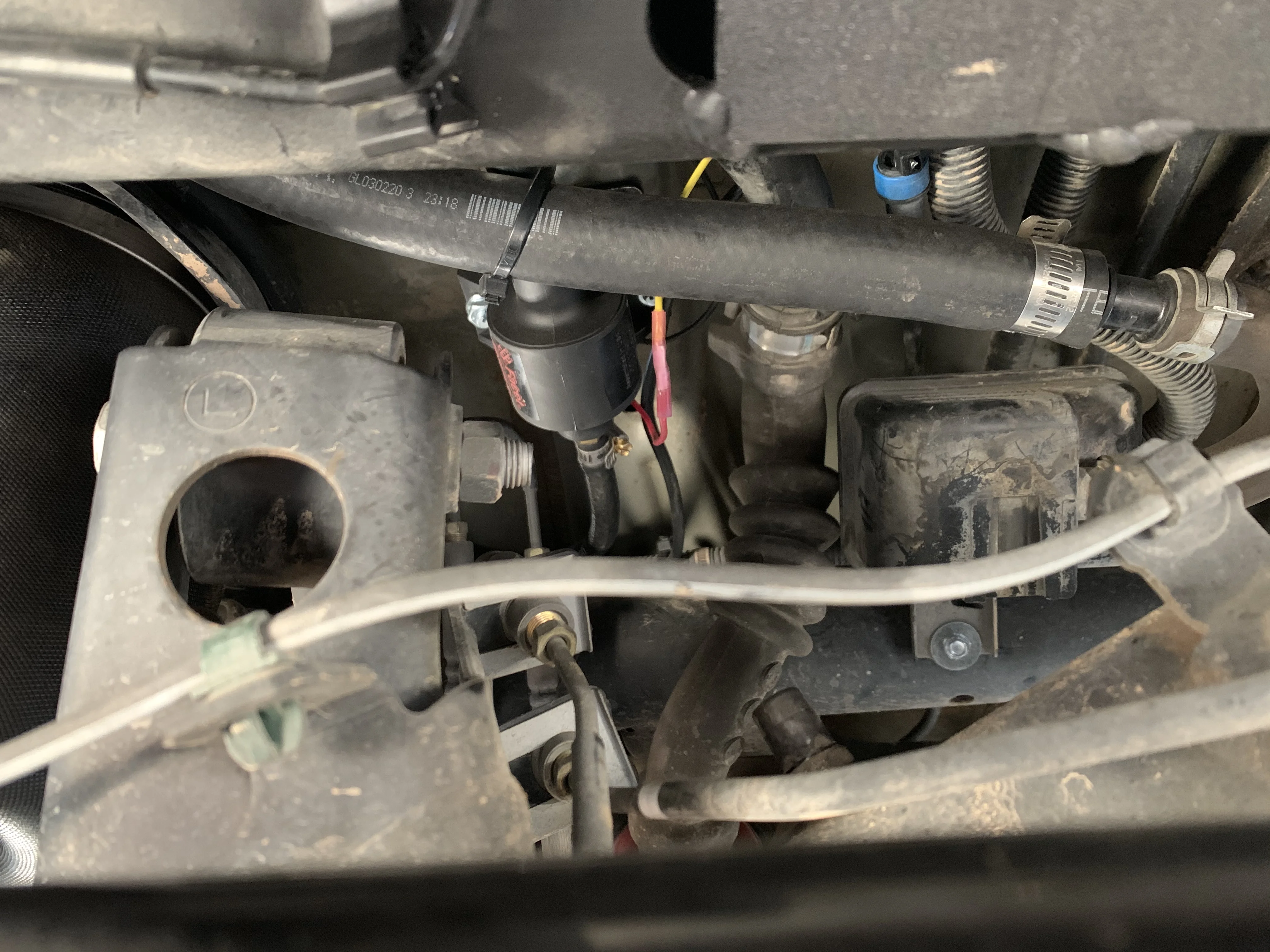

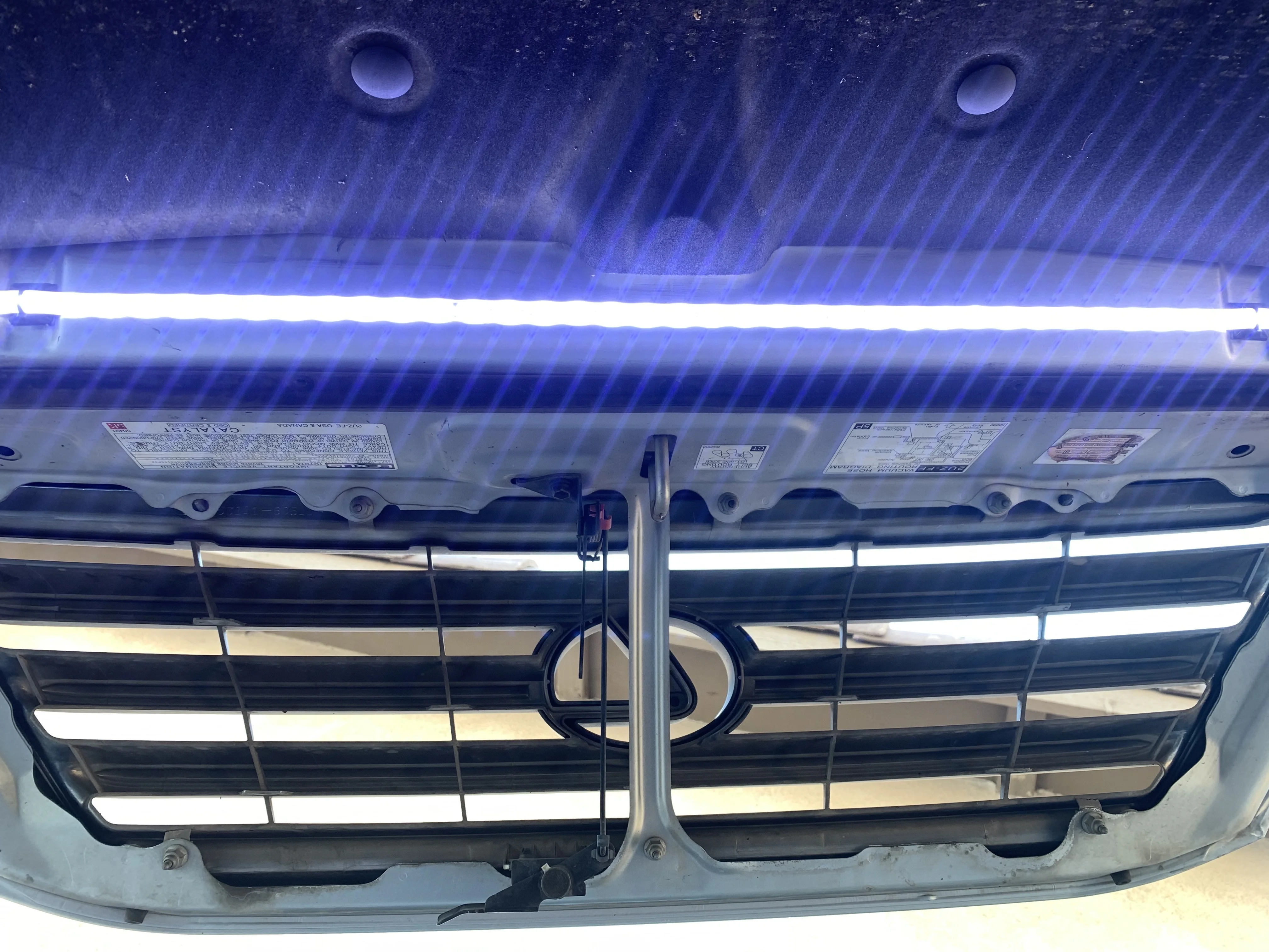

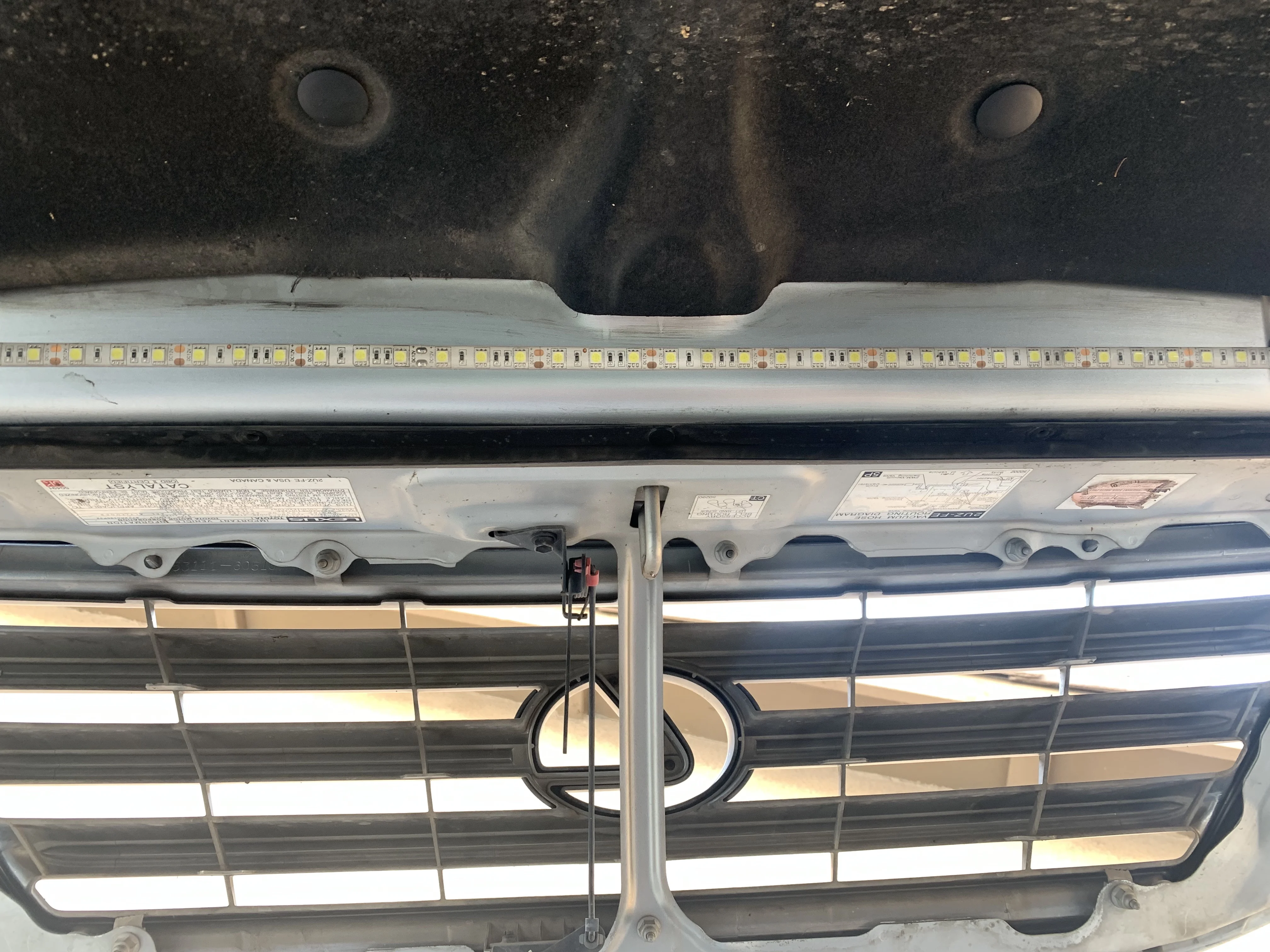

My wife gave me this engine bay LED kit from yodaTEQ a few months ago. Since I already had all my electrical stuff out for the camera install I went ahead and got this installed as well. It uses a pressure switch so when the hood is down it kills the light. I did have to play with the height adjustment to get it right, but there is a decent amount of adjustability in the switch.
