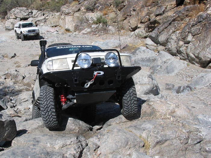

Hi Robb, that would probably be me (?) I have received some email inquiries on these tires, so I figured I would post up my thoughts thus far. Keep in mind that I have these on a '98 Xcab Tacoma that is pretty loaded up with stuff and probably weighs in the mid 5,000 lb range. I am using 32x11.5x15 on Toyota alloy wheels.
Copied from an email I sent out...
Thus far, I am extremely happy with the Cooper STT tires. Besides the obvious pavement, I have tried them in the rain, snow, sand, and all manner of off-road trails including rock crawling. I haven't had them in treacherous mud yet, just light mud that goes along with snow-melt on trails. In all conditions I have had them in, they have performed really well. They excel at slow rock crawling traction. This may have something to do with the GVW of my truck, as I have a great deal of contact pressure. I think they are probably not quite as soft of a tire as the Goodyear MTR. These tires have balanced well and are nice and round (no hopping on the road). I guess my only complaint would be that I have experienced some odd feedback (steering wander) when braking, or shifting gears at higher speeds. This has lessened a great deal now that the tires have some wear on them and I think it is pretty much over with. My guess is that the very pronounced sidewall lugs were being either compressed or lifted depending on braking or shifting, causing variations in the tracking of the tire due to sidewall lug contact with the road surface. I would expect to get 35,000 - 40,000 miles out of these tires. However, I usually replace my tires at around 50% tread depth so I will just measure remaining tread and when at 50% will check the mileage and double that to see what the actual lifespan of a set of tires on my truck is. The last set I had (Goodyear MTR's) were at 20,000 miles with 50% useable tread remaining. I expect the Coopers to do at least that good. I have also experienced a slight increase in fuel economy over the MTR's. Probably around 1-2 mpg with mixed city/hwy driving. I currently have 8,400 miles on the tires. Tread depth on my size (32x11.5x15) when new is 20/32" I am currently at 15/32" which is about 83% of useable treadwear.
I might just add that I checked the mileage referenced above, on a recent 5-day trip from AZ to CO with mixed driving conditions. I managed to get a few tanks of fuel to average at 17mpg or above, and one tank at 18mpg. The best I had been able to get with the MTR's was about 16.5 with an occasional tank at 17 or better, and sometimes as low as 13's.
Also, I really liked that fact that these tires came with factory siping across the entire tread width, which saved me some $$ from having to add siping at the tire shop. The factory sipes are perfectly centered in the tread blocks (where the siping machine is indiscriminate on placement) so I have had zero tears or chunking due to the sipes which is nice.
A pic of tire testing...
