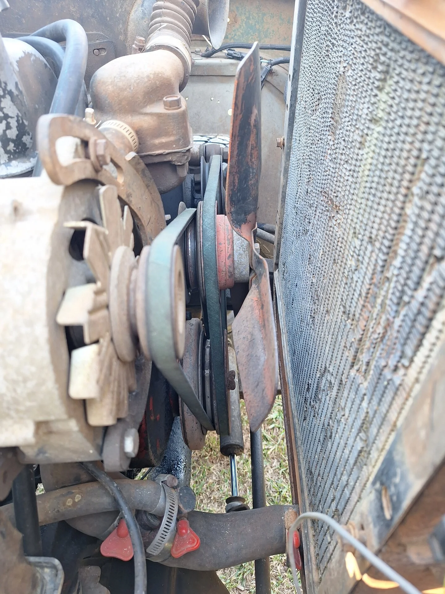

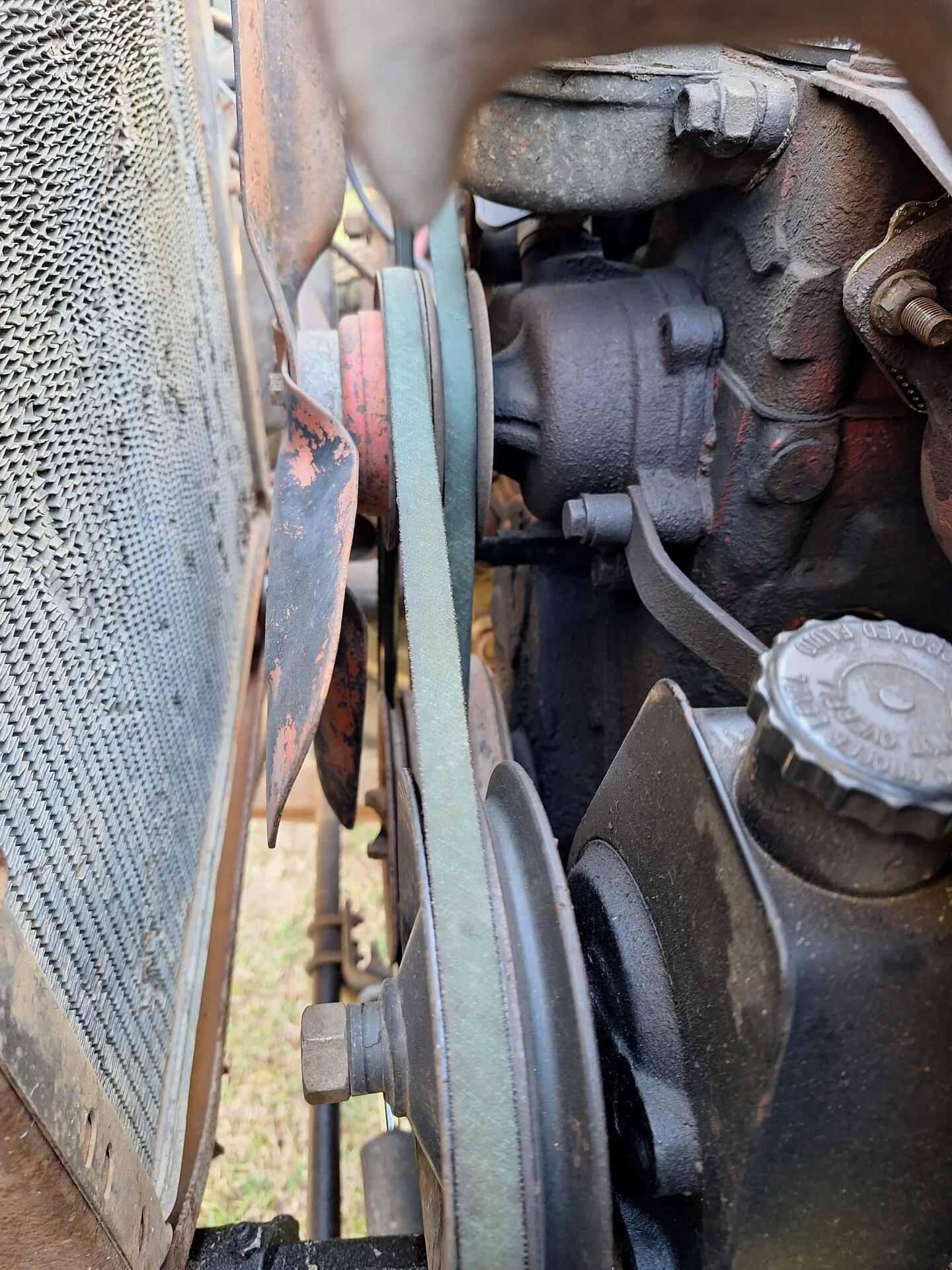

My 1.5F already has two grooves on the pulley One of the pulley grooves is smaller, but i run an aternator on one side and power steering on the other without modifying the crank or water pump pulleys. I can get you belt numbers if you need.
Mine has the same, but I'm wanting to go to the newer 75 and up pullys and belts as I don't have stock accessories on my engine. I have a gm alternator and powersteering pump. Both with the larger grooves. I'm also going to put the fan shroud back on but I may need the newer shroud I don't know if they are different on the clutch fans.
