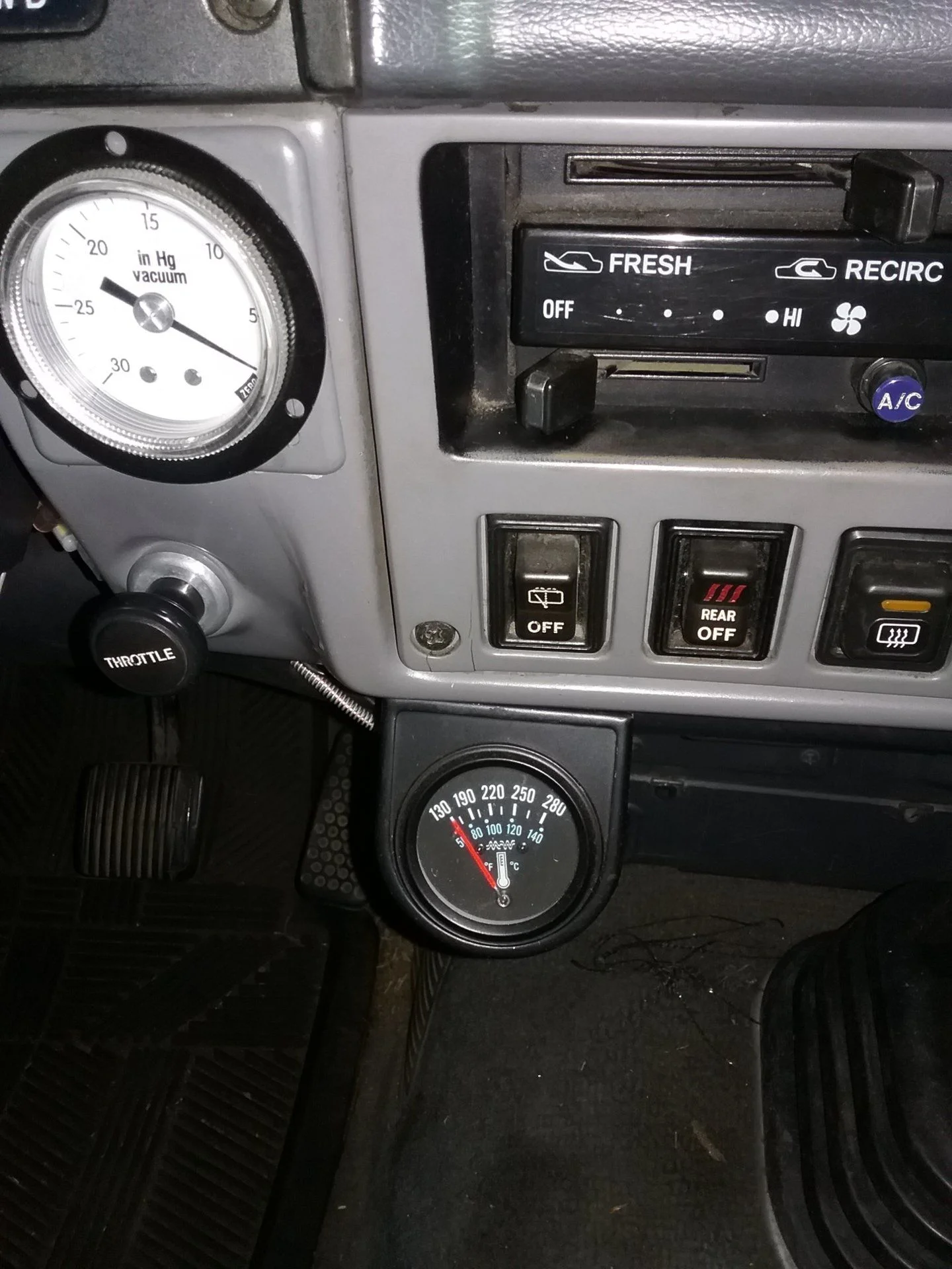

In action.
@ff347 would you mind adding a bit more info regarding the parts including wiring into the cab? I’m interested in doing this as well once I begin reassembly. Much appreciated!

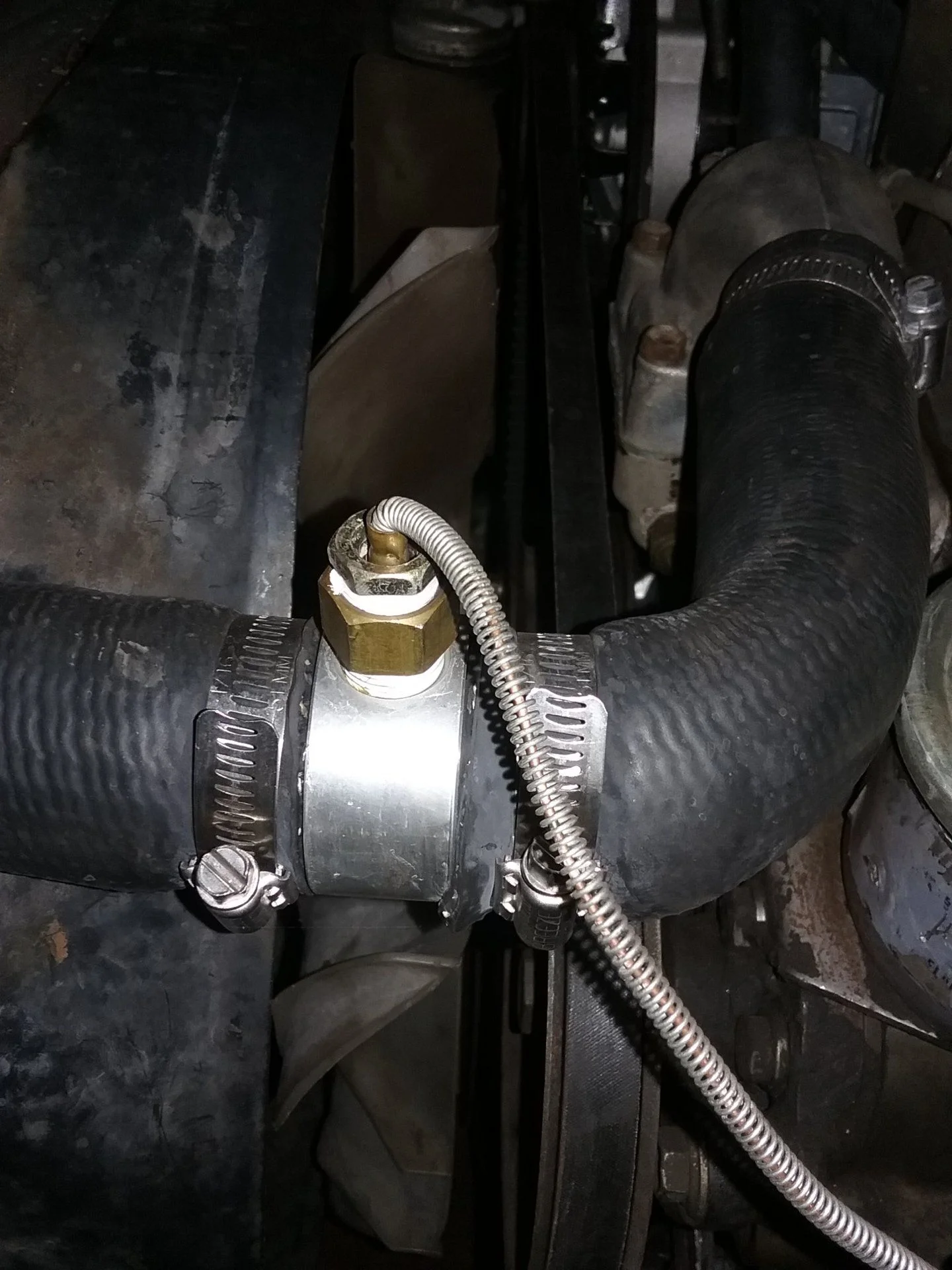

It has been years since I did this, I think everything you need comes from the link I posted. I got a mechanical gauge at Napa with an extra long probe wire, stab probe through firewall.
Mounted perfectly and done.
Two favorite gauges.
there's no good way to mount a mechanical temperature probe in the back of the engine. It's too big. The best spot for that large sensor is in the top radiator hose as shown. That way you can keep both sensors and gauges.
It has been years since I did this, I think everything you need comes from the link I posted. I got a mechanical gauge at Napa with an extra long probe wire, stab probe through firewall. View attachment 2050812Mounted perfectly and done.
