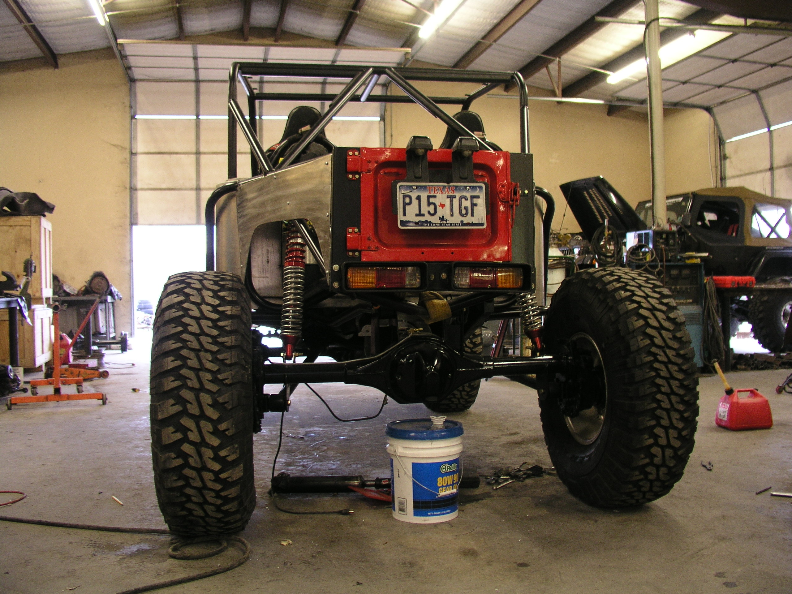

The rear axle was a Upside-Down 9" axle with Unimog outers.
Because of the gear reduction boxes you have to run the 3rd member upside down. This ads the problem of oiling the pinion at speed since the 9" is designed to be low.

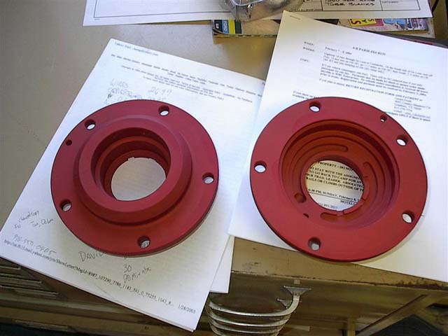

Tom at Sunray designed a custom Geroter that picked up gear oil and channeled it through custom grooves in the Pinion housing.
The brakes on a Mog are super heavy so we took them off and then used a pinion brake on it.
Total weight was #280 and look at the clearance.
Unreal axle.
BAZINGA!!
It was absolutely sick. Sick.
Basically if you could clear the front axle tube you never diffed out in the rear.
