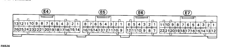

the first thing is to see if by chance the plugs are the same on the ECM. Since both the VAF and MAF are 5 wire systems it would be as simple as getting the 5 wires in the correct spot then putting the correct connector at the meter. This is possible since both systems use the same IAT sensor as far as readings go.
Here is a scan from the manual of the 4 connectors on the ECM
same layout but different labels.
