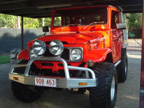

Here is my pride and joy .
Built this about 6 years ago.
Currently back in the shop getting some love from the panel/paint doctor.
Should be back on the road shortly.
Chris
Thanks fellas.
1978 FJ40 with 2F and 4 speed box.
Large dog crate for the mutt's to travel in comfort is a must.
Interior is one of the main things getting sorted now, was not happy with the seat mounts, unstable and not safe.
I will get some pic's when I am down at the panel shop.
Chris
