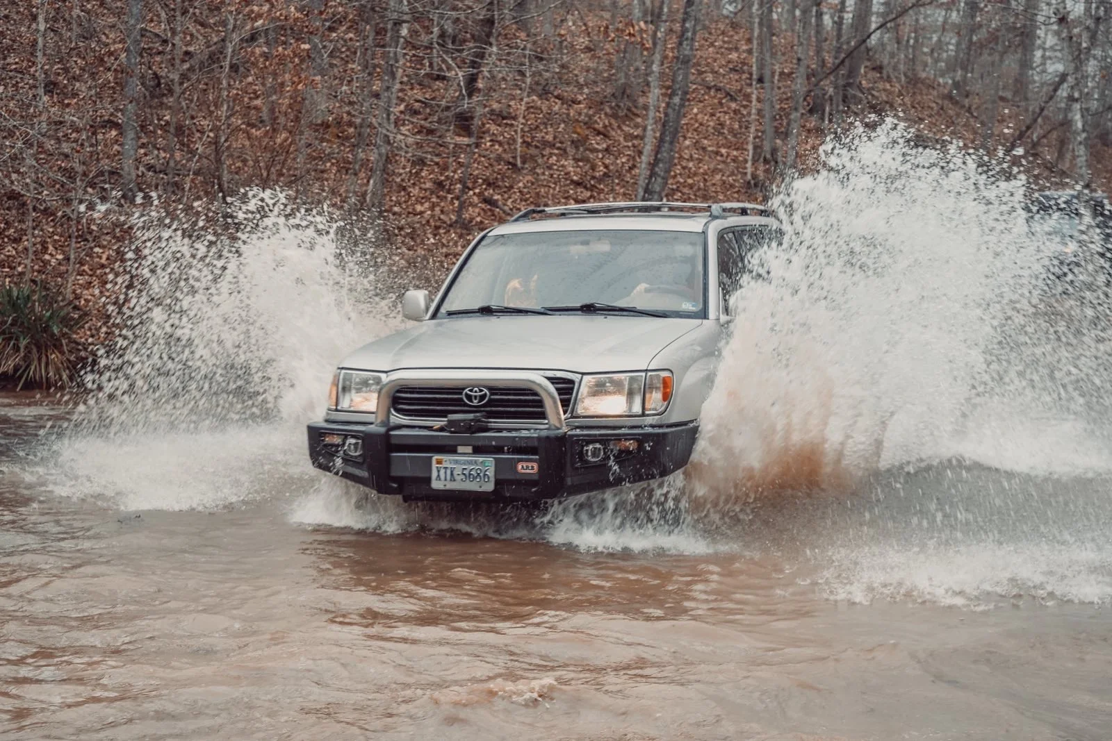

I have been pleasantly surprised and happy with the Defenders. Wheeled the Cove this fall and had no traction issues with the green trails (green is the new black apparently). Hit gravel roads with multiple creek crossings without issue. Also drove around on sod covered rocks without issue. All in all a positive experience.
