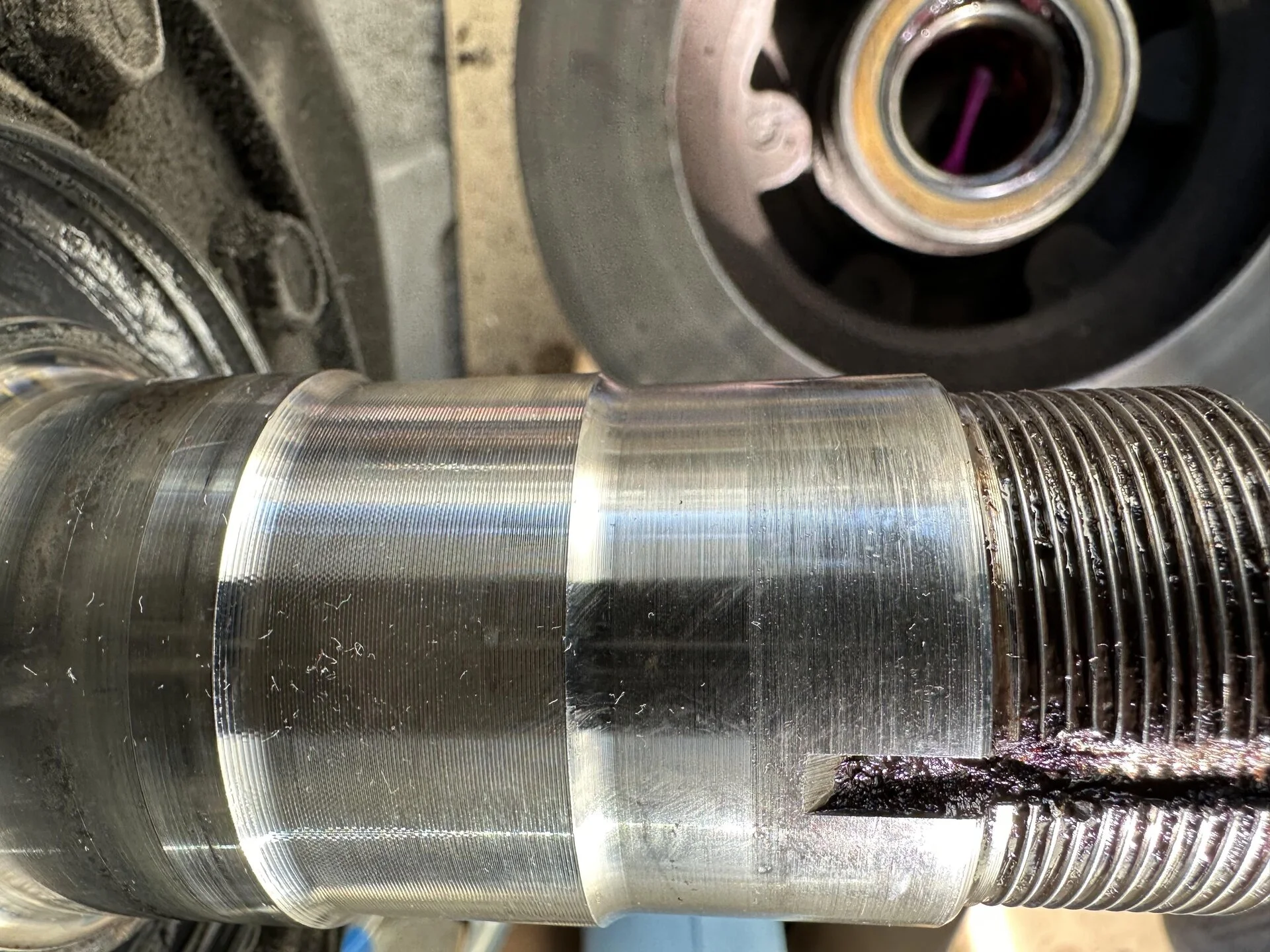

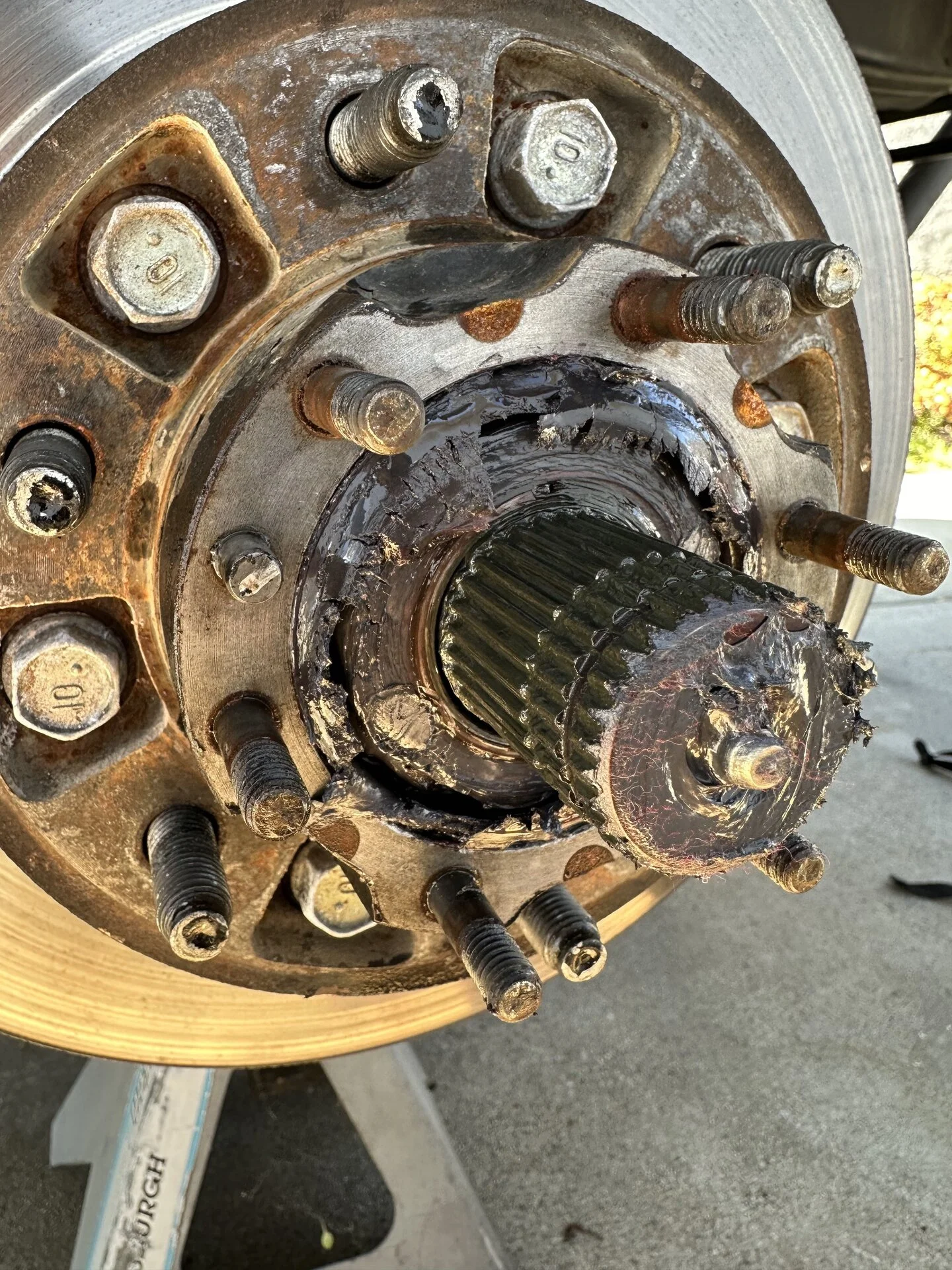

Oh yeah, spindles look serviceable to me. Feel for a noticeable lip on the bottom surface near the edge of where the bearing races ride on the spindles. If you have damage it will most likely show up there as a lip on one or the other spindle bearing contact surfaces. Tight bearings don't turn relative to the spindle which protects the spindle from wear but loose/sloppy bearings may turn on the spindle and wear a groove that makes it really hard to get later bearing installs to hold preload.

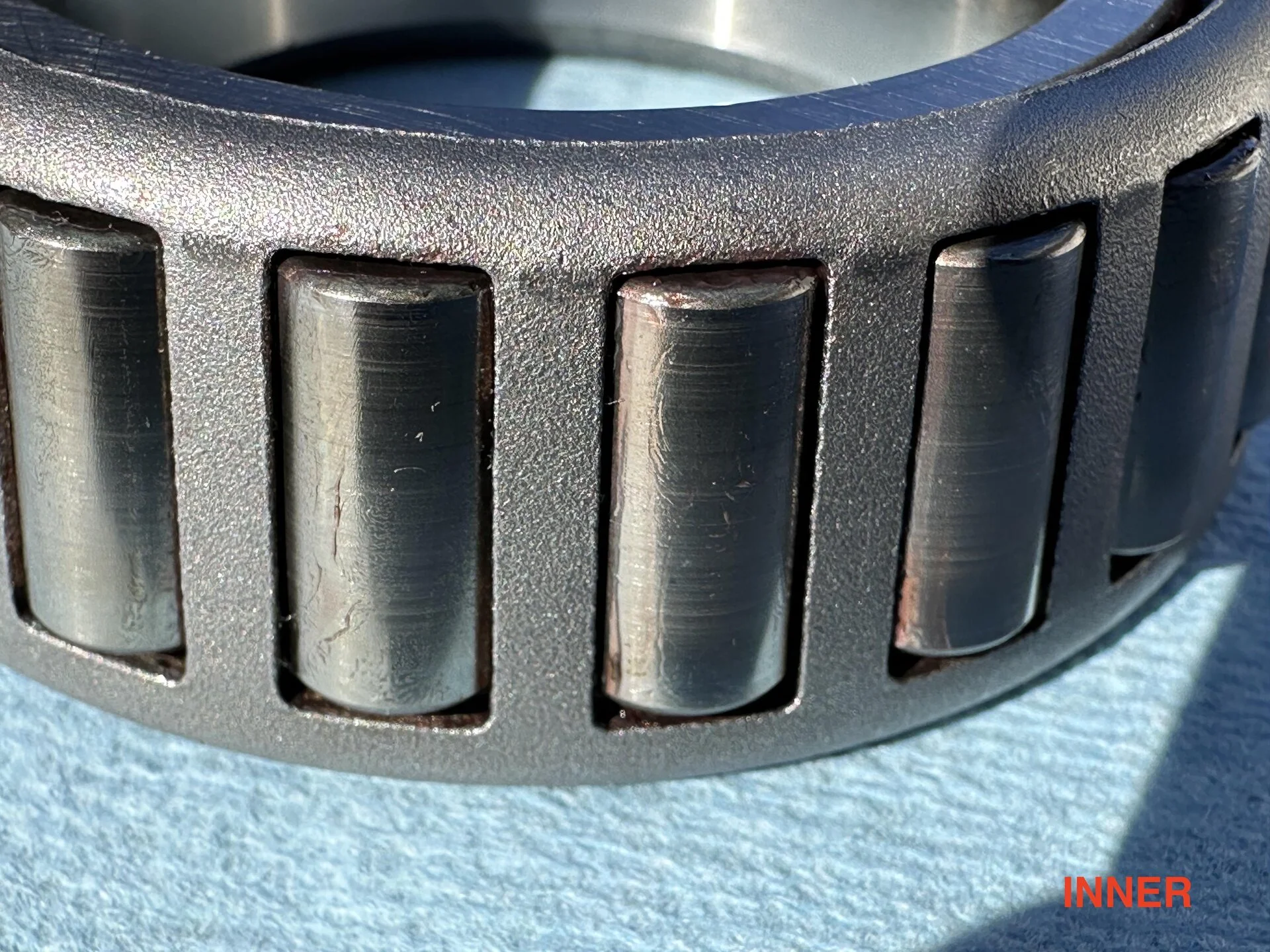

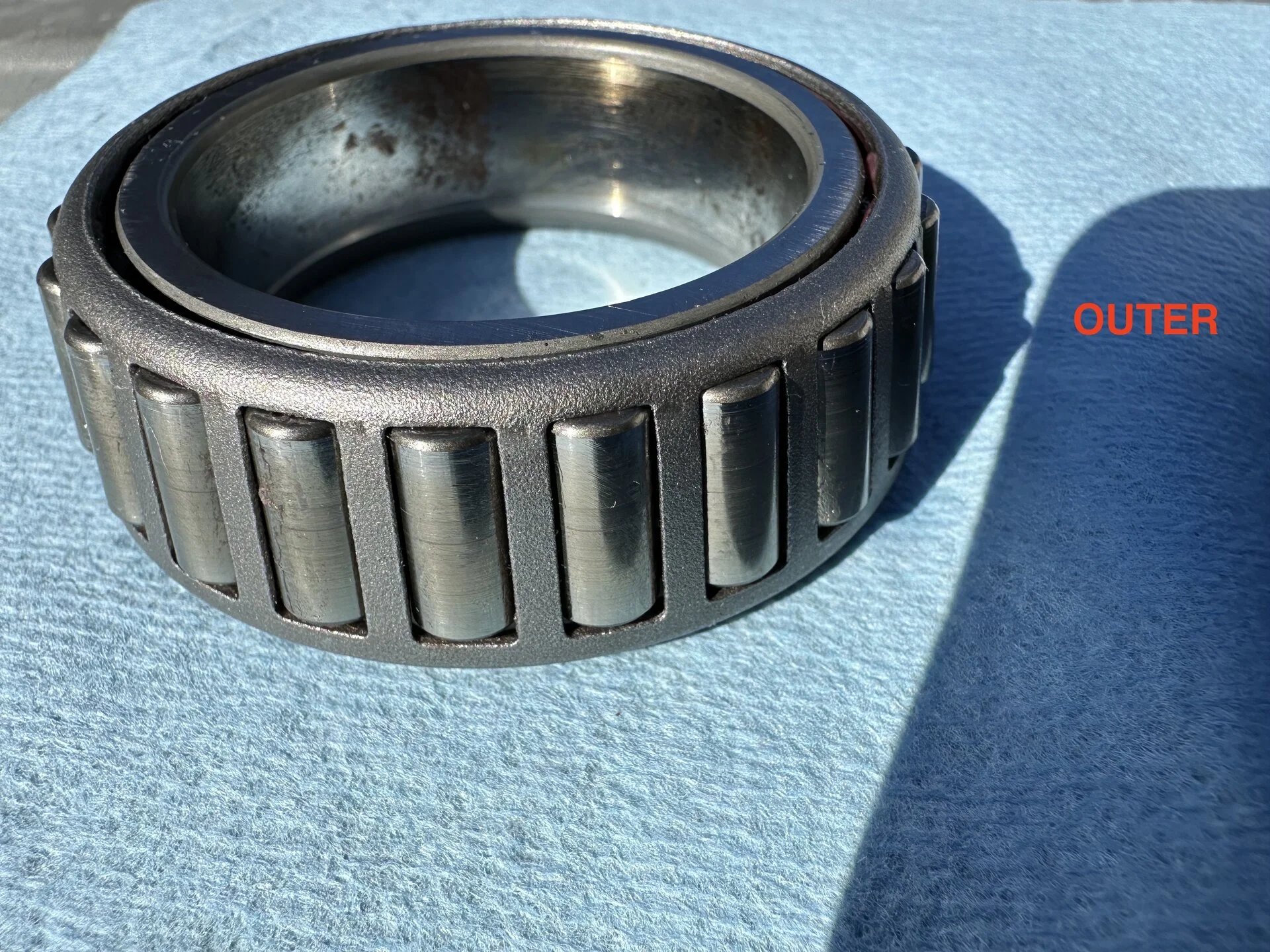

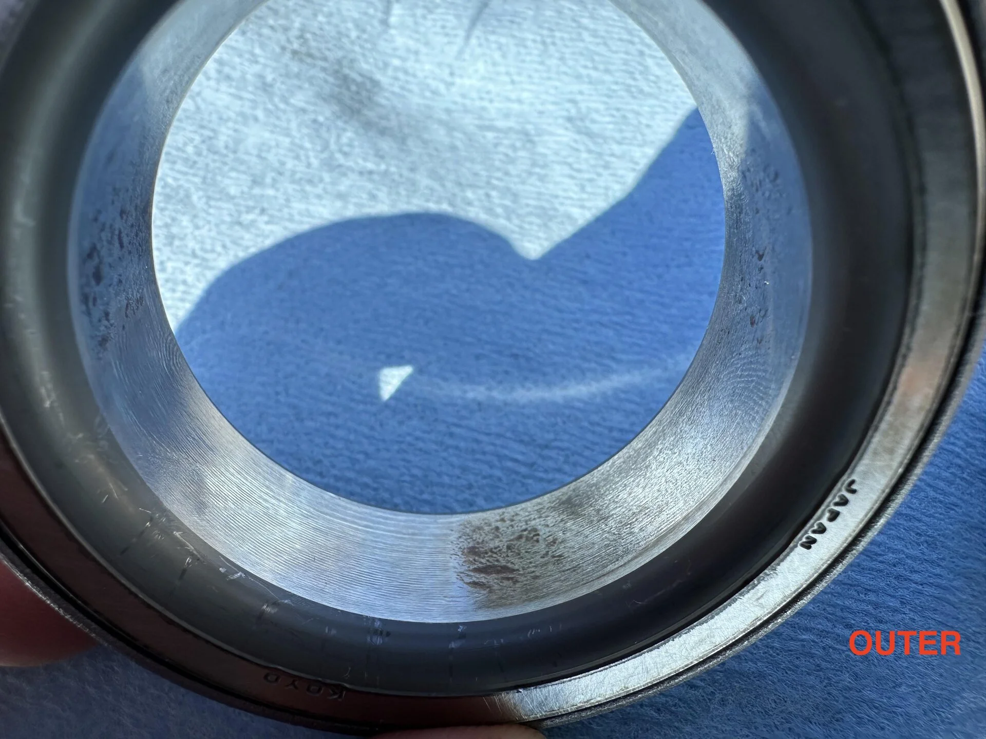

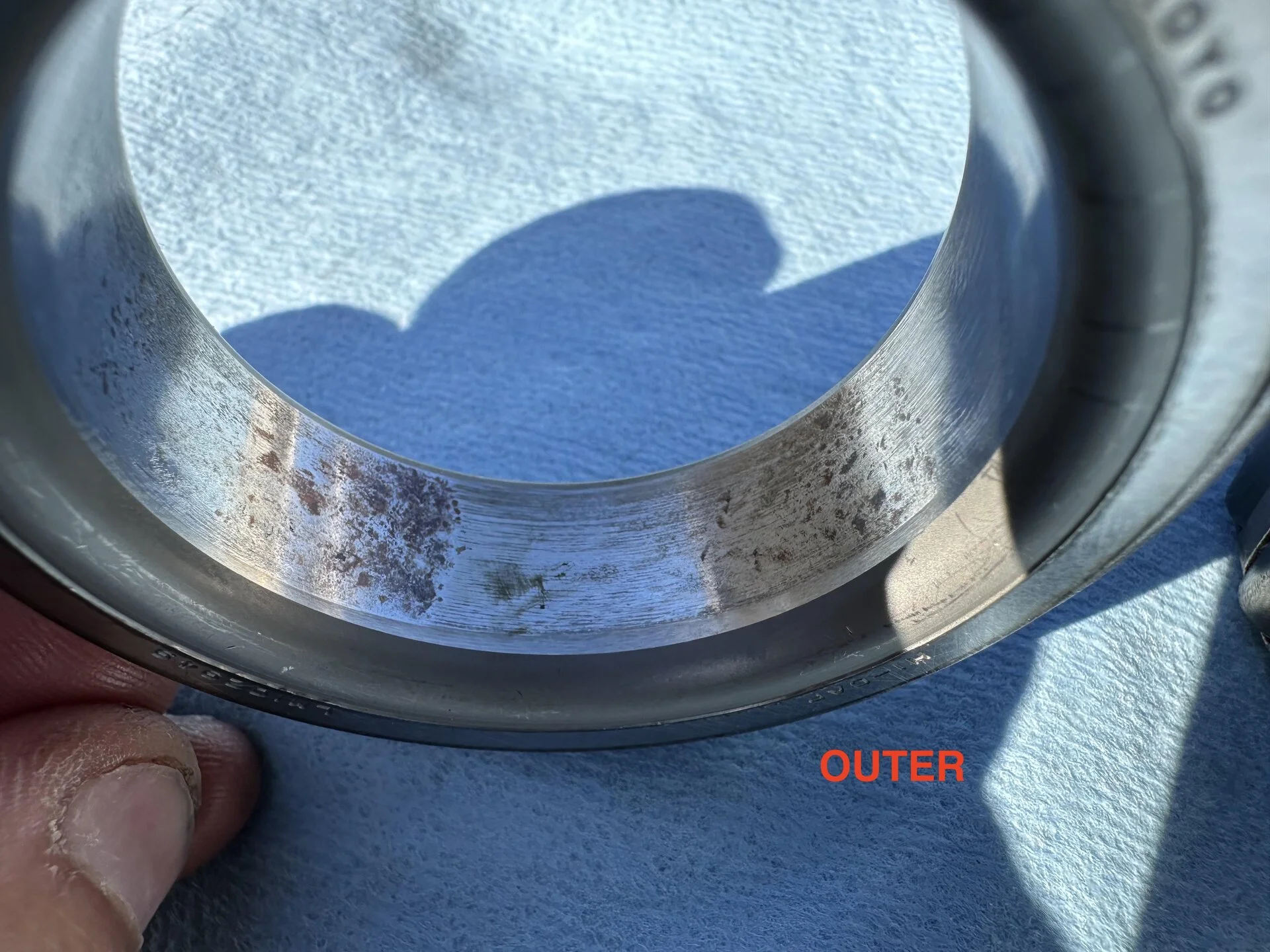

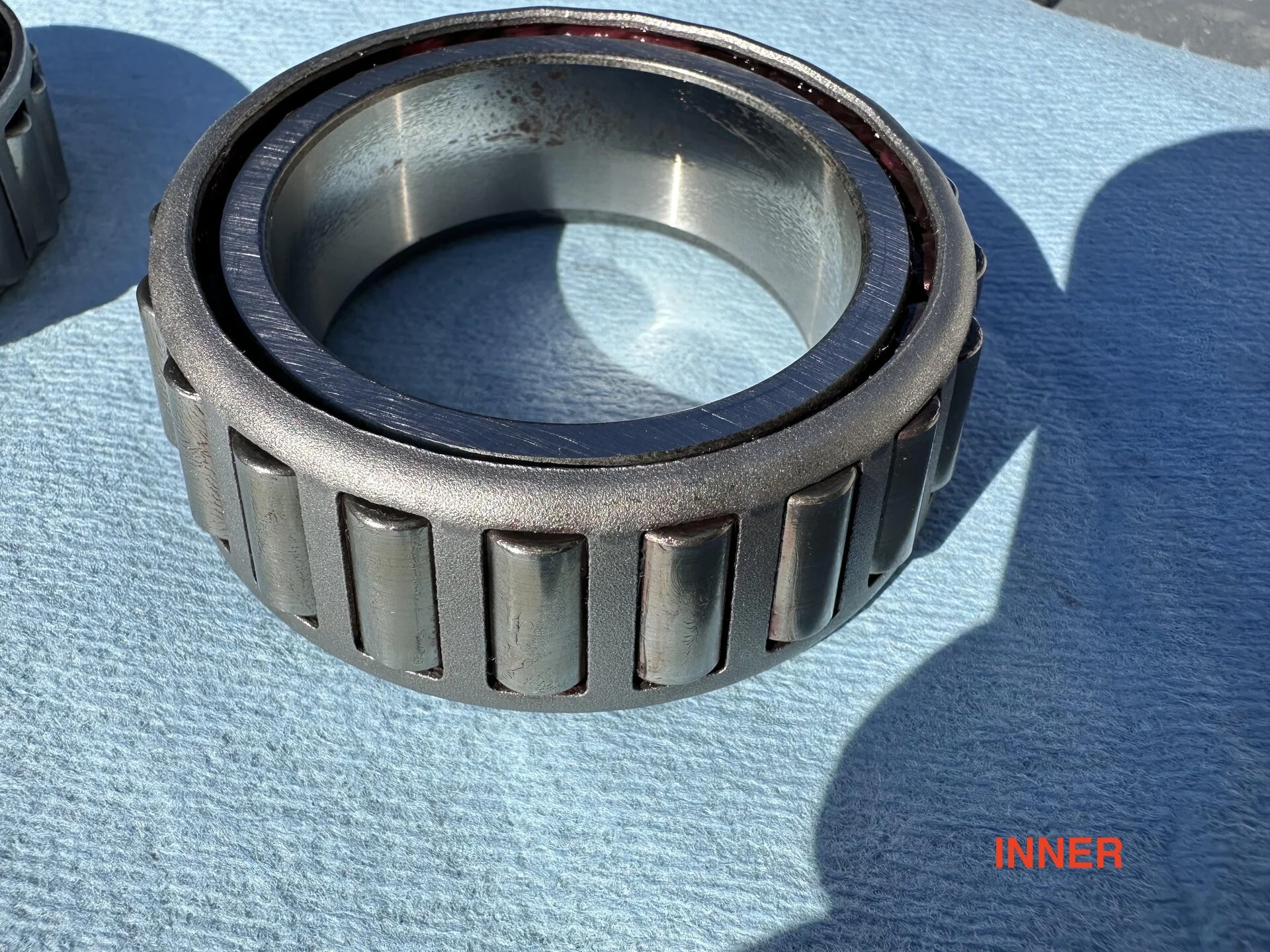

The bearings and spindle looks fine (scoring/scratches on bearing rollers is normal) other than what looks like rust sploches which should never exist given the grease in there.

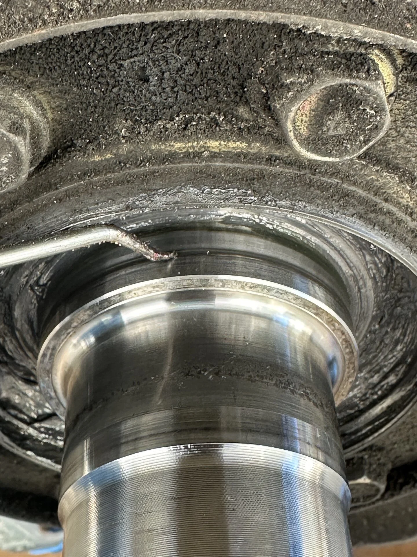

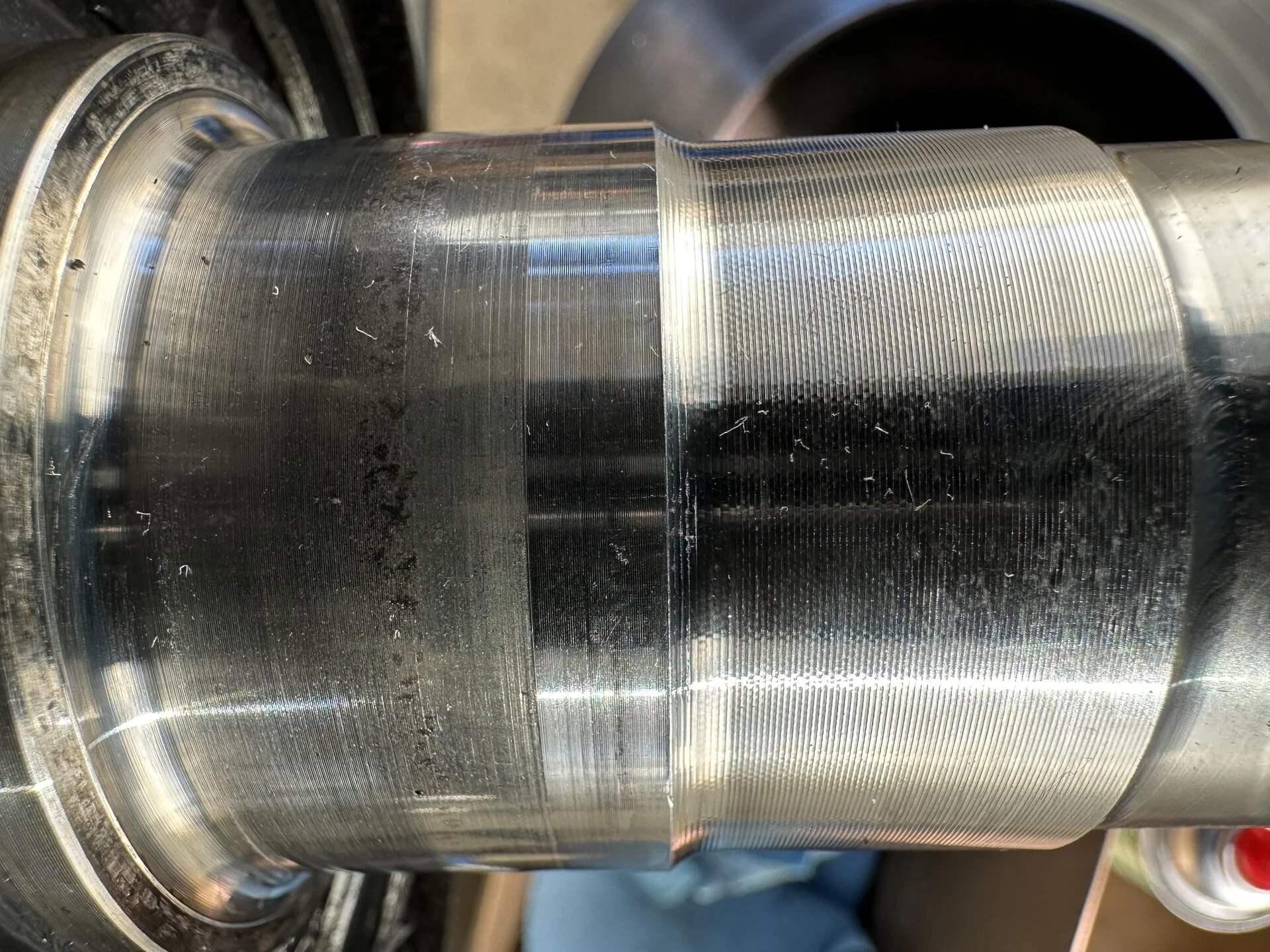

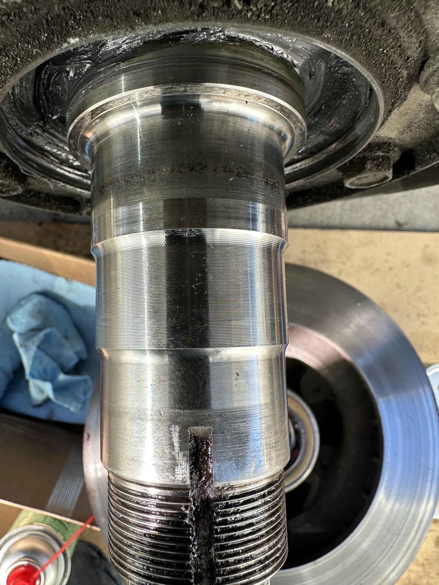

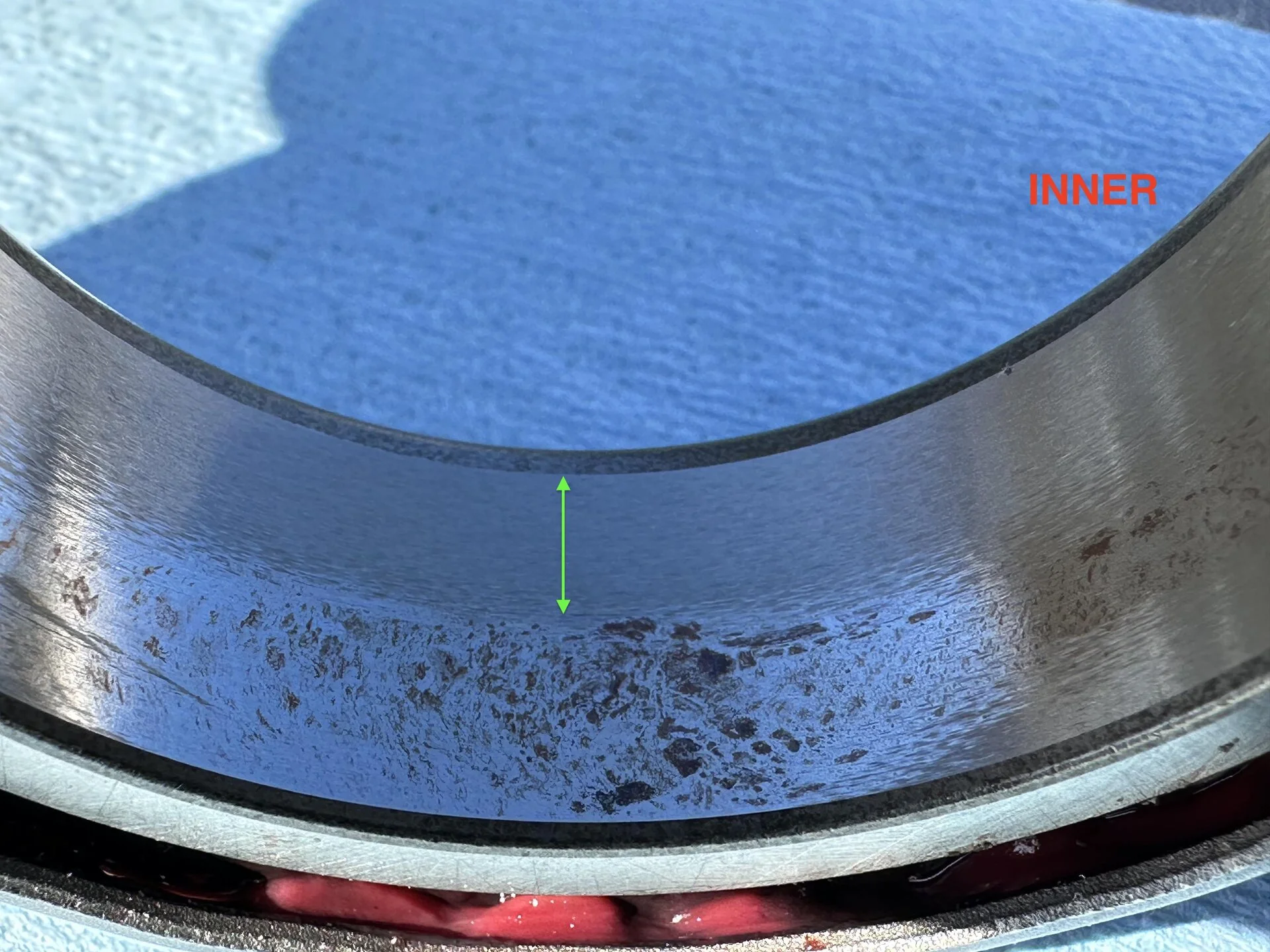

Haven't felt any lip on the race where it interfaces the spindle. One thing I did notice that the inner race does not fully engage all it's surface to the spindle. As if it only pushes back and covers 75% of the race/spindle contact surface area. I've attached a couple images with the green arrows. Upon looking at a few other members photos it seems about the same. Perhaps it's out of round or just the way it is. I've only done one rebuild on these 80's and don't have enough seat time to tell yet. I appreciate you taking the time to share bud.
Spindles look great. Bearings, not so much. I agree with @jpoole especially if running larger than stock tires. That preload is for much smaller tires than most of us run. I torque to 30 on new bearings and check at every oil service and in between if I have the front up for any reason
Yes, I believe this new spindle I popped in has the new roller bearings. Thank God for google sheets, that was 8 years ago 14k earlier. I'm hoping its not the needle bearings at 14k. It is bizzare on the corrosion spots, my hub was packed with CV2.
Forgot to mention, the oil seal after 14k miles (I replaced the spindle after the bearings 26k ago) did put a decent groove in the spindle surface. It did its job, hoping to migrate the new oil seal for a new lane. I don't mind throwing money at this rig, just trying not to waste it. I've been noticing a few big brake kits coming to fruition on mud as of late :p So far, it seems spindle is still good to go.

There's more fretting on your spindle than I'd expect to see in that time frame, but they still look OK. Suggests not enough bearing preload
