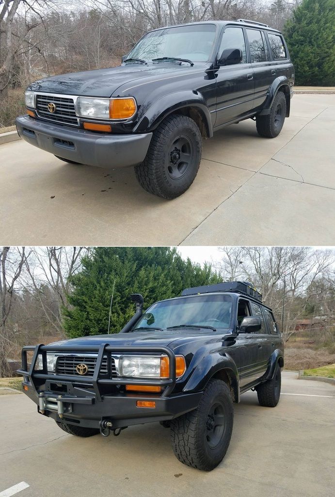

Hey everyone, I've been lurking here for a bit, just picked up my first land cruiser in January. I've been tinkering with it since I got it.
Right now it has a cheapo roof basket mounted to the factory load bars. But I found an original Con-Ferr rack for a great price, and plan on going that route.
My question is should I remove the factory rack and get rain gutter mounts or get rain gutter mounts that mount it just above the factory rack? It seems Diamond rax offers both options.

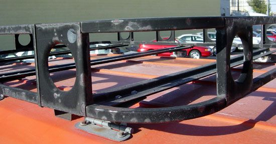

The Con-ferr rack was mounted to the roof itself which I'd like to avoid. It was mounted similar to this.
Here is a pic of when I got the LC, vs a few days ago with cheapo rack, and a pic the Con-ferr basket.
Let me know what you guys think. Thanks.

100% go with the rain gutter mounts. I currently have my headliner out and have the entire roof exposed. There really is nothing up there to hold any substantial weight.
The question really comes down to how you intend to use it. If you mainly use it to just drive around on the interstate and around town then it would not matter to much. But if you want to put a RTT and load the rack with other gear while overloading on rough terrain, then the rain gutter mount is the ONLY way to go.
If you decide to remove the factory rack, you have to keep in mind that you will have holes to fill and paint. That would be a good idea if you see any signs or rust or corrosion under the factory racks. Otherwise why not just leave it. The confer rack sits high enough above it, that it would not pose an issue.
