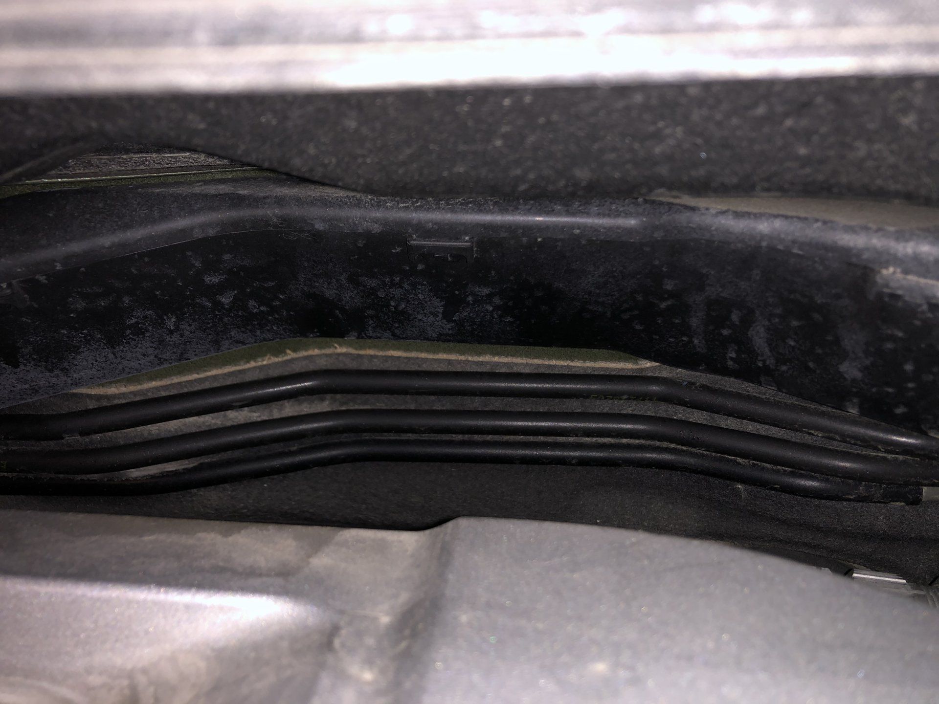

Also, is there a trick to opening the plastic wire protector that runs along the firewall behind/above the engine?

I did not, and would refrain from messing with that conduit. When I had additional wiring ran across that area, I ran it through some of the standard plastic wiring protect, and zip-tied it to the top of that conduit. 1) It is easier that way, 2) it will prevent unintentional damage to the wiring inside the conduit while trying to access and run wires.

I concur on that conduit. I started prying it open when I was doing a bunch of stuff under the hood and I got nervous I was gonna inadvertently cause other problems. Some of the spots are tight.
I stopped prying for the same reason. It would be so much cleaner to route through that factory conduit though.

I would have preferred to get through the factory conduit too, but it just didn’t seem feasible. And the reality is that the conduit only spans 30% or so of the firewall crossing, so you’re going to have visible wires regardless if you choose that path. All things considered, I don’t think many people will notice the wiring running across the firewall and there are plenty of other areas to stray from a “clean” underhood installation...
