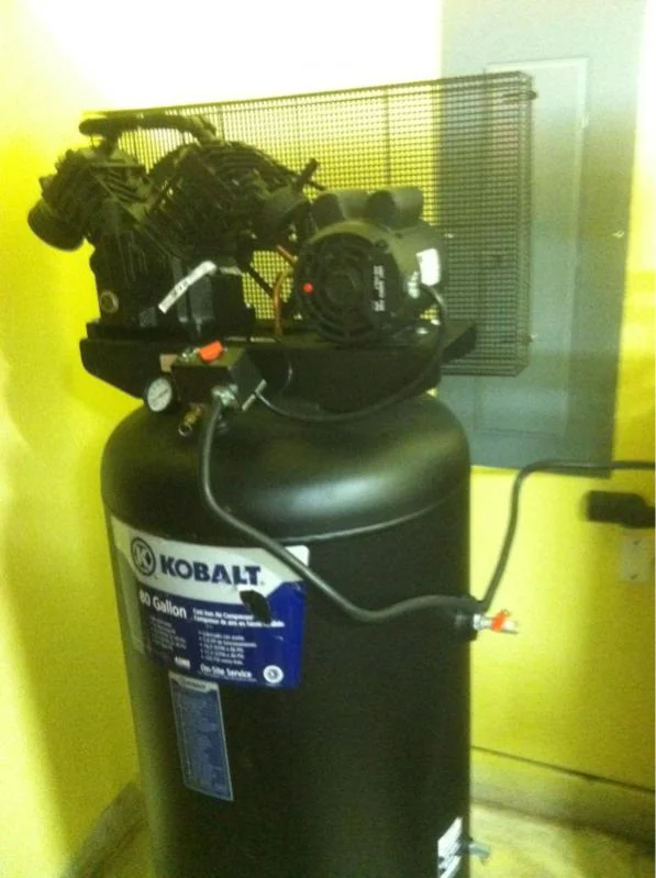

Ended up going with the kolbalt from lowes, a rebadged campbell hausfeld. Got it installed this afternoon
