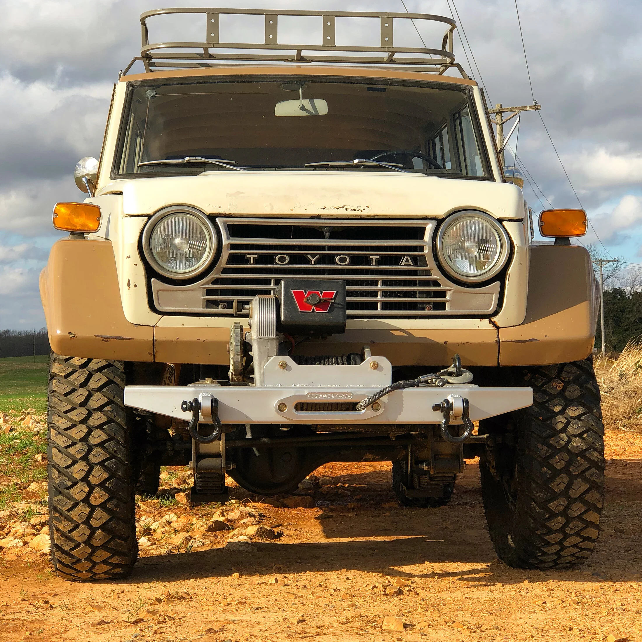

Complete guide to Warn 8274 install on Pig
Killer! Looks like homemade bumper "Extenze"? 8 bollts total. Solid.
Here was my 8274 on a 4+ bumper Dave Gore made me:

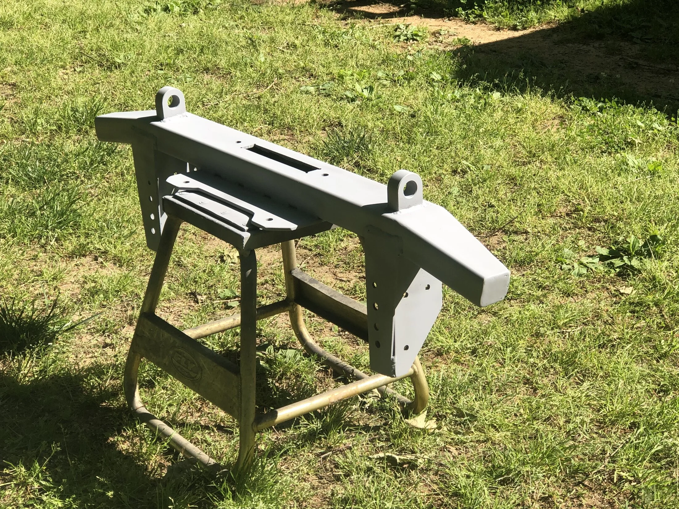

Someone on here used to sell the extension brackets (@Awl_TEQ ?):
@Ry24000 Did you get something figured out. I just found this on FB local, will be rebuilding it this winter. Not sure if this Scout bumper would fit or the one that's already on the Pig.
@Dudleyfj40 Not yet. I have been working on other projects lately. I need to get some work done on the Pork project. I actually totally forgot about this thread.
I was considering building my own bumper or buying a basic one from here 4PlusProducts | FJ40 | Front Bumpers | Channel Bumpers - http://www.4plusproducts.com/fj40channelbumpers.html and throwing some tube on it to make a bull bar. Need to fab or buy an adapter for this bumper. Front Bumper Mounts 40 Series - https://www.trail-tailor.com/store/p12/Front_Bumper_Mounts_-_40_Series.html I think this extenze will do it.

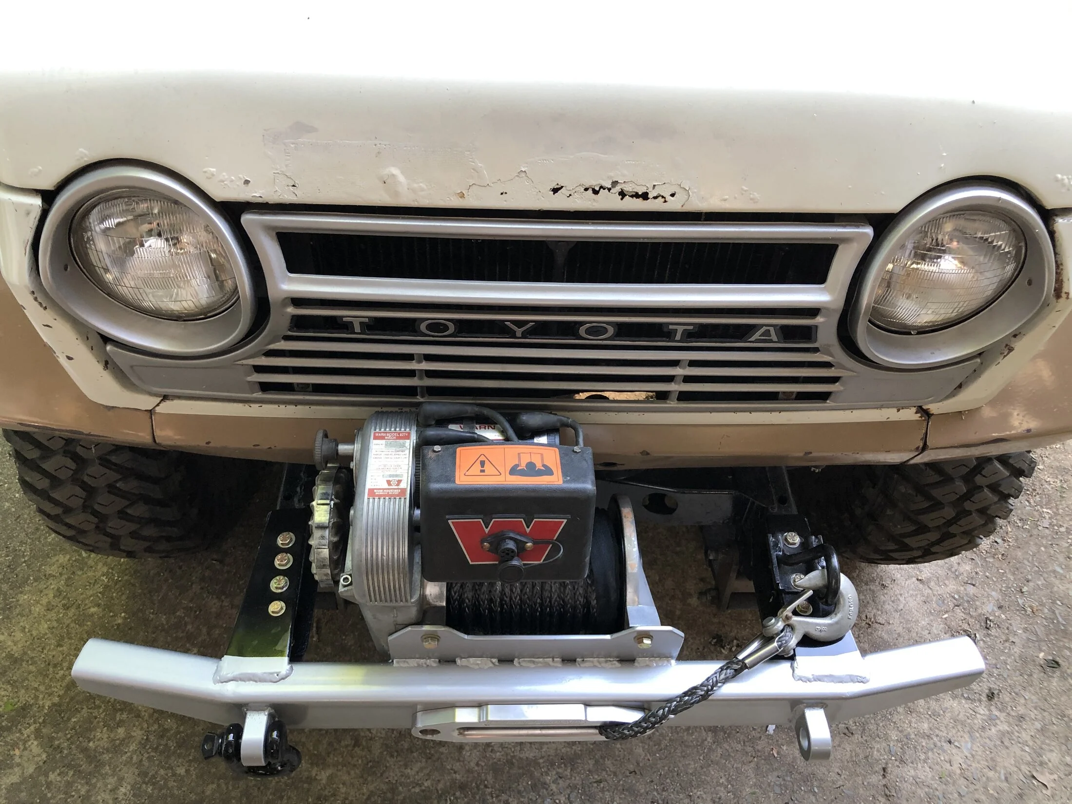

Well, I decide to use the holes that the PO drilled to give the 8274 plenty of space. Added an angle iron to the bottom to give it a secure mount to the frame.
Now, waiting for some BF parts to finish it up.
For reference, my Belleview (the 8274’s grandpappy) seemed to have some cheap extensions bolted in.
