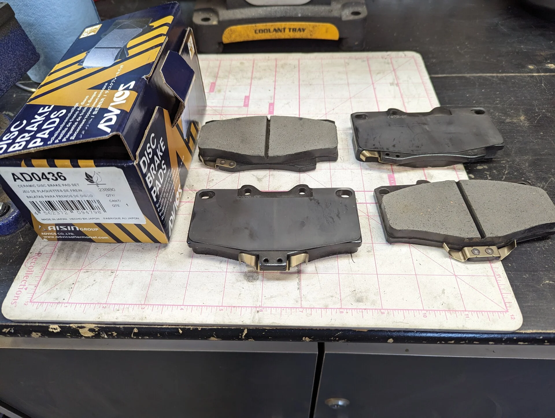

I have Advics AD0436 that I just got delivered today from rock auto that are supposed to be a direct fit to my hzj77 (front). I'll confirm fit tomorrow but I'm confident they'll be the right ones.
Aisin ceramics, so should be good?
Confirmed! They fit. Note that this particular box doesn't come with any hardware. Just pads.
(Btw, rear pads are the same as the FJ cruiser rears etc (seem to end in 606 as a rule) in case anyone ends up here for rear pads...I have a set of those on their way).
I haven't even looked seriously at my brakes, yet: "hardware" = slides, clips, shims, etc?

Hardware in terms of the front is two pins (sliders) and wire clip retainers... Two each per side.

I have an unopened box of the same … AD0436 … for my 1992 HZJ73, so I’d say you are good!
I’ve got new rotors in a box too. I’m planning on tackling the front brakes once I’m done the rod ends and a hub rebuild. I don't know what the calipers will be like until they come off, but a reman set for the 4Runner are pretty cheap, so I’ll prob get them. I’m posting details in my build thread as I go.
They definitely fit, we’ve been using the Advics 0436 on 90+ 7x’s for many years. Sold hundreds of sets of them to 7x owners.
