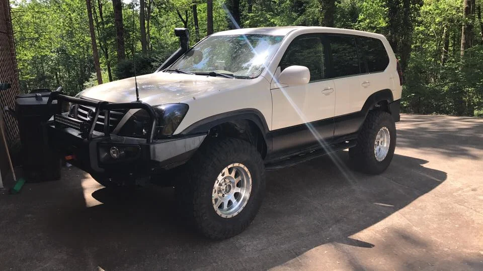

I have 35s and I am running a 2.5" lift :)
I see you removed the fenders which is what I want to do. Other than body mount chop and fender remove what else did you have to do to get them to fit? I plan on new UCAs as well. I hope my rig looks half as good as yours when I'm done!!
I had to do a lot of cutting, hammering, travel adjustment, etc. Not cheap or easy but I like the low stance
