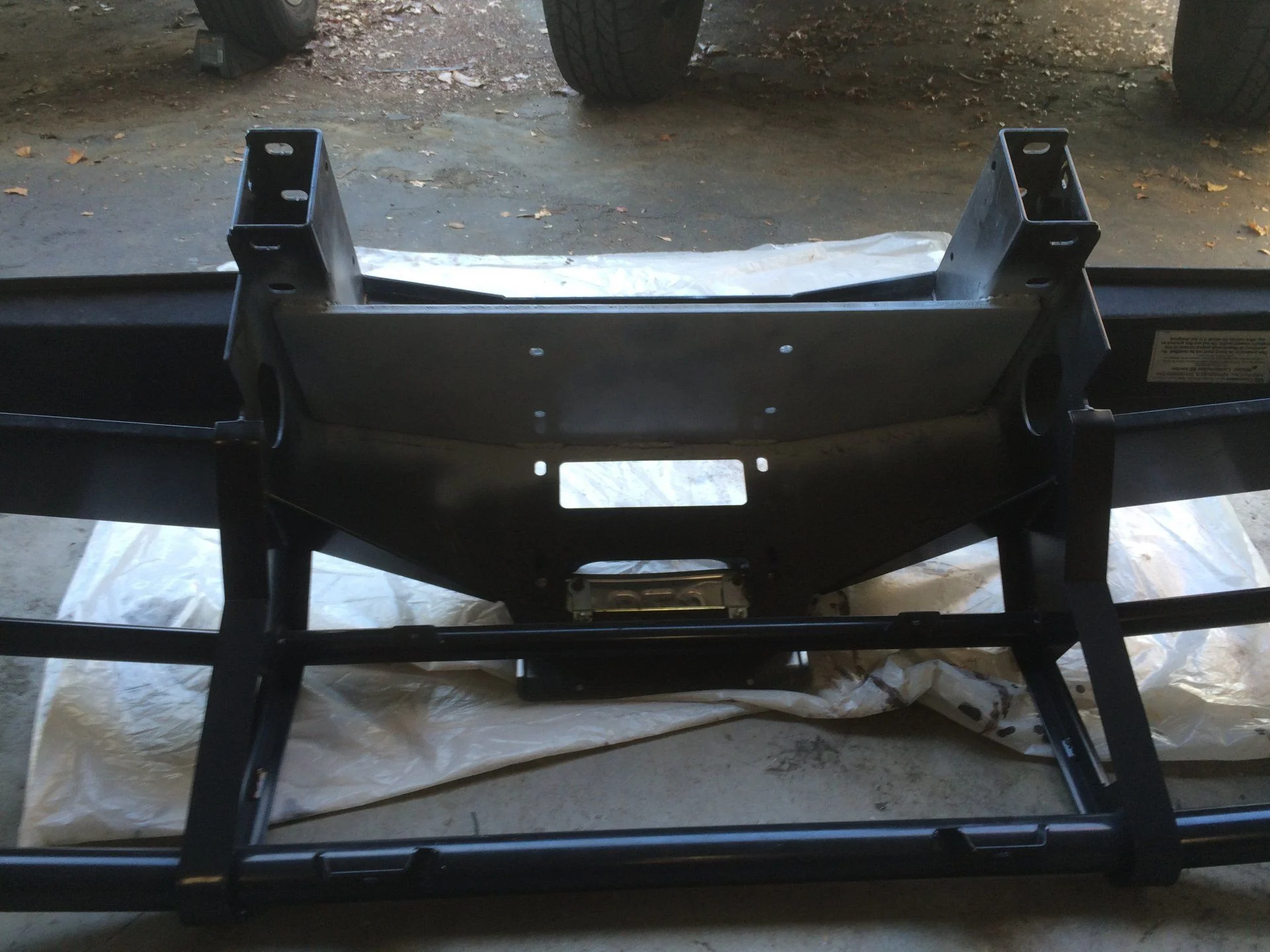

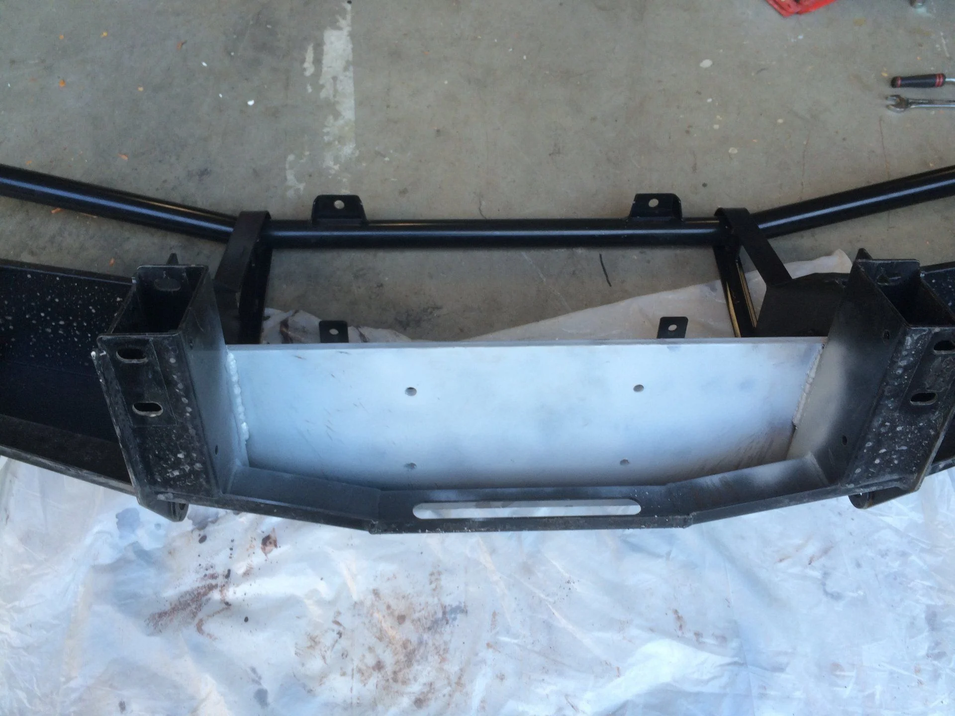

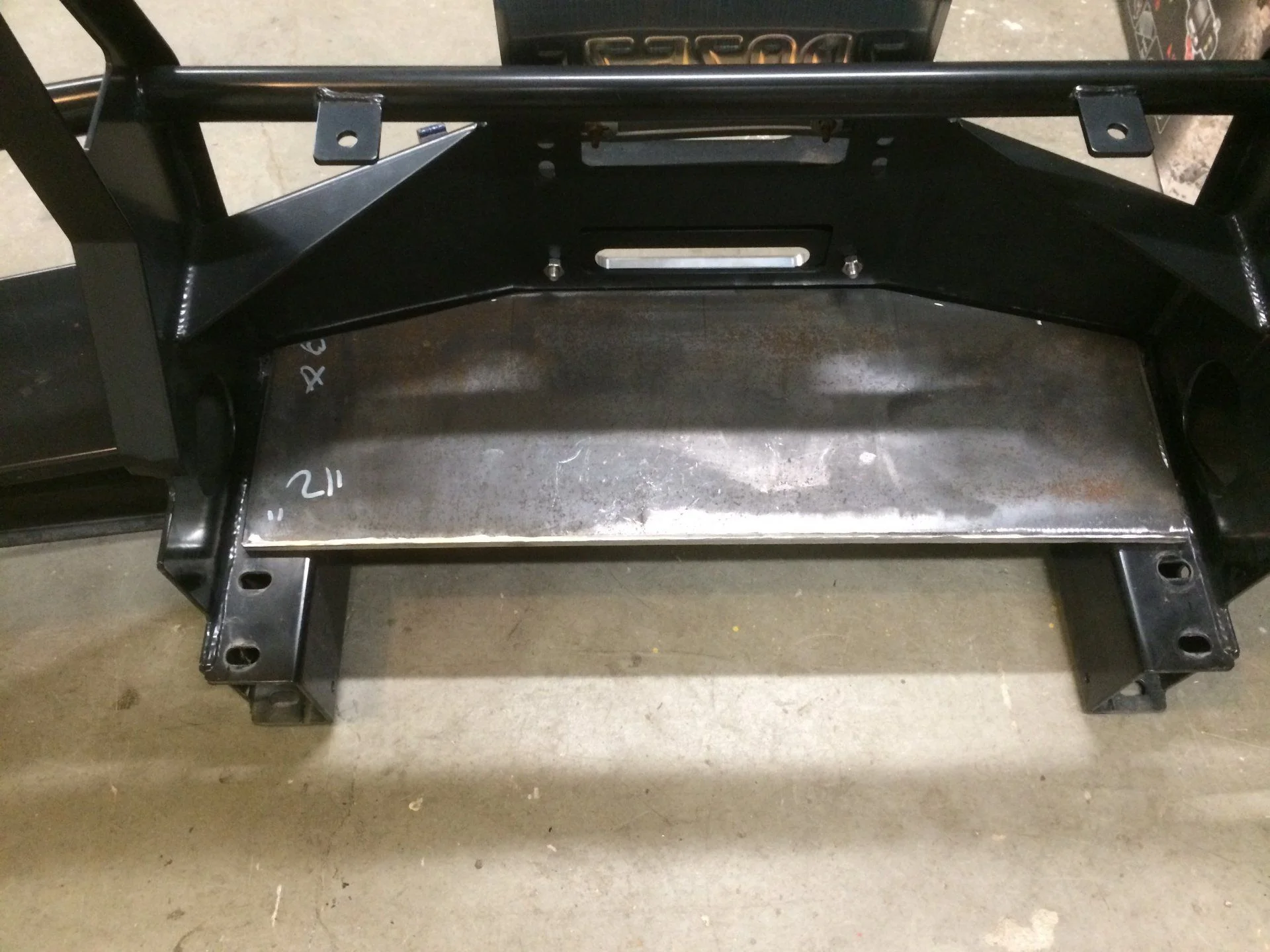

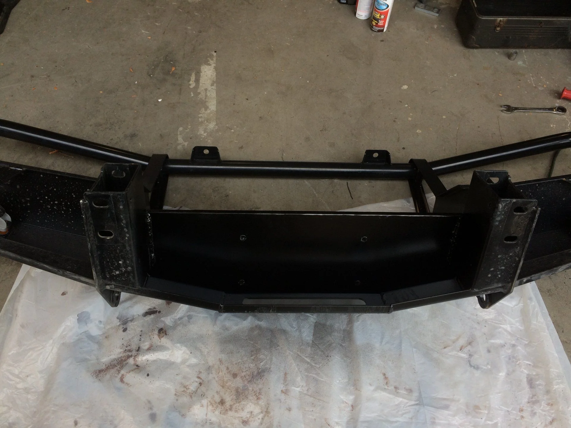

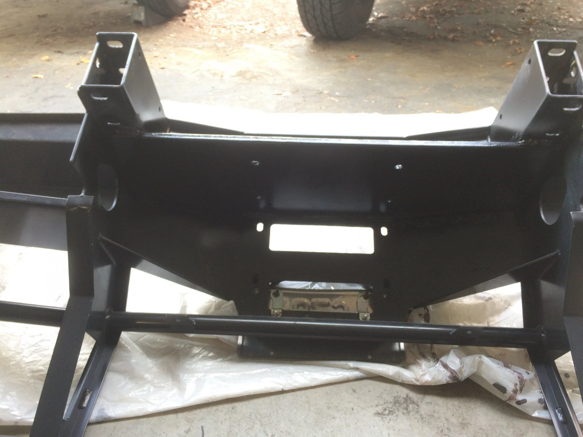

I got a 1/2" steel plate (29" x 9.5") from the local metal supply shop and I cut off two corners to make it fit the profile of the bumper

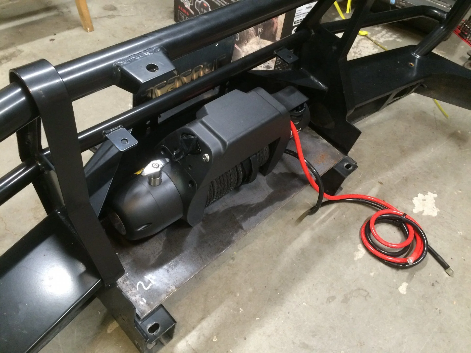

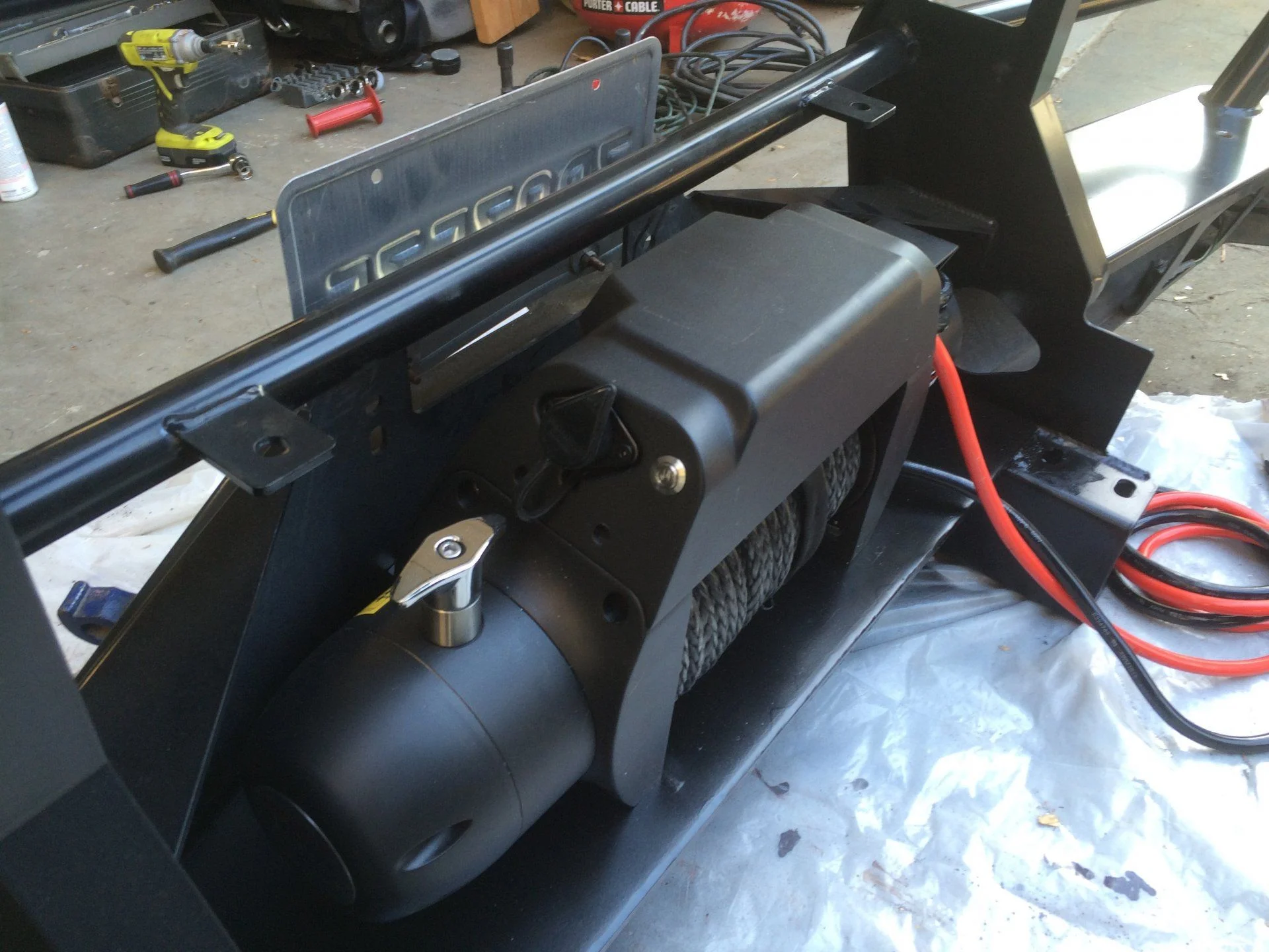

I then test fitted the winch to make sure everything would fit and thankfully it fit very nicely.

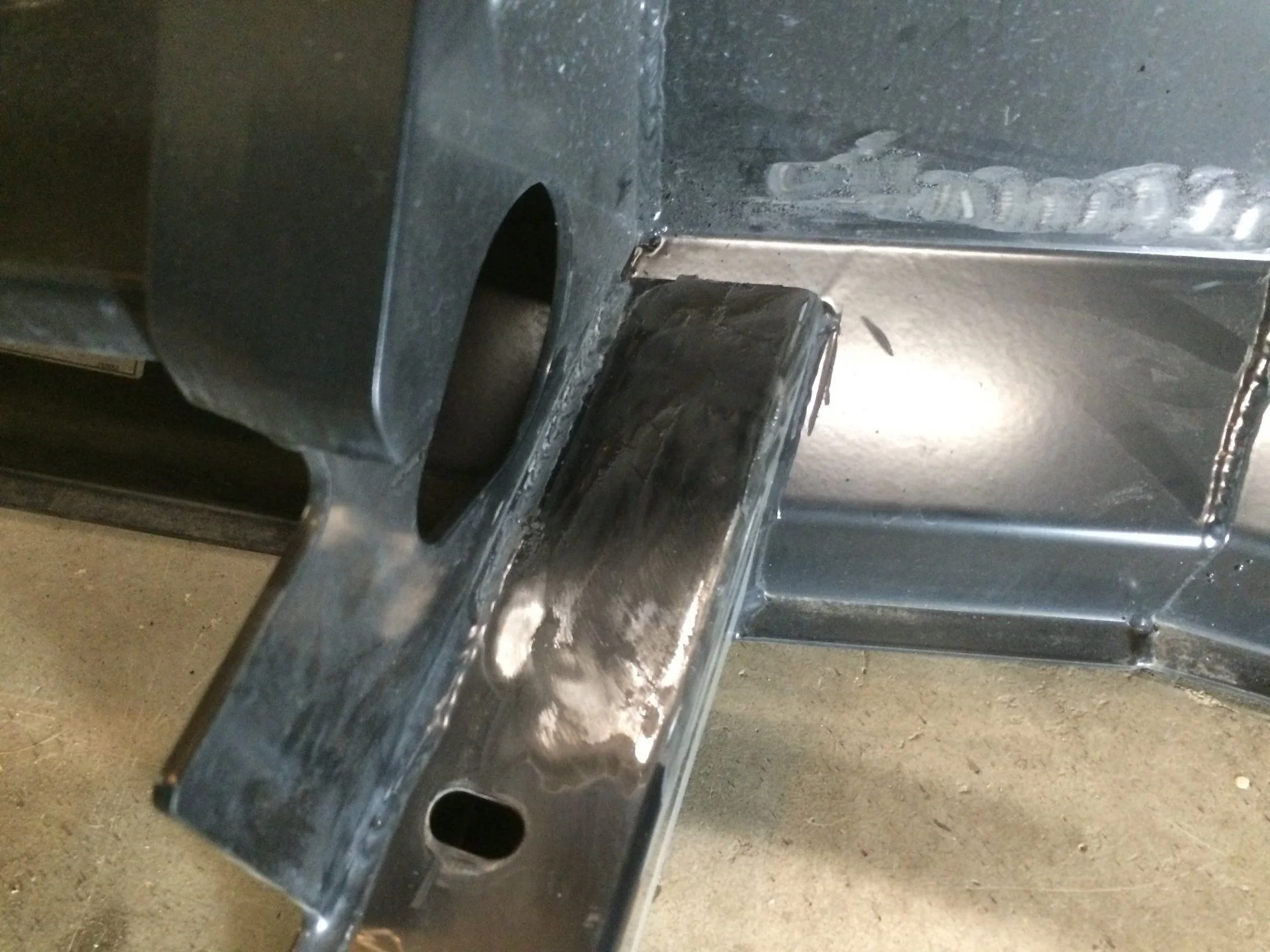

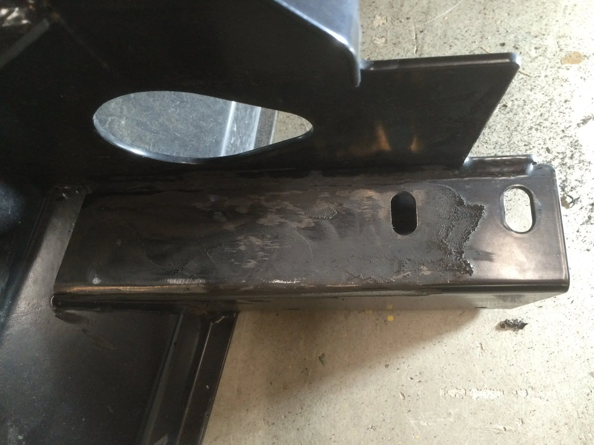

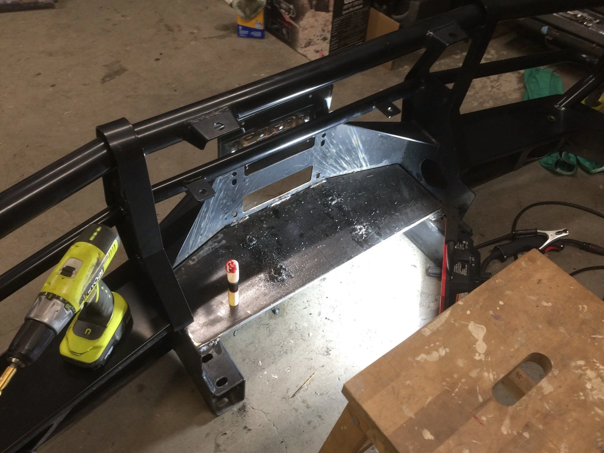

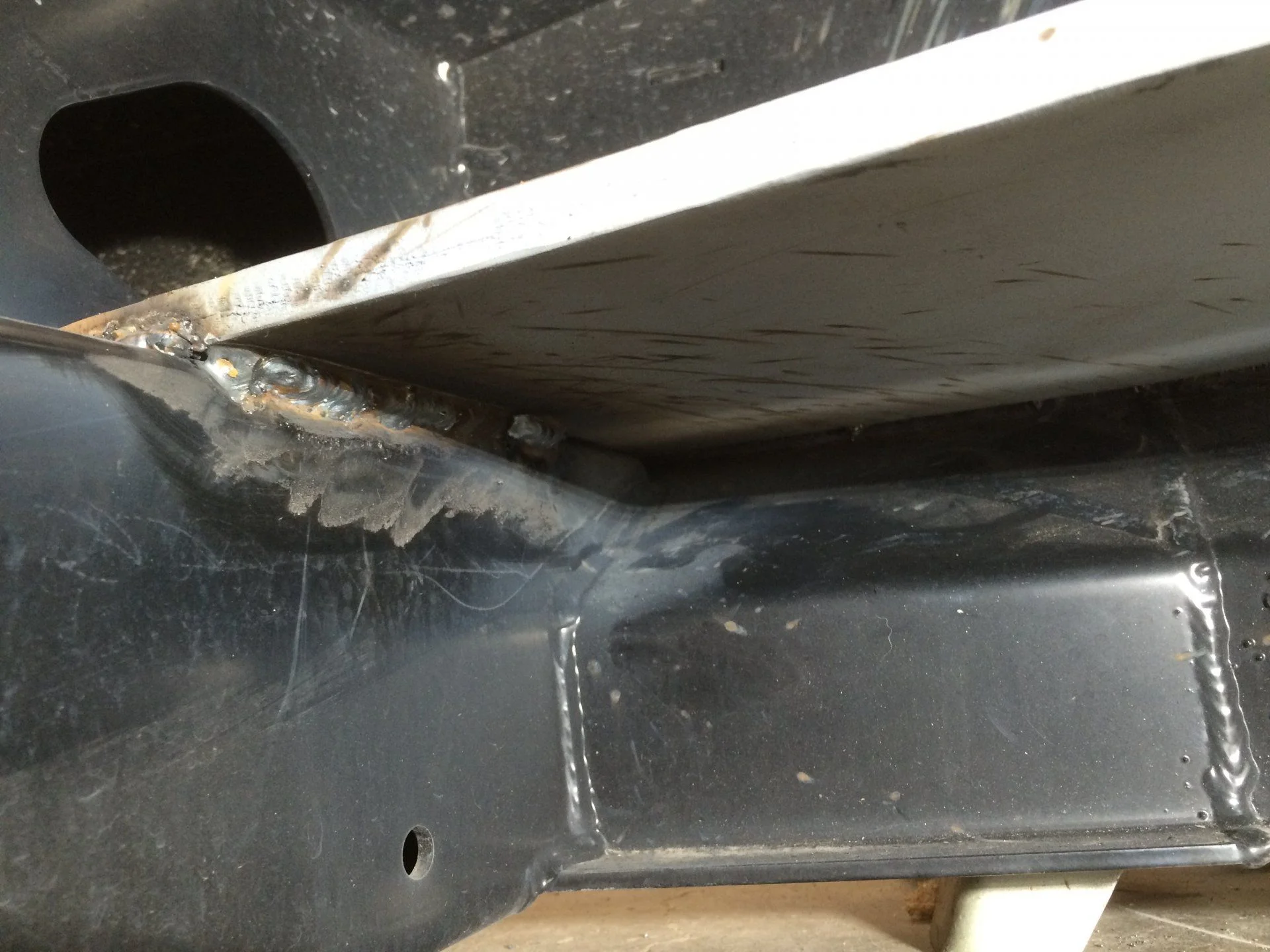

I then ground down the paint, or what ever it was, on the bumper to expose the metal to weld too.

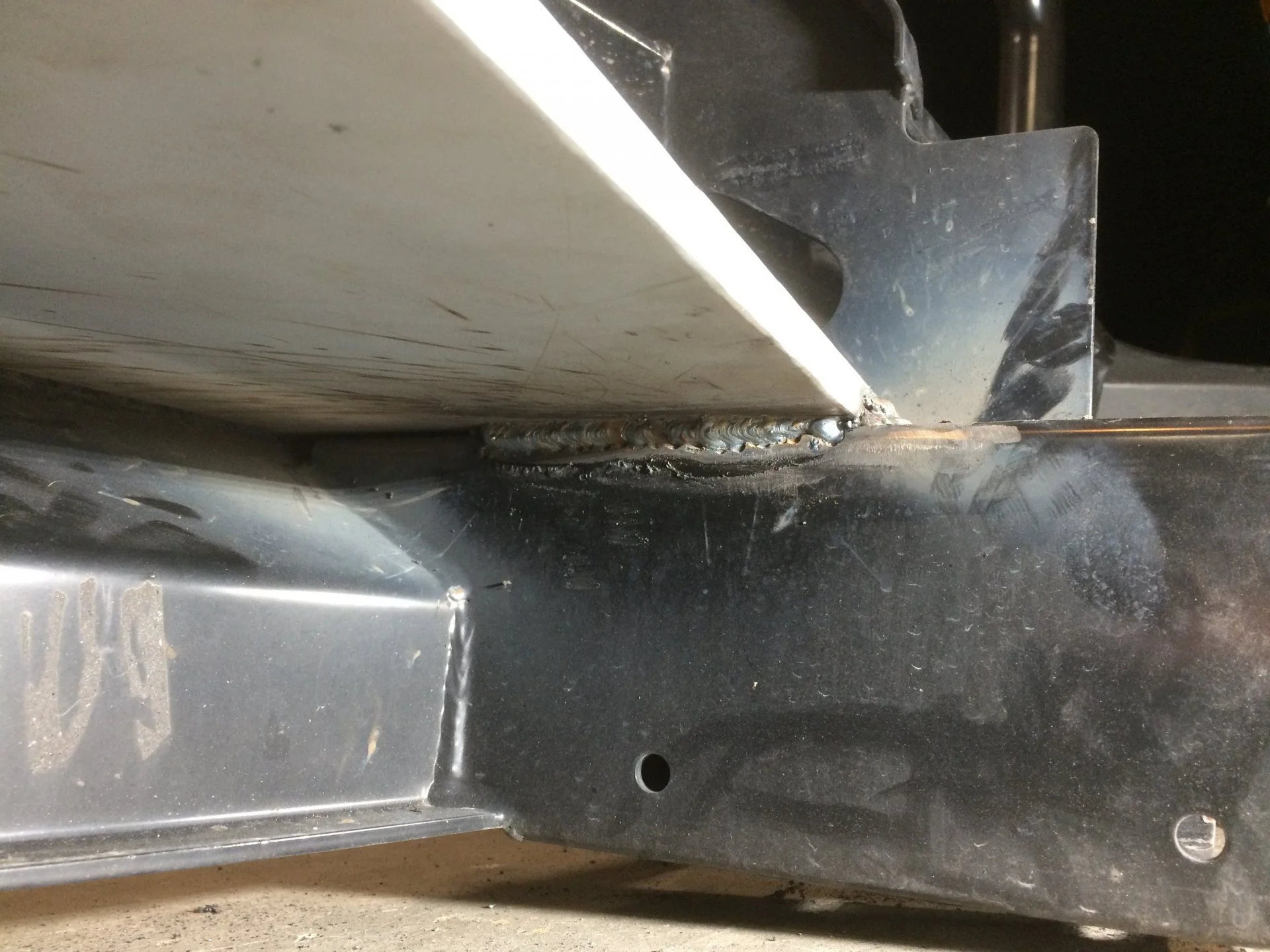

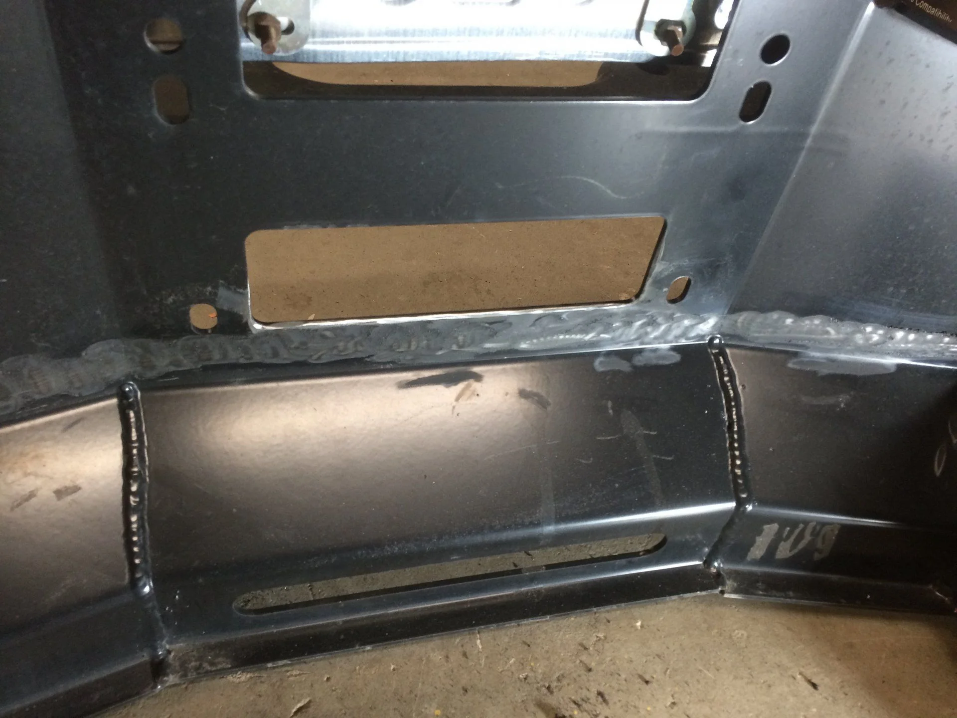

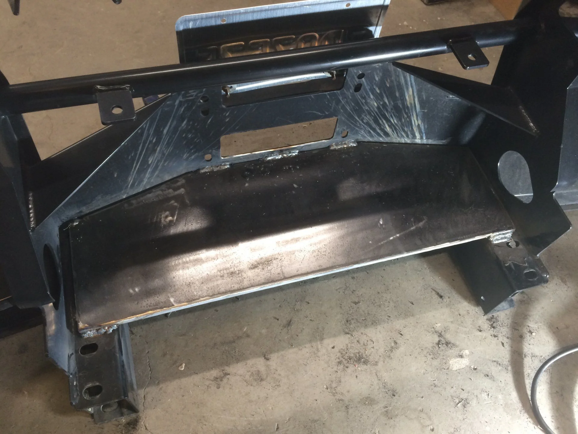

Then I welded the base plate in place.
I used the paper pattern ComeUp provided to locate the bolt pattern. I first put the winch on the plate and placed it where I wanted, I took note of where the back feet where so I could then locate the paper pattern to it. I then drilled four 1/2" holes. This was a lot of work, 1/2" metal is super thick and it took forever. I first tried to use my tired 1/2" drill bits but it was taking way too long, so I ran to the store and grabbed a uni-bit. First hole went like a breeze with that thing. On to the next hole then, @#$@, the thing snapped. 15 min after getting home from the store with the new bit I was going back to get a replacement. Fortunately Lowes exchanged it for me, those things are freakin expensive. This time I was more careful and I was able to finish the holes.
I primed and painted the new base plate.
I tossed the winch onto the bumper, located the holes and wouldn't you know the bolts ComeUp provides were too short. Back to the store I go. I found out the bolts I have were M10x1.5 30mm long. 40mm would be perfect. I grabbed the last four 40mm they had in their bin. I ran home started threading the bolts and DANG IT!! They were not threading!! I got the wrong friggen bolts. I grabbed M10x1.25 not M10x1.5! Argh! Back I go to the store and grabbed the right bolts, this time I triple checked that I got the right ones. Four times going to the store in the middle of a project is just too many times. Thankfully this time the bolts fit.

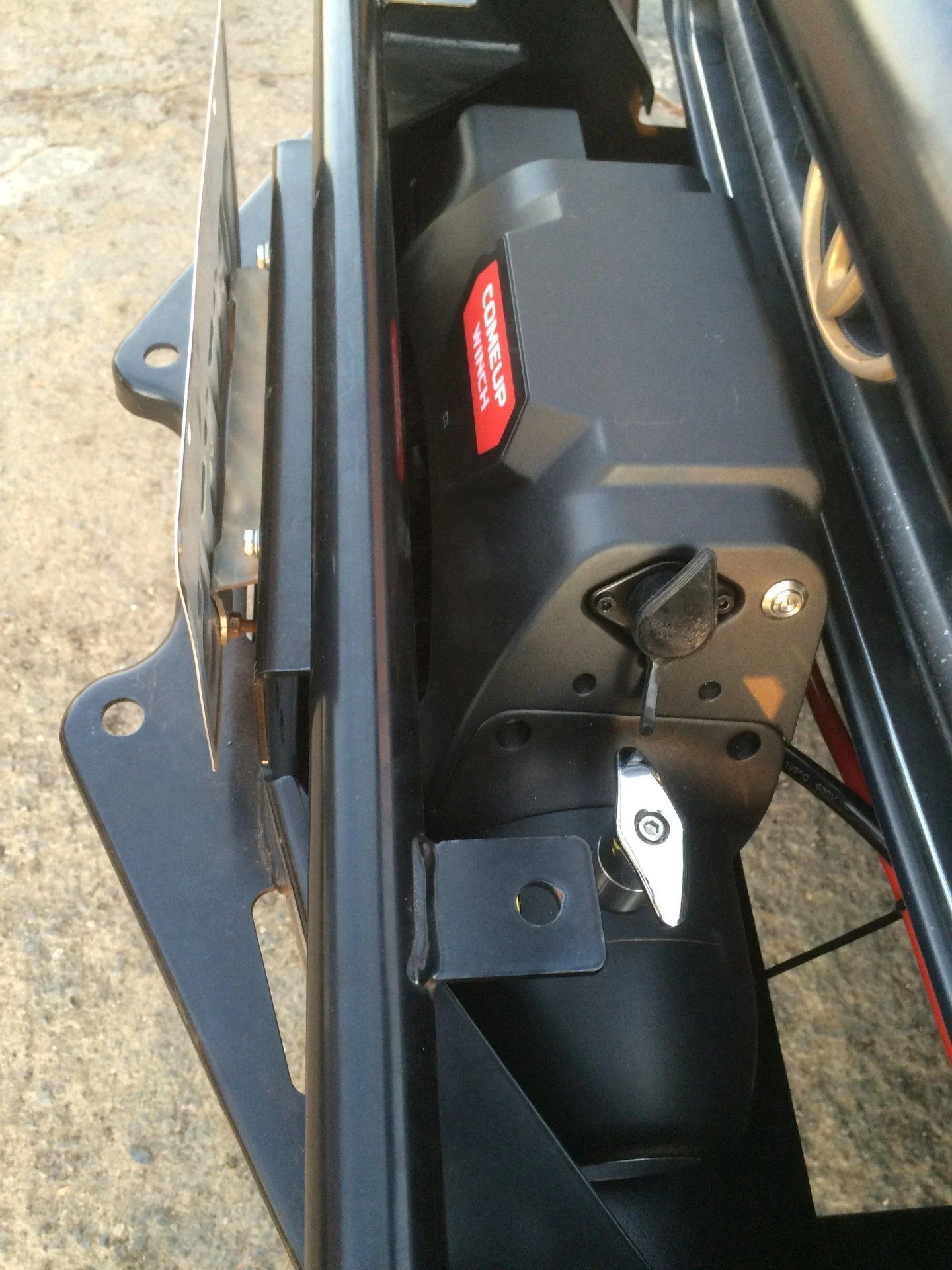

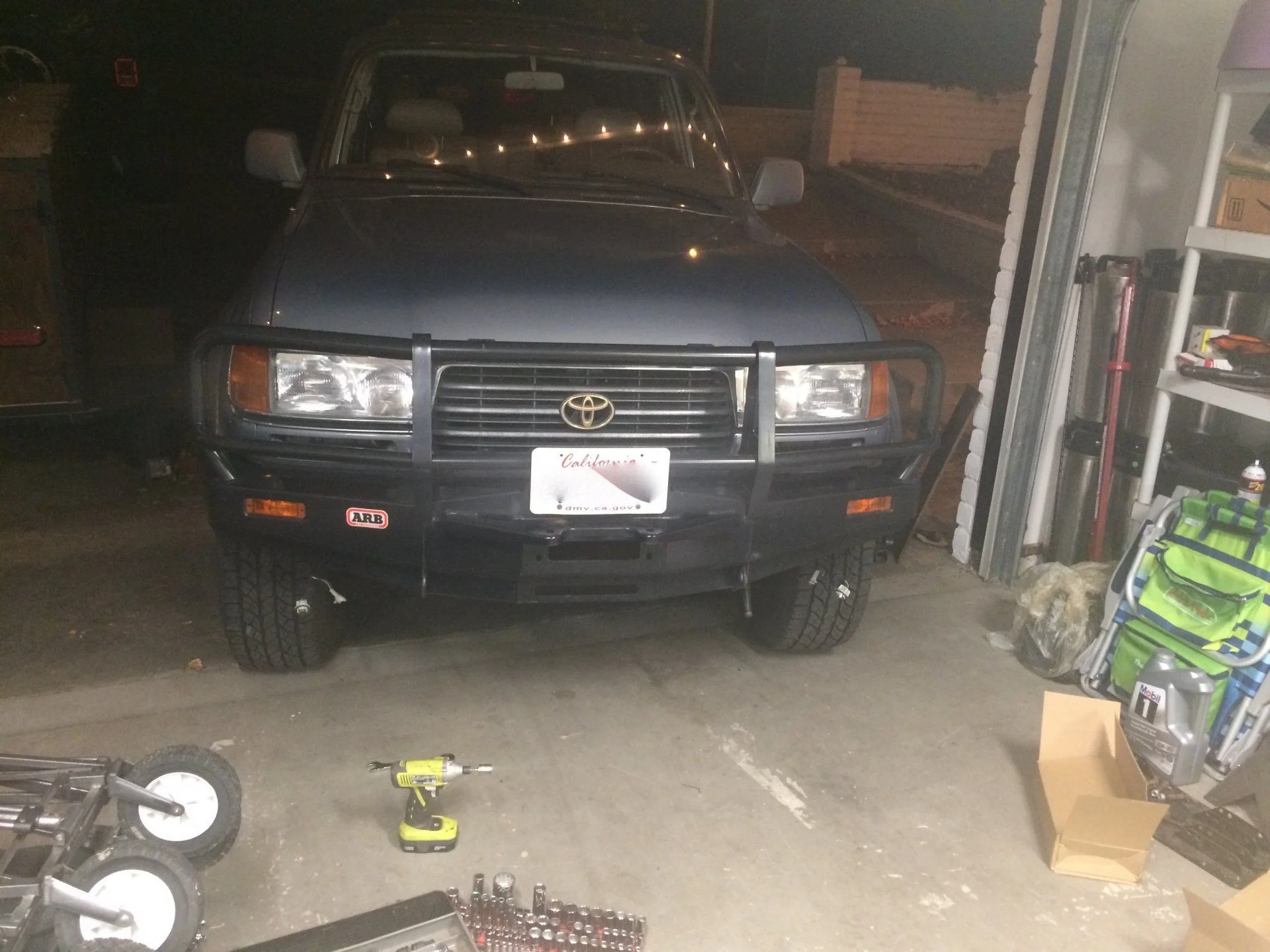

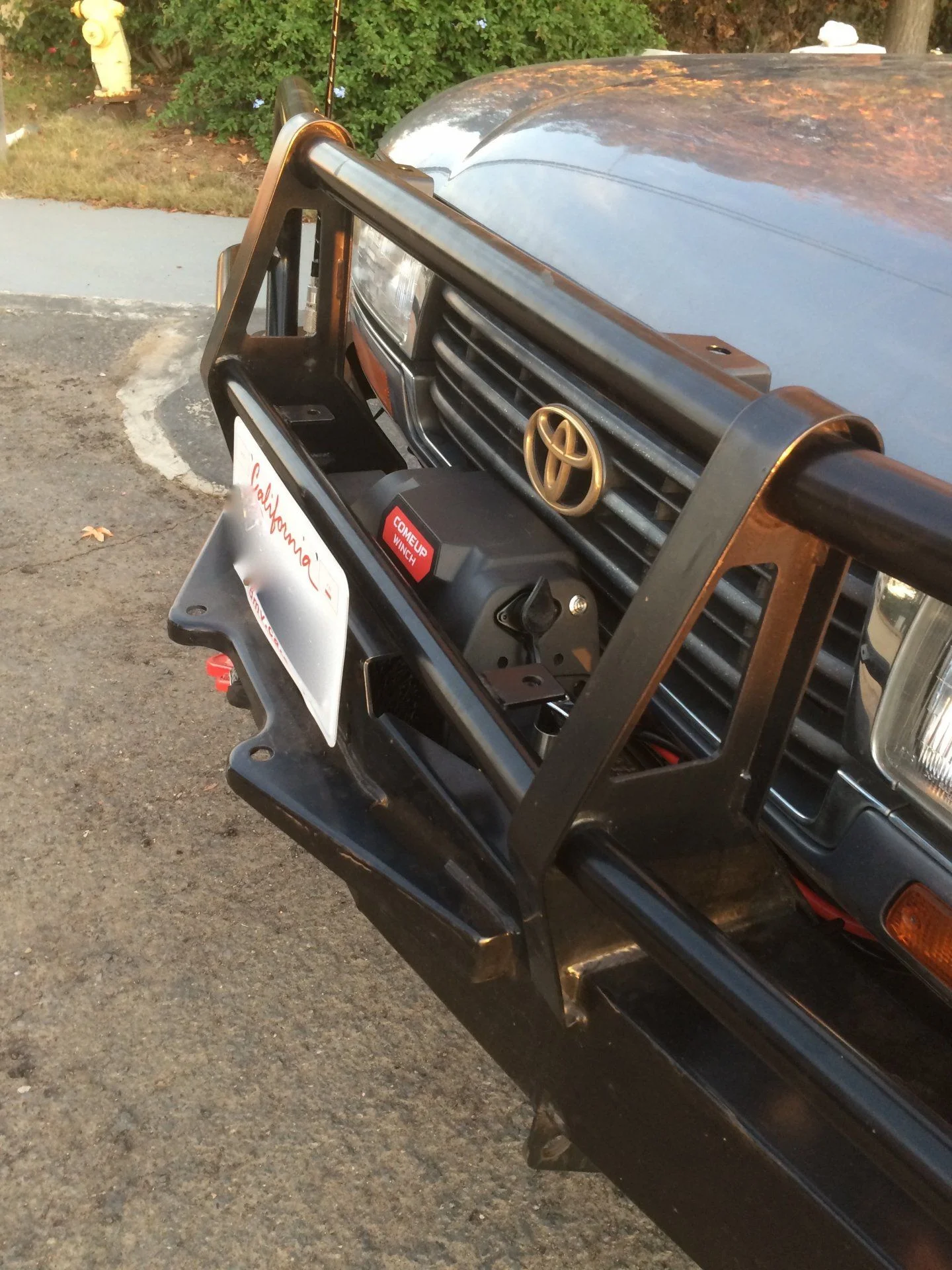

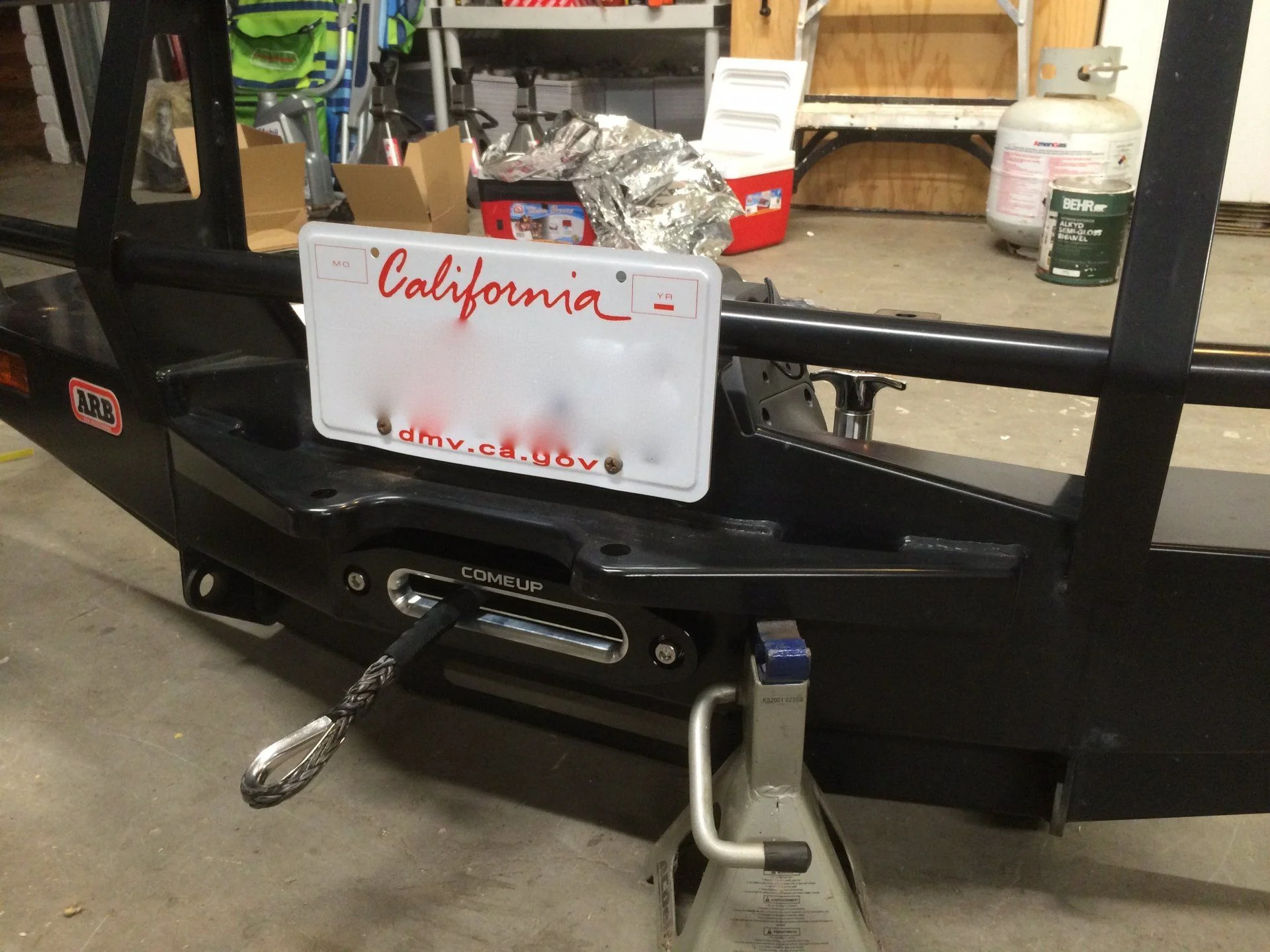

I had a friend come over, lifted the bumper back on to the cruiser, bolted and wired everything up and I almost cried it was so beautiful. It fit so nicely and it looks so clean and there was plenty of room to spare. Also it was not blocking the radiator much, which is something I was a little worried about.
So yes you can install a winch with an integrated solenoid onto the ARB bumper. It takes some elbow grease but it can be done, at least with a ComeUp 9.5RSI. If you are gonna try this, make sure you have the clearance. And for cryin out loud do your due diligence and research the living crap out of something before you pull any triggers.
