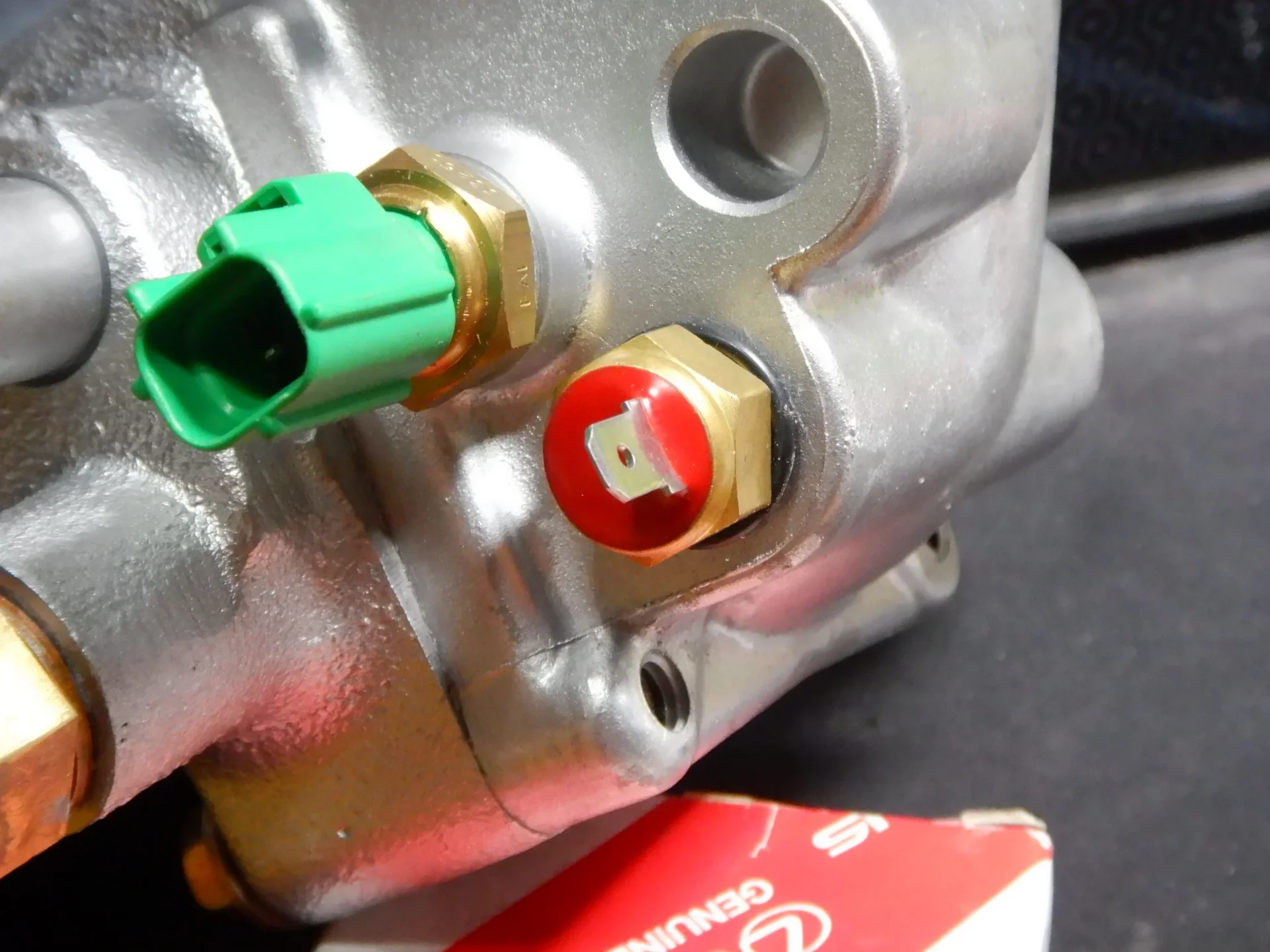

I ended up needing to replace both sensors in the thermostat housing. The PO had used a non-oem water temp sensor that failed early and likely was the wrong part to begin with. It didn't reach as far into the housing as the OEM one does.

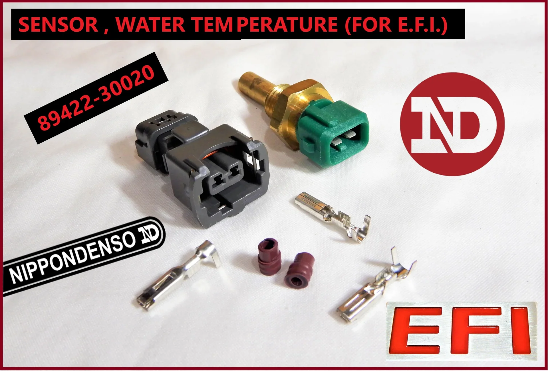

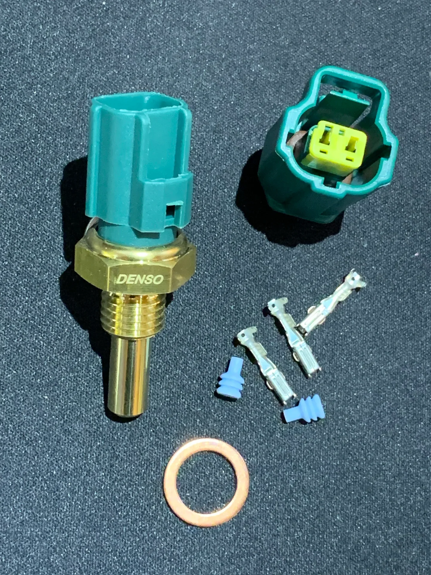

I accidentally linked similar parts twice, There's also this water temp sender:
NOS OEM GENUINE NipponDenso / DENSO 3FE PLUG and PLAY Repair KIT OE Sensor, sender Water Temperature (For E.F.I.) 89422-30020 Fits 85 - 7/88 FJ62 USA & Canada Spec. & 3B, 3FE; 3B, 3FE; BJ70LV-MNK, BJ70LV - VintageTEqParts.com - https://vintageteqparts.com/collections/everything-else-hardware-fsms-shop-manuals-special-teq-stuff/products/copy-of-oem-genuine-nippondenso-denso-3fe-plug-and-play-repair-kit-oe-sensor-sender-water-temperature-for-e-f-i-89422-20010-fits-88-92-fj62-fj80-usa-canada-spec

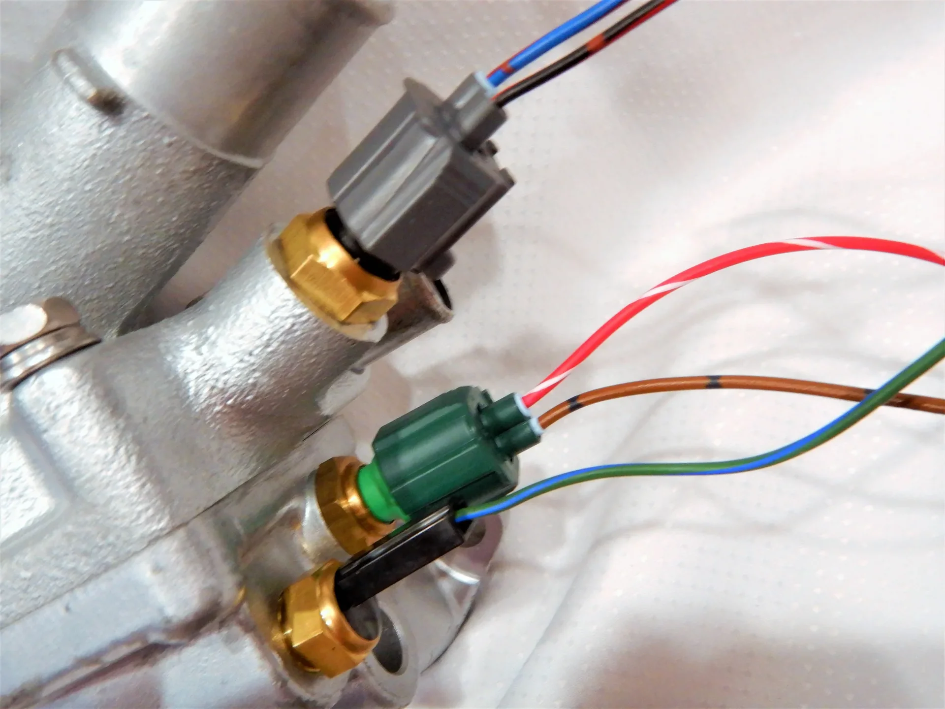

So it's two plugs,the black one and the green one.
I’ve already ordered the first one but I screwed up and order two of the same units! I’ve tried to reach out to the company through email, but there is no answer and obviously nobody answers the phone anymore. Thank you for your help. I hope this works. I’m going crazy with this damn thing.

i have BOTH the early and late Green Plug OEM DENSO JAPAN sensor options now .....
NO more being force fed the later one if you have a early 62 ....
