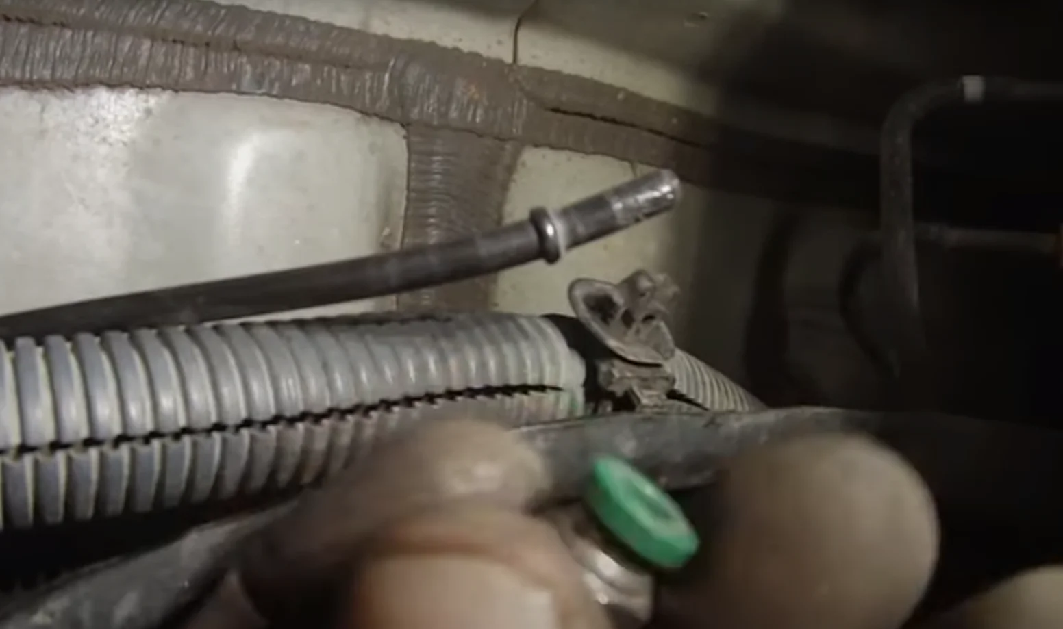

I haven't removed it yet, but the videos show a lip on the existing line that snaps in place with the stock connector. It also has a rounded end. Arnott connector looks like it needs a clean cut tube and I'm thinking that ridge will prevent it from pushing in all the way.

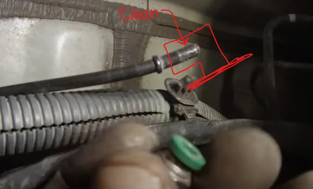

The fitting should be clean but only about 3/4" goes into the sharkbite fitting on the arrnott bag.
Ahhh! Thanks for clarifying. I would have cut it shorter. Mine will be a new line. The mechanic chopped the old one and inserted a smaller piece of tube to splice it so I could drive home.
