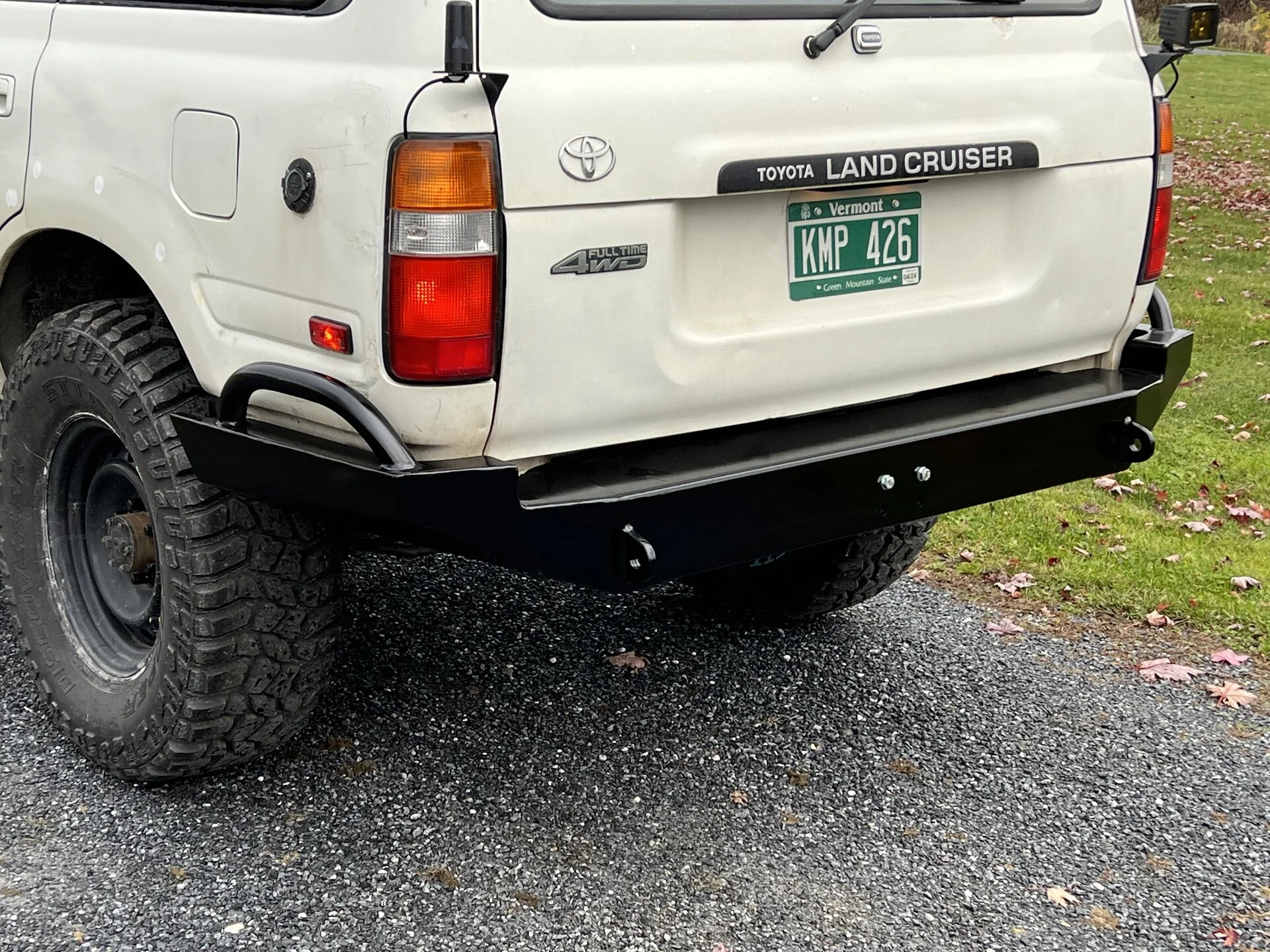

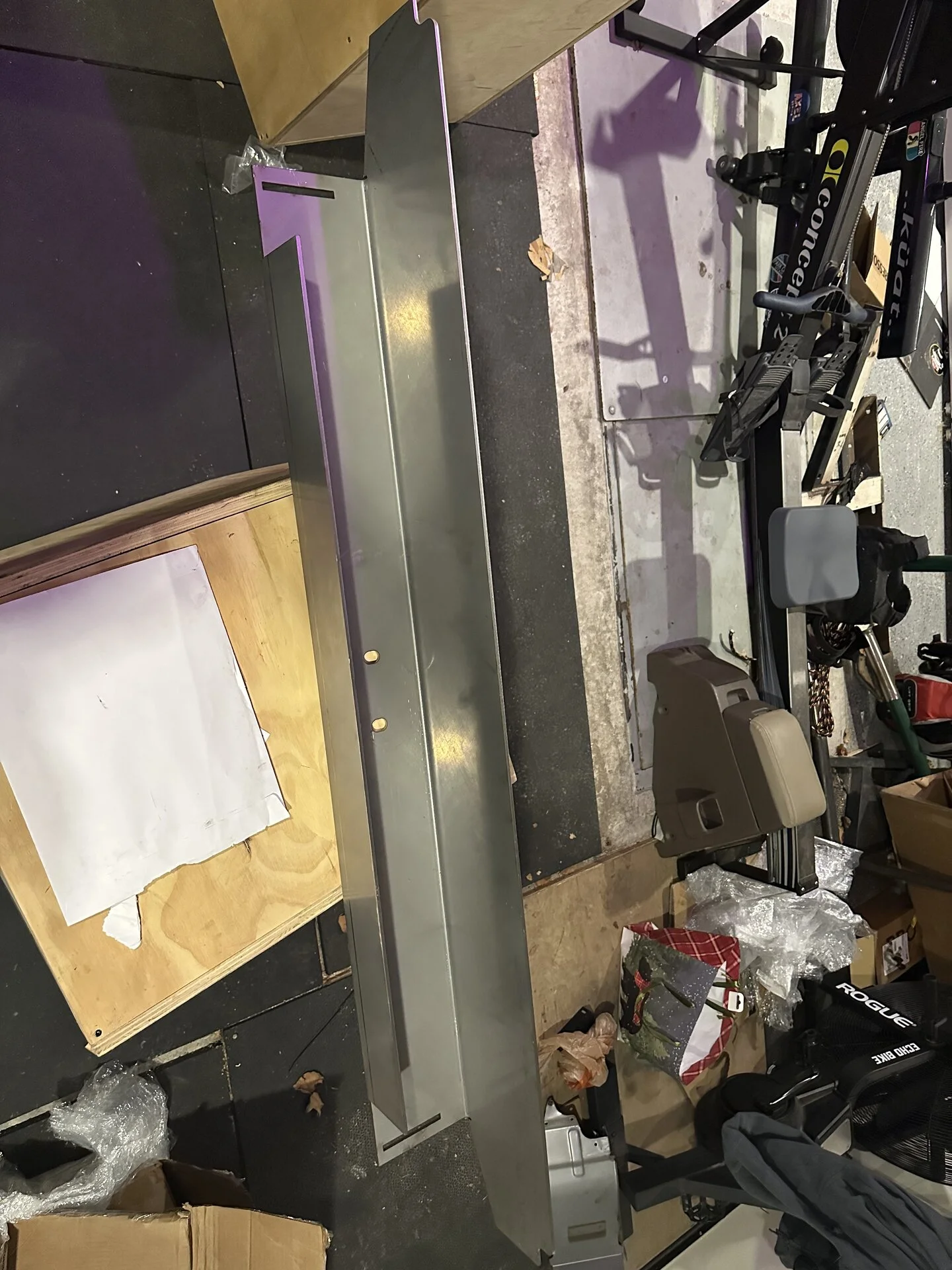

I ordered a front and rear bumper from coastal off-road and a couple pieces of the rear bumper don’t match the picture of the inventory. I’ve watched a couple videos and they also don’t match. So I’m wondering if they changed their design of I got the wrong kit. I emailed coastal off-road but haven’t heard a reply yet. The parts are numbers 2,5, and 6.
Yes, they changed it, yes they now form a single wrapped piece instead of three plates that need to be welded together. The company confirmed this when I asked the same question.
The bent piece is a better design that makes proper assembly without jigs more accurate. That piece is the foundation of the assembly.
It is a terrific bumper.
The bent piece is a better design that makes accurate assembly without jigs more accurate. That piece is the foundation of the assembly.

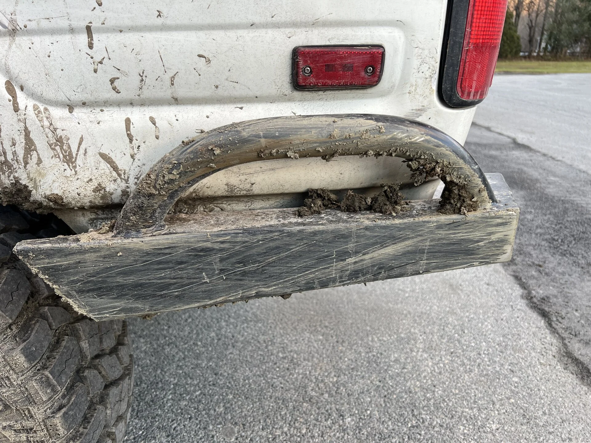

Welcome. I put mine together in the fall.It was a fun project.
It will hold the weight of the vehicle. This was after riding at a ~40 degree angle on the sliders and bumper in a deep rut.
