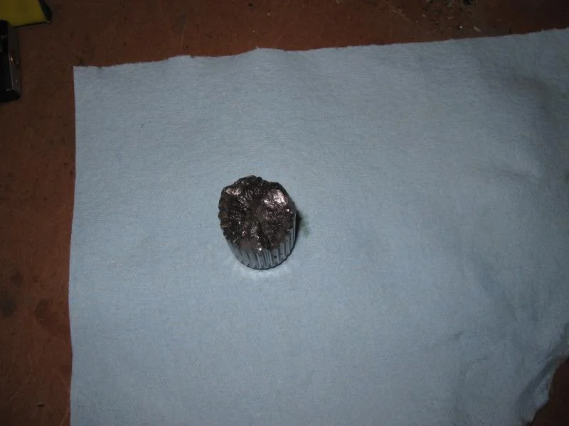

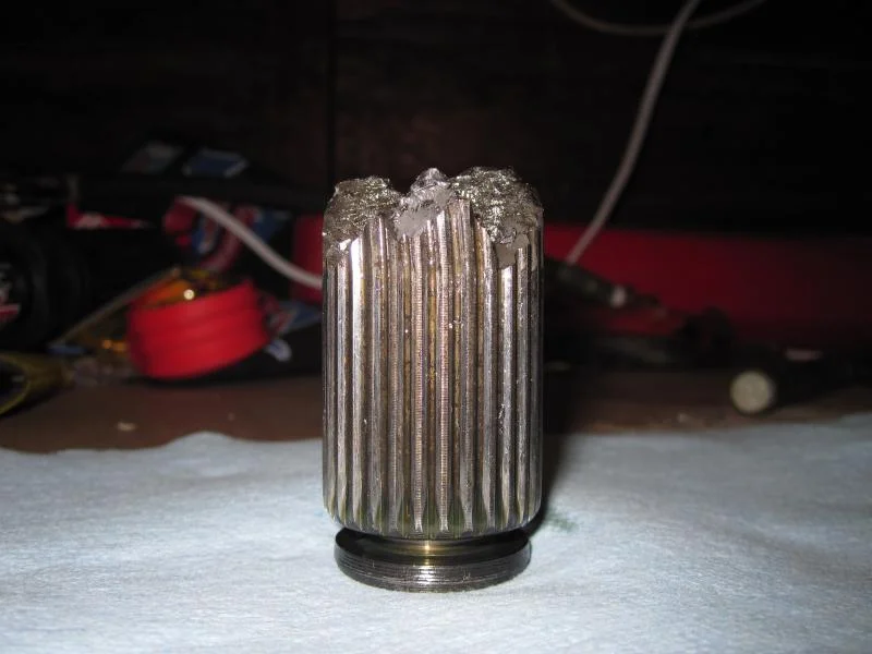

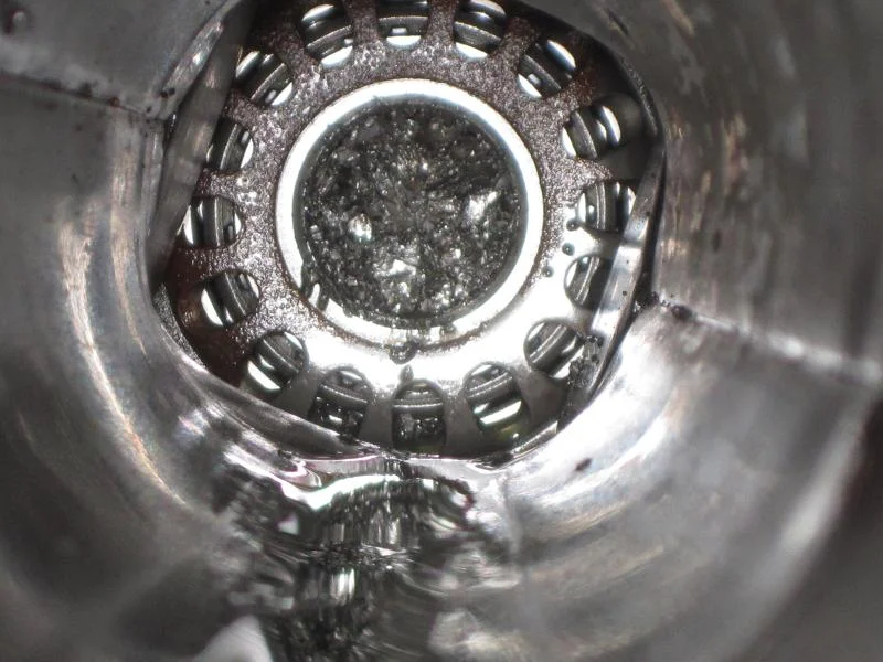

stub snapped off, interesting.
heavy foot?
big tires?
locked?
tetestrone? (sp?)
heavy foot?
big tires?
locked?
tetestrone? (sp?)
I don't flog the truck, 36" Iroks, ARB. This one broke the same as my other. The splines were twisted and the stress cracks finally decided to let go in the driveway. That axle is my original 79 and has 10 years of wheeling trips on it.
You've just got bad luck with rear axles John.
Yes I have. After I install another axle today I am down to my last spare.
john you really need to drive that truck, looks like some serious rust on the top of those pics!
That is just surface rust on the adjuster, it looks bad in the picture but the rest of the diff is rust free. But you are right that I could drive the truck more often.

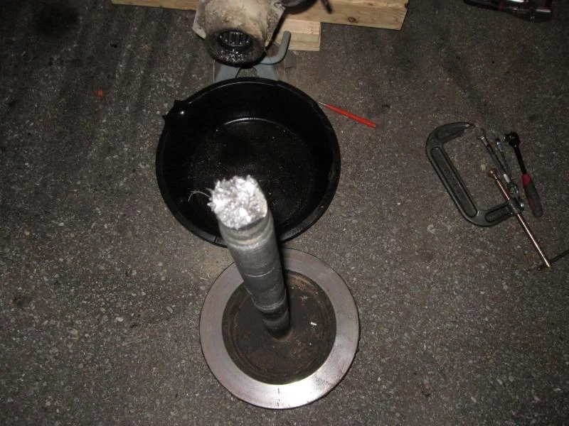

Here are some pictures of the stub. Back out to the driveway to install my spare.
