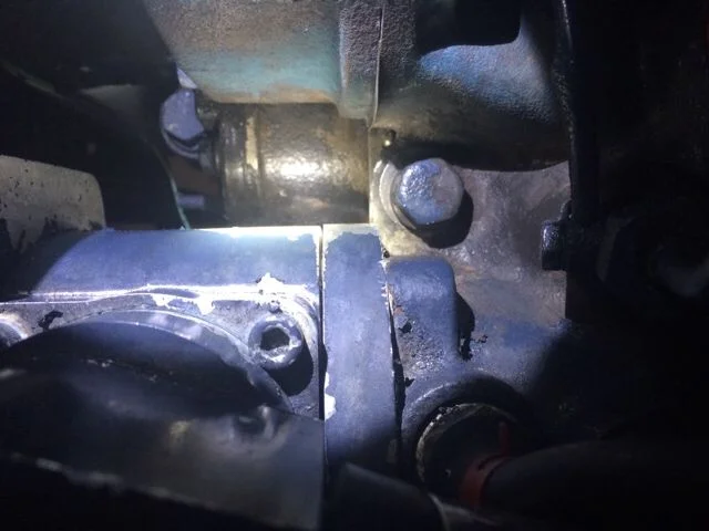

I was just going to ask you the same question. Mine loosened up and is leaking coolant. Is the bolt that tightens it down behind the A/C compressor?
Well I guess I did get some instructions for the ac and alternator bracket stuff. No torq specs but it did suggest lock-tight on everything.
Does your bracket only have the 8mm socket head bolt holding the water neck to the thermostat housing? Tried tighten it down thinking it came loose but it's tight. I know the bracket has a few design changes. Wondering if mine is a bit different.
Thanks for the photos. That's the same version I have. Maybe my gasket failed but I don't like the way it isn't sitting flush on both sides. Hopefully the bracket didn't warp from holding it in
did you leave the lifting point in there? I wonder if it makes a better seal without in.
That's the first thing I noticed and thought the same thing. Mine is not in there. How thick is it? Seems like it would be to thick and pull the bracket out.
