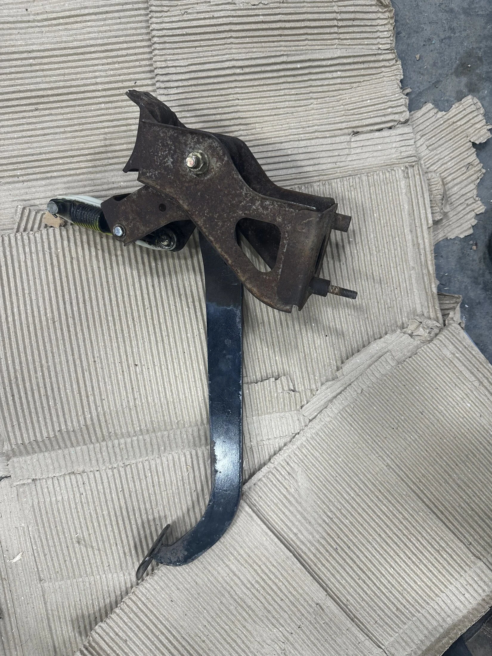

Factory clutch pedals can be found on ebay sometimes.
I put in the euro market LHD 80 series clutch pedal and smaller brake pedal with the matching 80 series master cylinder.
I beleive the brake pedal is not longer available new, others have had to cut, bend and weld their stop brake pedal to solve that issue.
Depending on the size of your slave cylinder you may end up needing to use a different master to keep the master/slave matched...if so, you can fairly easily make mounting plate to attach a master to the clutch bucket.
