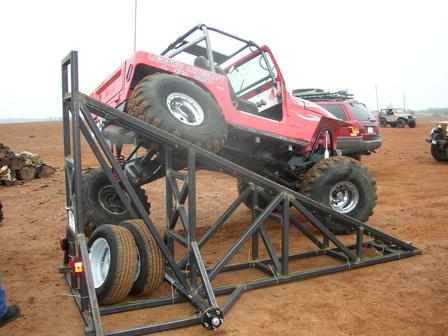

Hey Everyone! We're investigating the idea of building a RTI ramp with club funds to have at at our events! We wanted to put this post out there to see if there was much interest in building one.
An RTI, or Ramp Travel Index, ramp is a device that is used to quantify the amount of articulation that a vehicle has, under controlled circumstances. It can be used to measure total wheel travel, check for areas of improvement in your suspension, check for binding points, measure for shocks. Finally, you can calculate your RTI score and it becomes a competition of sorts :grinpimp:

If there is sufficient interest, then a ramp will be built to spec by members of the club and will need to be brought to and from events, as well as stored in-between events. I have no problem storing it at my house, but it would be ideal to find a location closer to the center of the state to store it.
The result would be something close to this (except with land crusiers on it):
http://www.jeepforum.com/forum/f37/building-rti-ramp-53469/

Have any pics of the old club RTI ramp? I was unaware that there used to be one.
Yeah, it was pretty funny. I think I have a pic floating around somewhere. @southerncruiser62 put it together from some scrap at work IIRC with some help from others. Let's just say we didn't put a whole lot of time into it, but it was fun while it lasted. I think it wound up back at the scrapyard at TR Vernel - Greg can confirm. At any rate, we always talked about improving it or scrapping altogether and starting over. We have the funds and the know how to do it right now.

Some pics of ONSC RTI Ramp 1.0 from the earlier thread:
For those thinking about safety concerns with using a device like this, RTI ramp runs stop when a tire lifts off the ground. This is because the measurements used to calculate your RTI score are taken with all four tires on the ground, which is well before the vehicle tips over. As such, RTI ramp runs are done with selectable lockers set to OFF, or if you have auto-lockers, you stop as soon as a tire barely comes off the ground.
A spotter will ALWAYS be used to ensure that the ramp is used in a safe manner.
there were a bunch more.pics on the old website but . They must have been lost when it was taken down. I cant seem to find any of mine from that day.
