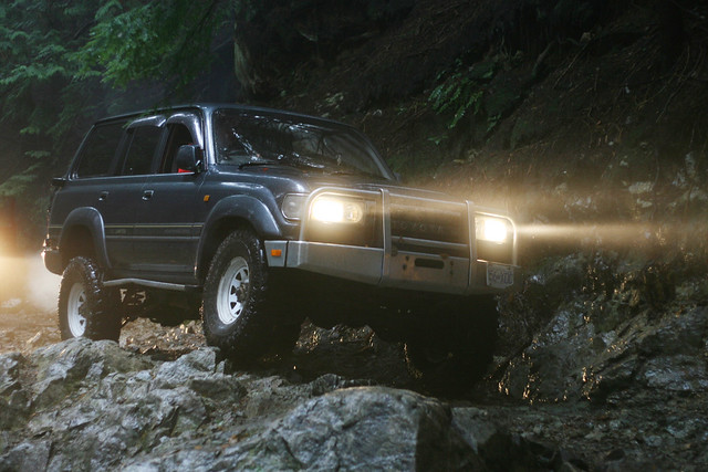

Ta da?
Never noticed this thread 'til now.
1991 HDJ81, Auto
3XLocked, Aisin Winch, Dealer installed Alum. Roo Bar
3-4" Lift, not sure of the make, with adjustable control arms
315-75-16 Yokohama Geolander AT and 35x10.5x16 Super Swamper Rad TSL's
Stock Exhaust to muffler, 3" the rest of the way
3 in 1 GlowShift Gauges (Boost, EGT, Tran.Temp.)
Ipad (GPS) on Ram Mount
Kenwood TM-281 VHF
300W Inverter
Continually evolving rear drawer/sleeper system
To Come: sliders, rear bumper, full 3" exhaust, fuel rod tune, compressor (?), Fridge (?), third battery (?)
Photo credit: NateCher
